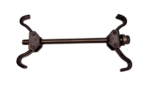

OKAY what internal spring compressor do you recommend?? none we've tried seem to work....
Here’s my one Chas , it’s perfect for our A arm front ends
Sorry I should have taken pics when I fitted the springs in my 63 the other weekend
Thanks so much! Who sells these?
You can get a spring compressor tool at most tool supply companies like Harbor Frieght, auto parts stores like Auto Zone, NAPA, or O’Reilly’s. Performance catalogs like Jegs or Summit Racing carry them too. Some home improvement stores like Home Depot and Lowe’s may also carry them since they have tool sections.
