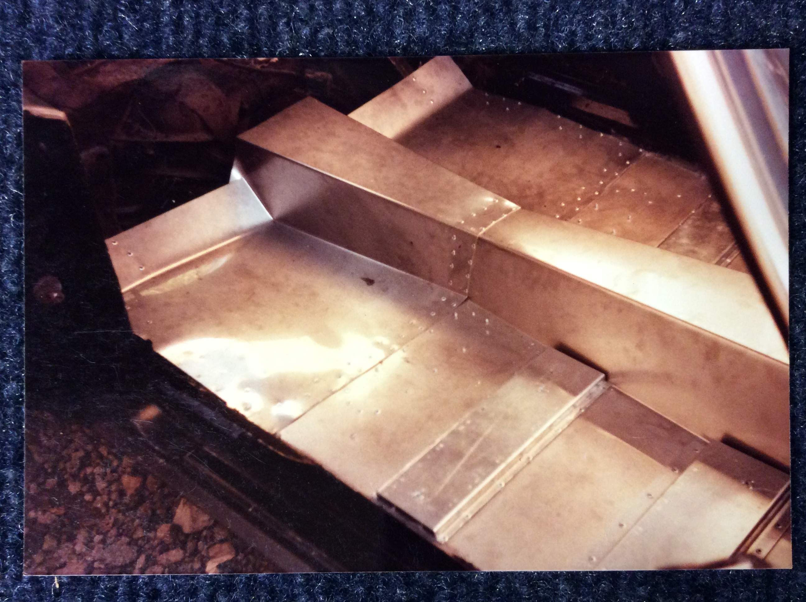

What Frosty said! I did this to my "69" Z/28 after I put the full frame & stainless steel floor pan in. I wanted the seat a little higher. So I took 3" diameter nylon & cut 1" thick pucks drilled a through hole for the bolt & raised the two front buckets. The nylon provides a less harsh intermediary for both the seat bracket as well as the floor. In your case you might only want spacers for the back legs.
