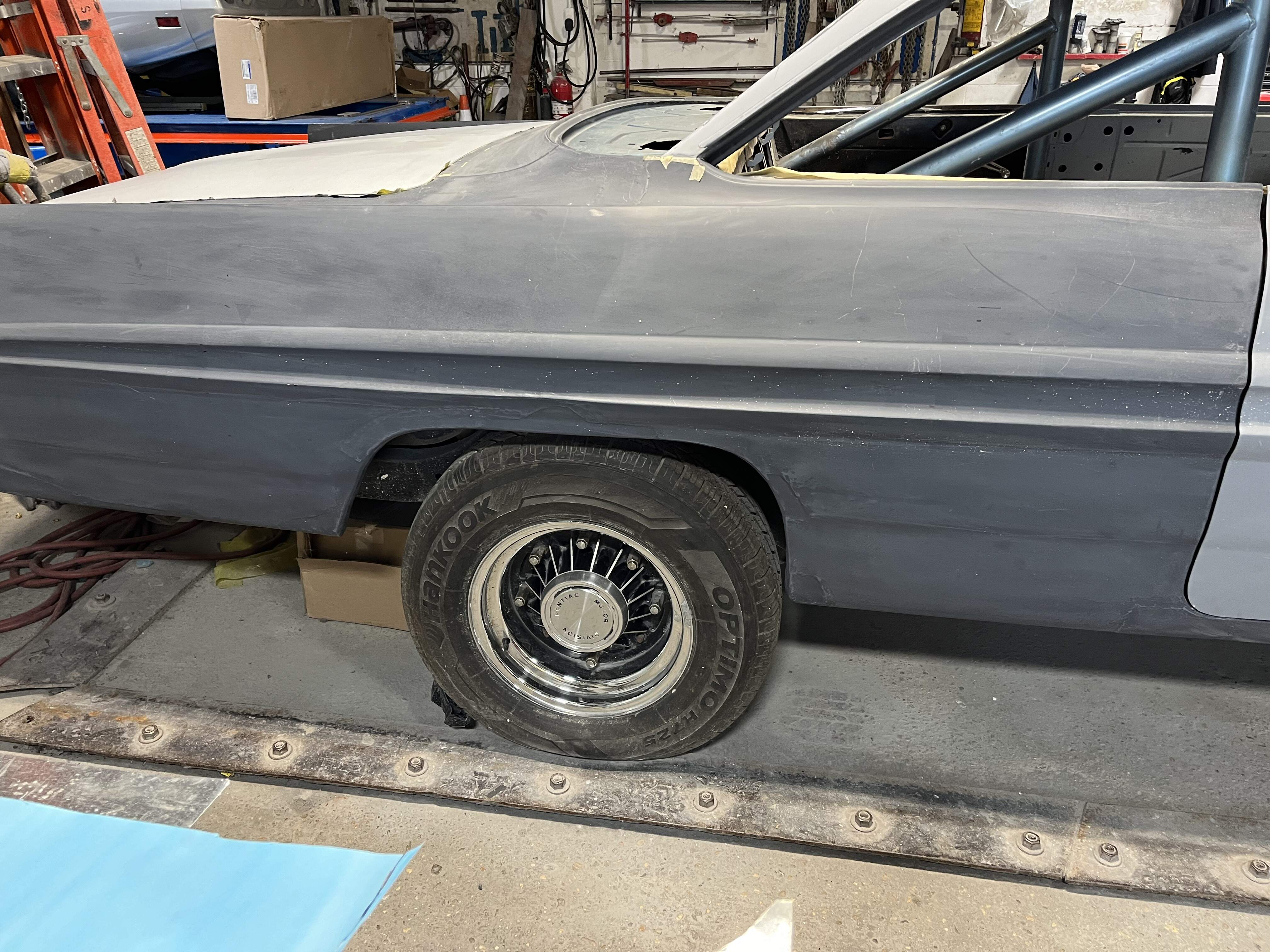

Hey there, i am looking for any kind of information on a 1962 Pontiac Catalina.. i am currently repairing a Rt side quarter panel, but i cant find a patch for it.
below youll find a picture of the Right side quarter panel. if anyone can find out any info on a patch or another Panel, please reply. thank you -Dom
I am not aware of any quarter panel reproduction sheet metal for your Catalina. Therefore you need to find a donor vehicle or a classic car junkyard for these things.
I would start with Frank's Pontiac Parts in 29 Palms California. They are an all Pontiac salvage yard, they MAY have what you need. They have a website too.
https://frankspontiacparts.com/
I would also try:
Desert Valley Auto Parts in Phoenix AZ
Turner's Wrecking Yard - Fresno CA
CTC Auto Ranch - Denton TX
I have a longer list of possible yards but I think this will help you get started.
Welcme to FP.  These are very popular cars here.  Many options for help.  Thankz for the pic's.  Hard to see in the pic but only looks like a couple spots in the front and rear of the wheel well.  One of the in house experts will be along soon. Good luck!
