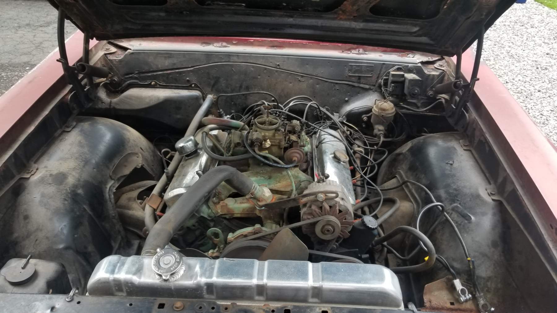

I just bought a 65" Tempest with the original 326, HEI distributor, Rochester 2brl, good solid straight car. Previous owner drove it occasionally until he said he changed the battery cables & starter. He said he crossed some wires & then it wouldn't start?
I got it home it had a weak spark & in need if plugs which i changed & gapped to .35-.40 & put in new coil. Theres much better spark now & carb is getting fuel! Initially i squirted some starting fluid in the carb but car just cranks & wont start. Doest even hiccup like it wants too. Got good spark, got fuel, im thinking timing?? Im very mechanically inclined & have built & worked on bikes (Choppers) my whole life.
Im trying to research, learn & understand timing, but its confusing. I can have it towed to a shop to a mechanic that specializes in classic cars but I want to learn & do it myself.

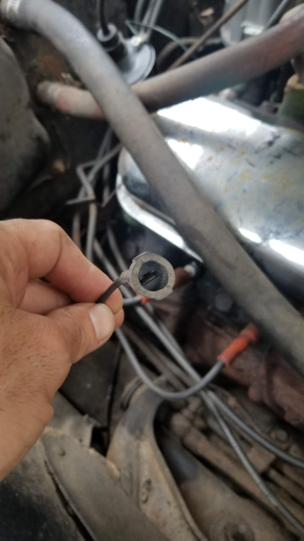

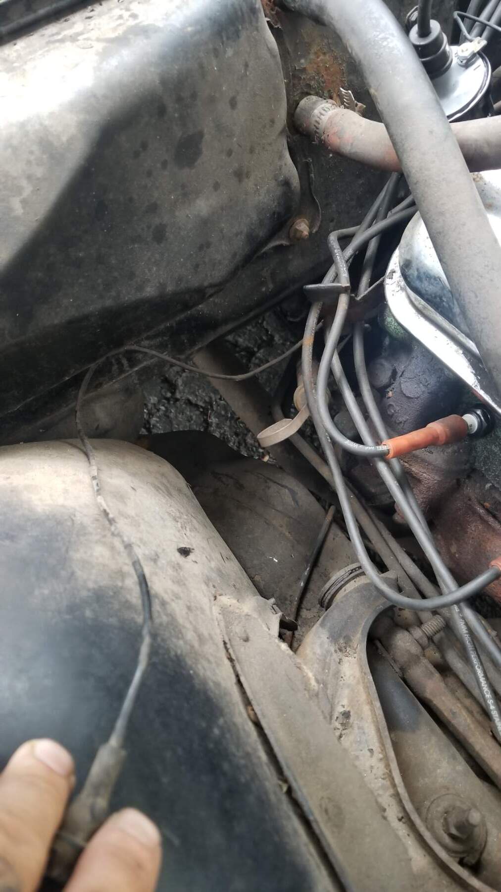

Im going to attach a photo of a wire i found loose against the fire wall, idk if it went to the ballast resistor prior to the HEI?? This wire is in a 3 wire harness, along with the ignition wire that goes to the coil, if this helps?

Which side of the car is this loose wire? Driver side or passenger side?
Frosty the wire is on the passenger side.

The single wire you were holding with your left hand is either the heater motor lead which plugs in under the top passenger fender near the hood hinge.  Its tough to see but if you get your head down into the engine compartment and look up into the top area of the front fender and the firewall, you will see a lead post sticking out for the heater motor.  The 2nf thing it could be is the kickdown solenoid on the rear of the transmission passenger side above the cross-member.
