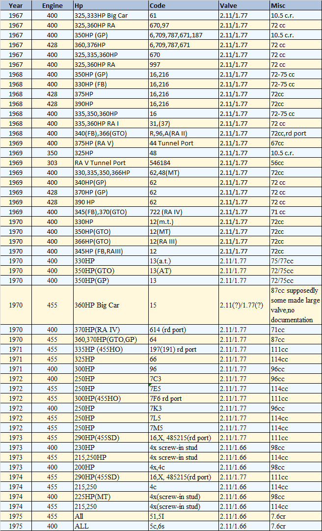

The nice thing about Pontiac engines is that the fact is they are so interchangeable. For heads, I recommend trying to find a head with 2.11 intake, 1.77 exhaust valves. These are the biggest factory valve heads Pontiac made. Add some port and polishing and these will do your 350 nicely. Those heads are listed below. You can find them online and at swap meets, you just have to pay attention to casting numbers. Forget about the RA V heads, they are super rare (and expensive). The other RA (Ram Air), HO, and Super Duty heads will also be expensive but you can find them but you have to be patient and your wallet has to cooperate. That said, all the other heads can usually be had for less money.
