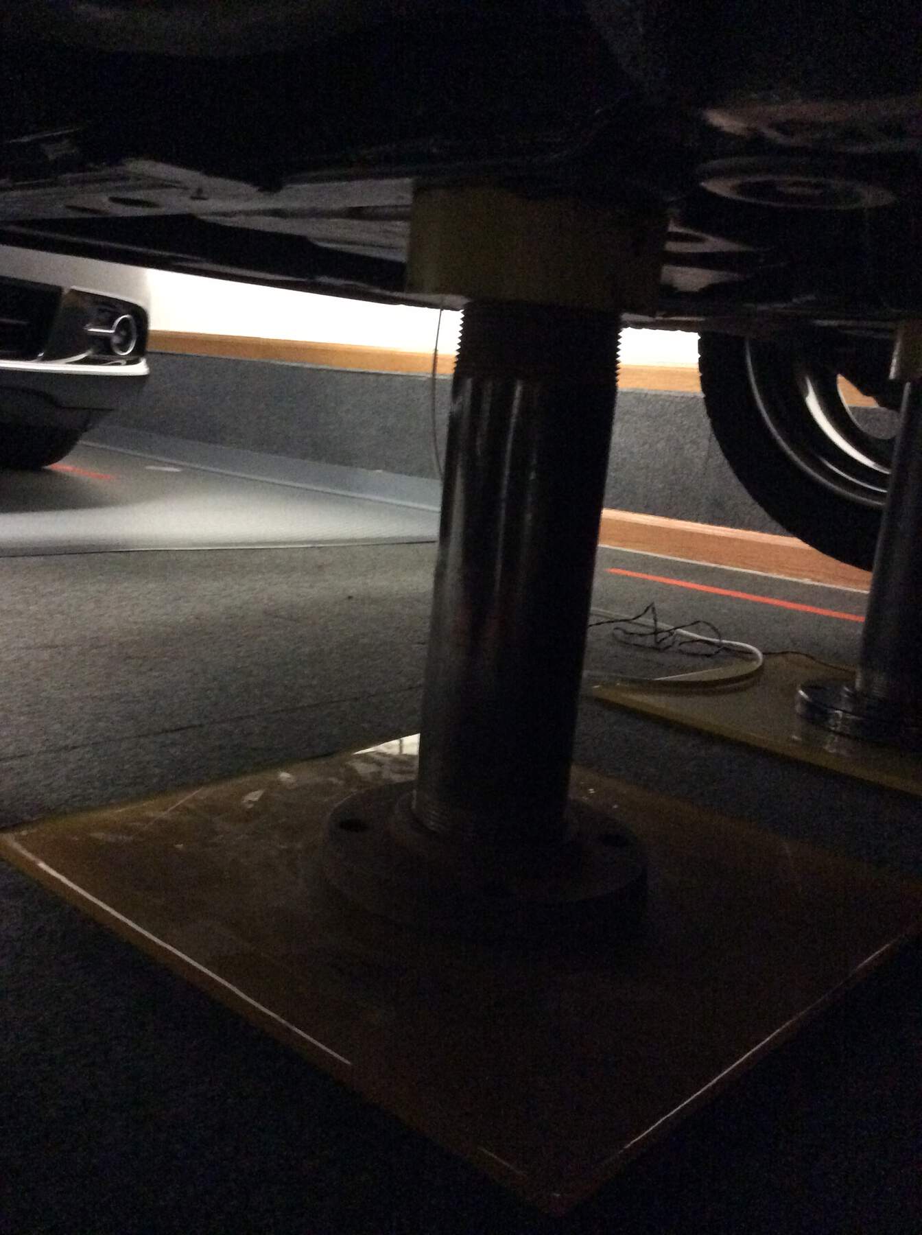

Those are excellent jack stands! More than sufficient for even a 4000 lb car like my Lacrosse’s. The only thing I get concerned about with all of those types of jack stands are the top footprint. It’s conducive if there is a channel to place in the V groove of the top part of the jack or a good flat portion of frame, which today most cars don’t have!
So I made my own many years age out of 3” pipe and pipe flanges! Very very stable & very strong! Still what you have is good!
So good to hear!!! Thanks bud!
