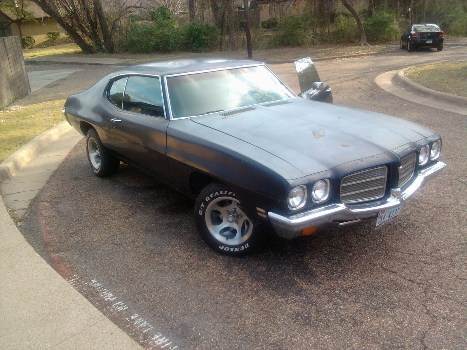

Standard Lemans front end

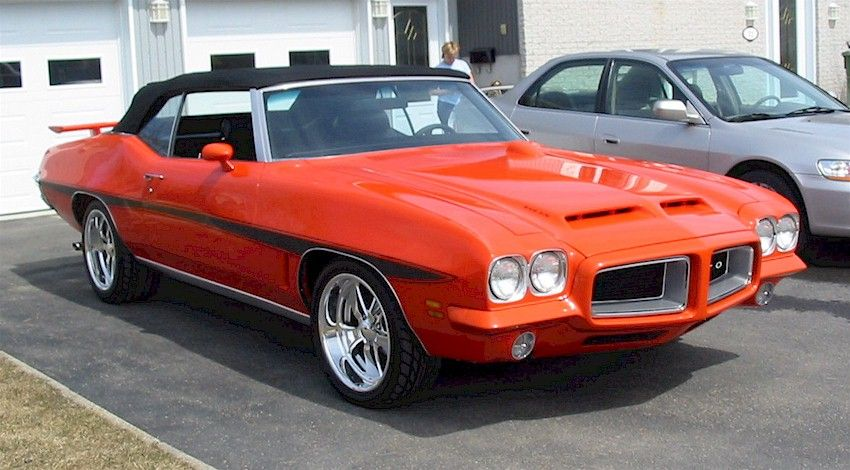

GTO Endura Front End
My is a standard, and the the core  support is rusted to beyond repair in the bottom were the the rubber bushing is .

That's what I suspected. You can purchase a new core support for a 71-72 GTO (essentially for the Endura clip). However, you will have to cut off the top flat portion of the new core support and transfer the old portion from your rusted one (I'm assuming for the moment that the top of your existing core support is still re-usable and has good metal).
The reason is the front fenders between the Endura fenders and stock fenders are not quite the same and the bolt holes are not in the same exact location. Indyman Joe and I have talked about this before (Joe owns a  near stock 72 Luxury Lemans with a stock front end while I own a '72 Lemans Sport convertible with the GTO Endura front end). If he sees this thread, I'll ask him to elaborate more as he was the one that pointed out the differences to me. The bolt holes at the bottom of the core support to the frame are identical between the Lemans, GTO, and GT-37.
