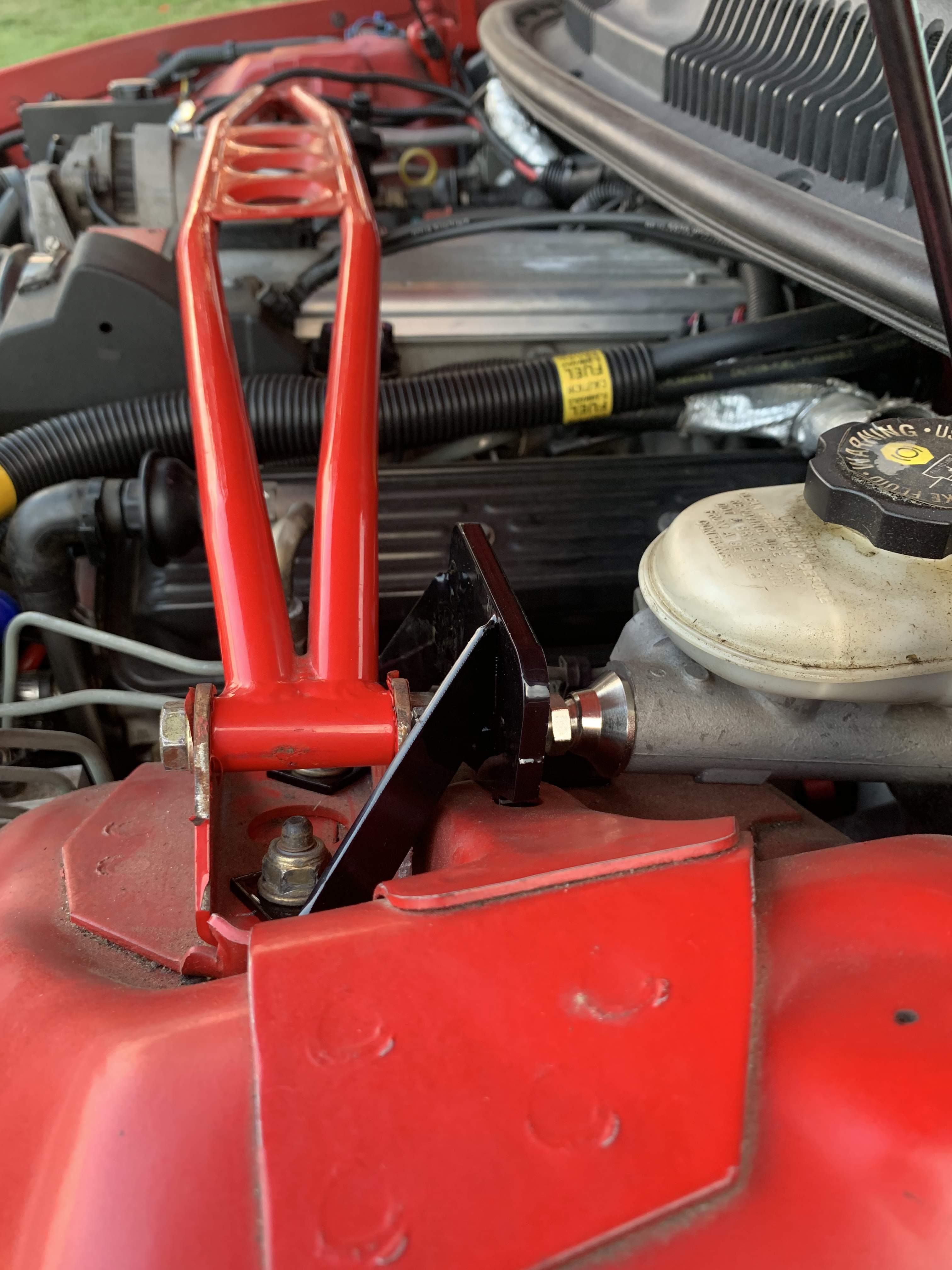

Installed Strano master cylinder brace for my 1995 Firebird. It prevents the master cylinder from moving and also stiffens up the brakes. Over time the master cylinder flexing can tear a hole in the firewall, this prevents that.

What does one of these braces cost?

About 100 bucks. It’s good quality and it’s easy to install.
