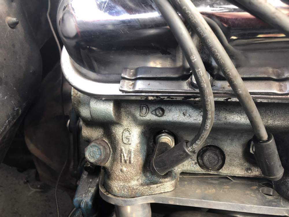

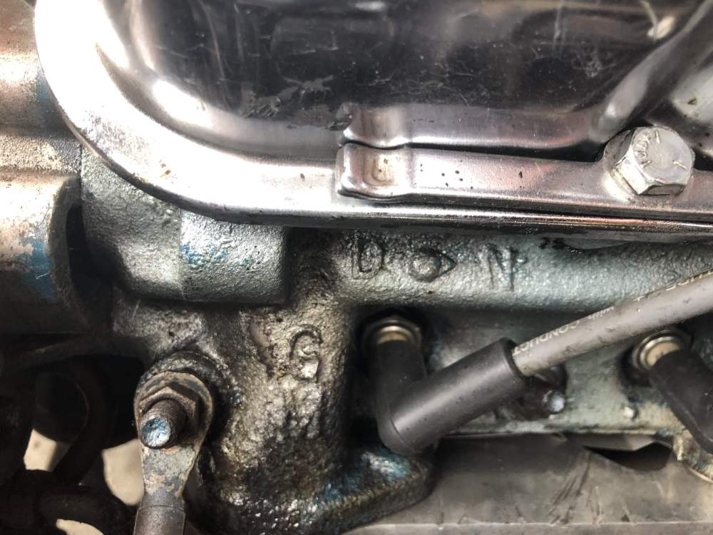

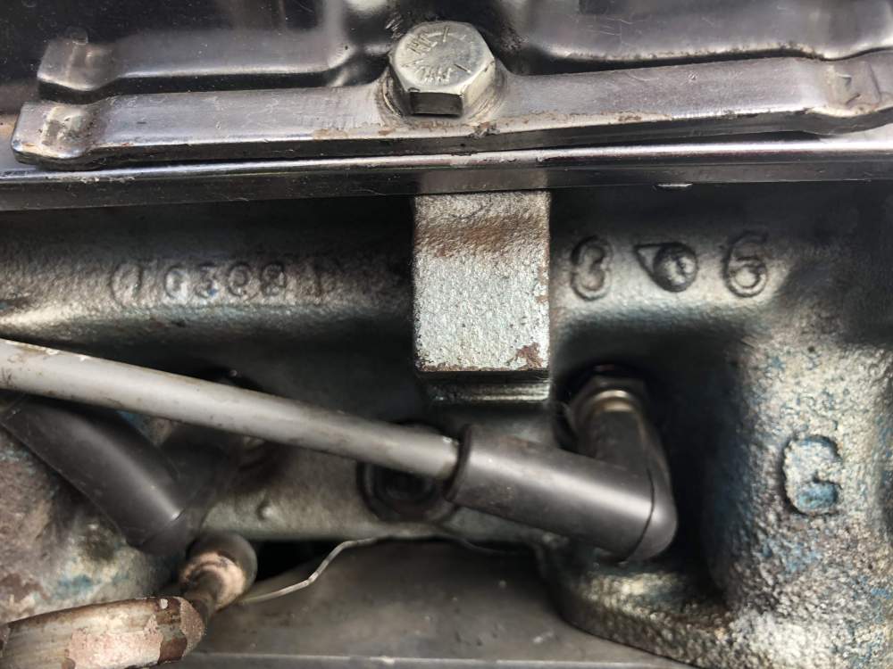

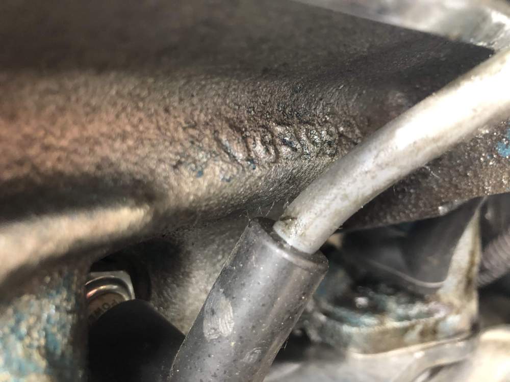

9) the heads I’m unsure but I will post some pics of the numbers on the sides

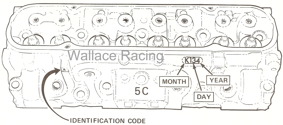

Your photos are appreciated but they are just missing key information we need to help you to help identify the heads.
There should be a two or three character designation where you see the 5C in the picture above. Or there is a six or seven digit casting number that usually begins with "5" or "9". Either one will tell us what Pontiac head you have and what cc's they are (assuming they are stock). I suspect you are correct that the cam and heads are not well matched to each other or perhaps the double pumper is a tad too much fuel.
