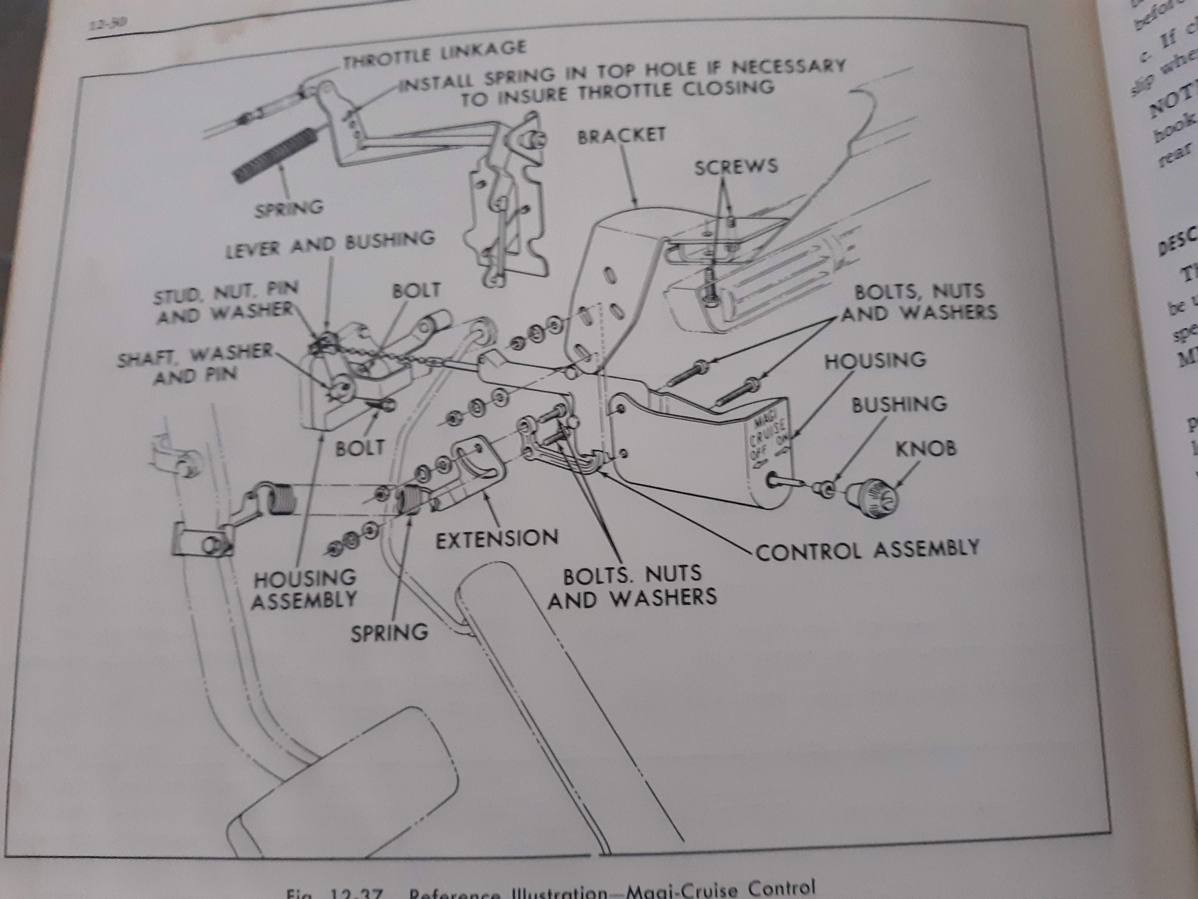

It's the Pontiac name for the the cruise control..
(Magi-Cruise throttle control)....
