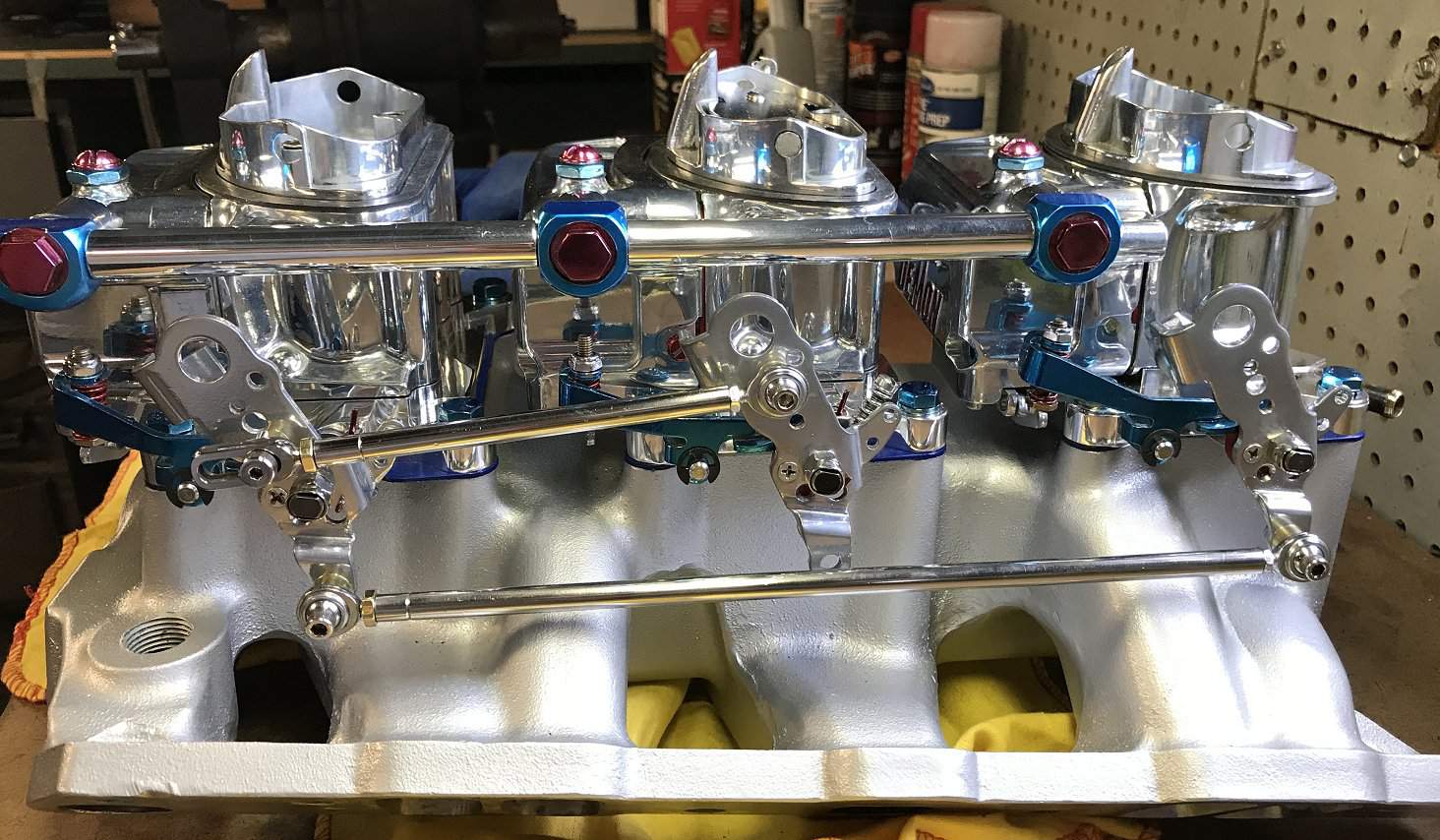

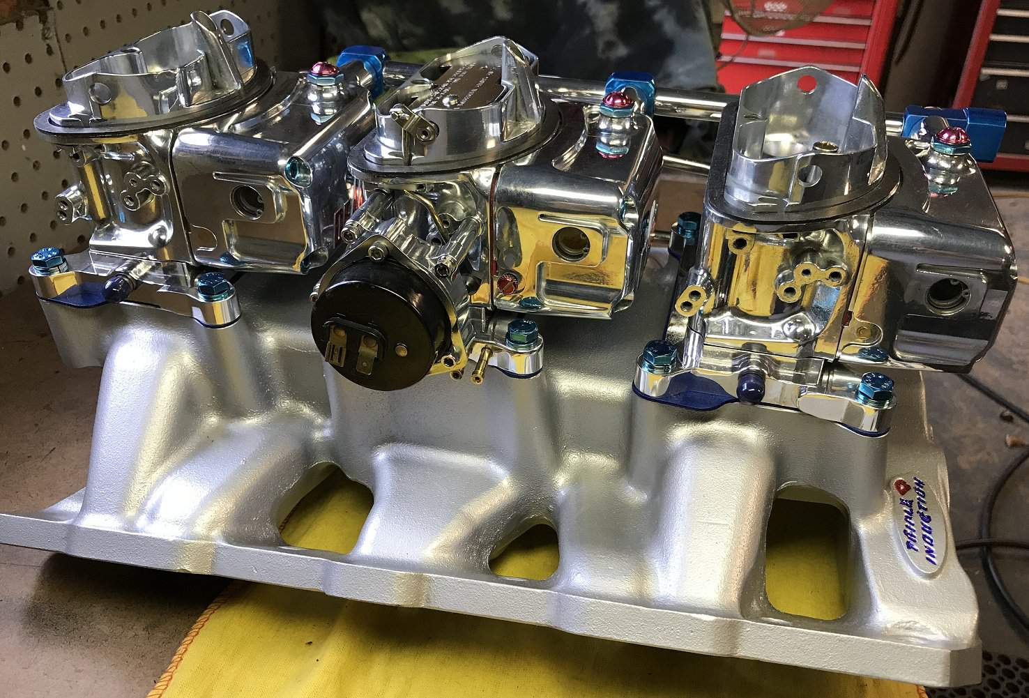

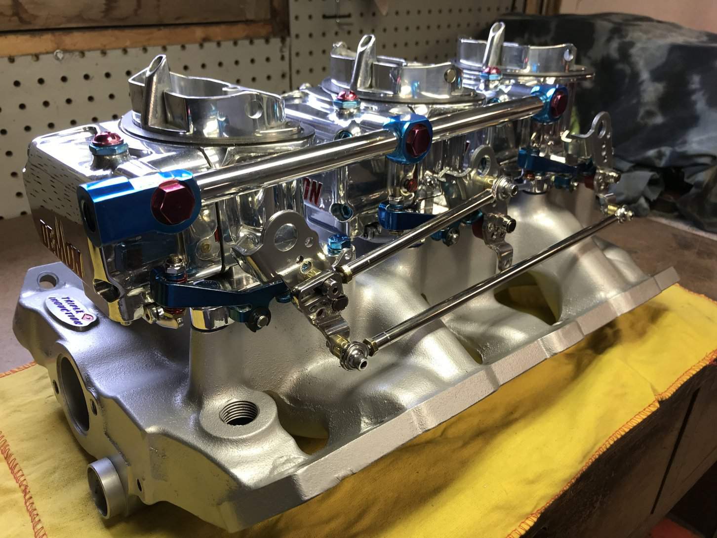

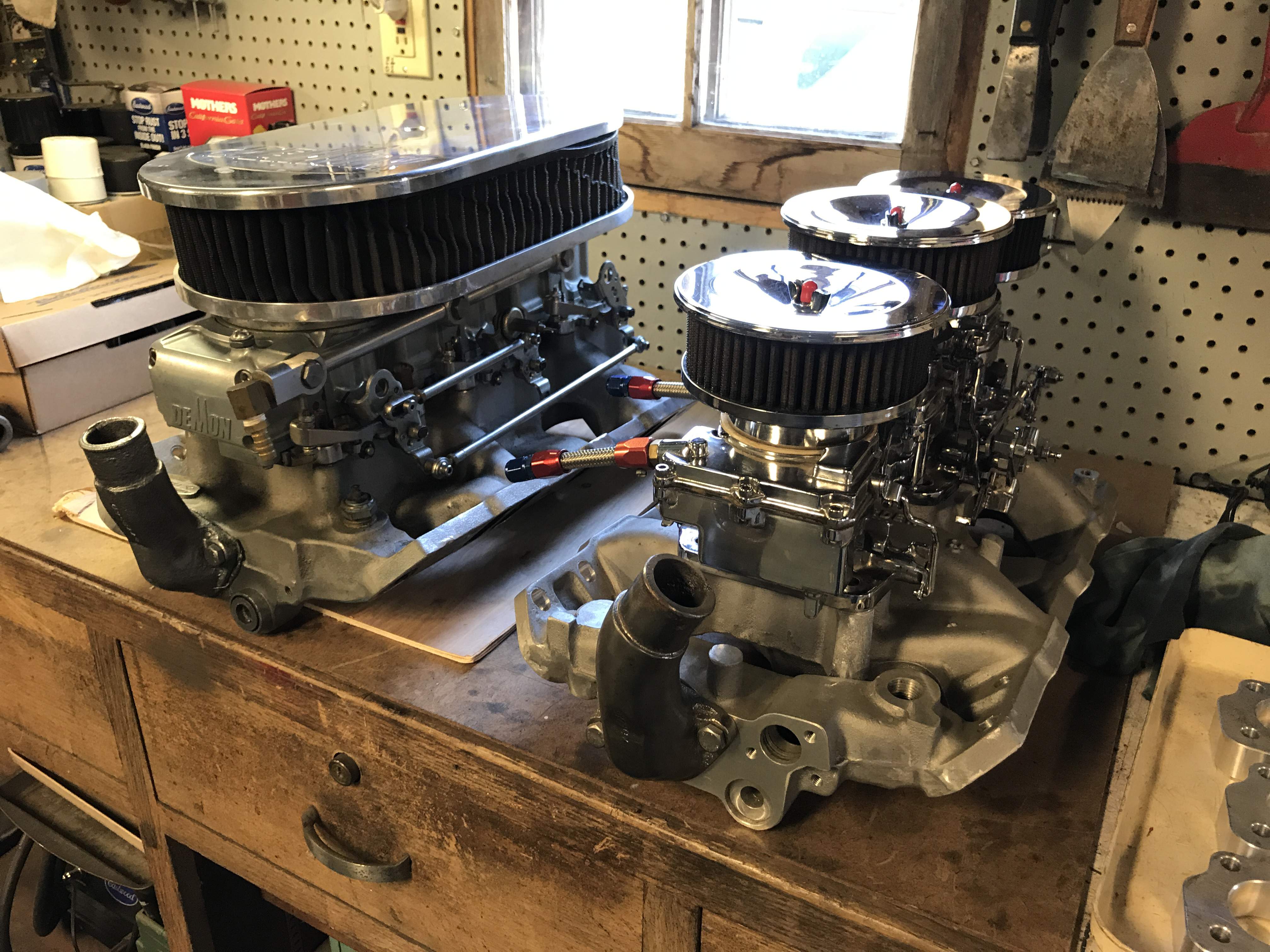

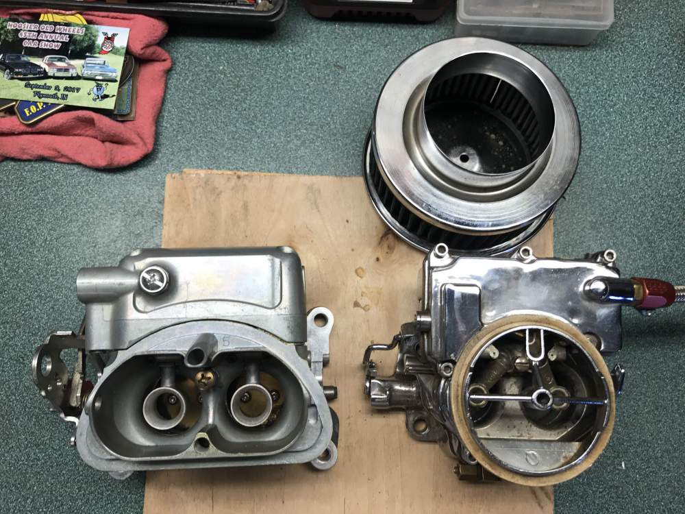

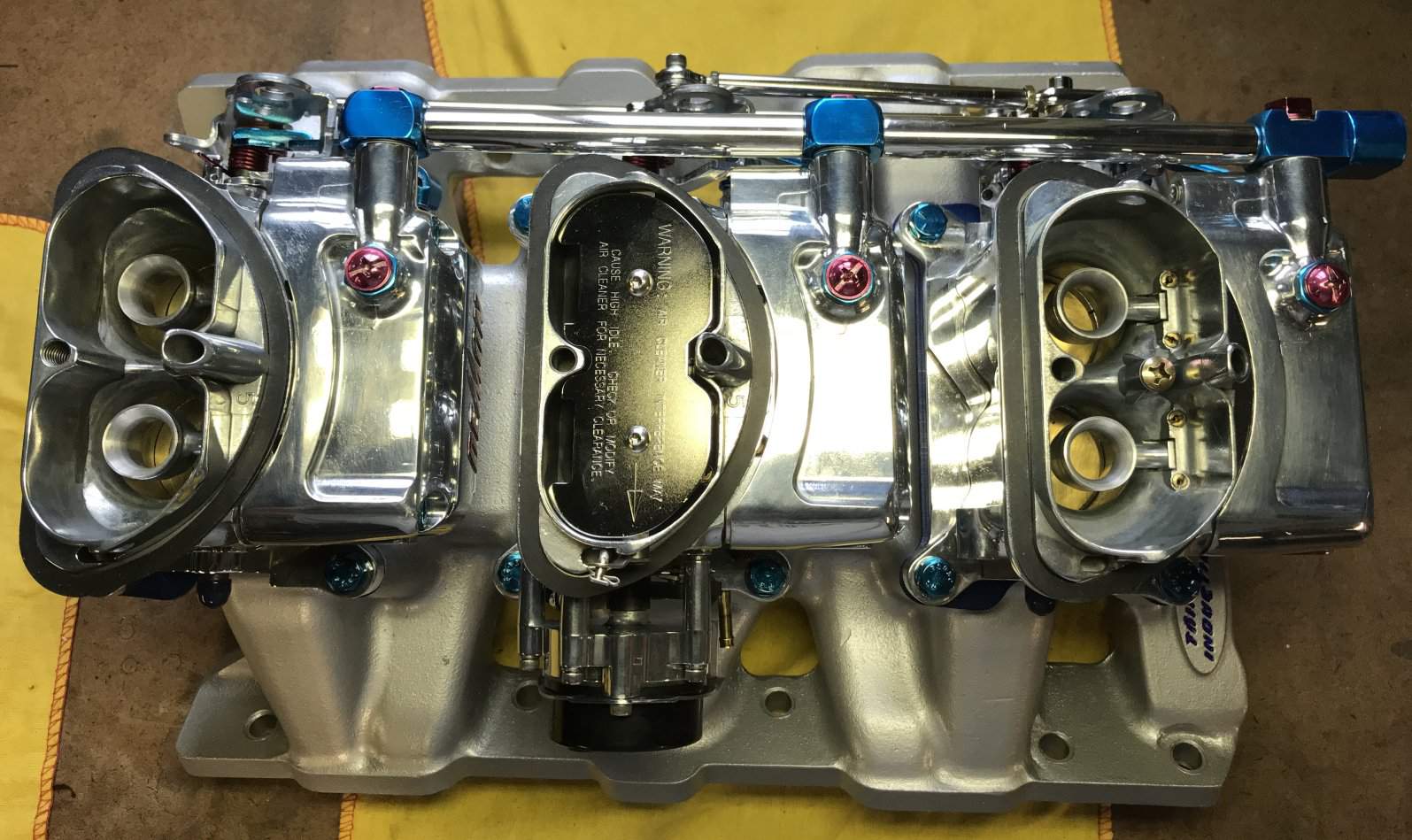

I was fortunate to get my hands on a Barry Grant Triple D Induction setup recently. I don't see very many around and they haven't been made in 10 years or more. I still have my original tripower setup but I would have to have a lot of work done to the Rochester carbs to handle the new 462 ci motor I put in my GTO a couple years ago.  With the BG setup using bigger Demon 2 bbl. carbs I will bypass a lot of the problems with the smaller Rochesters. At least that is the plan. I will be putting on this tripower within the next few weeks hopefully.  I have a question for ya all.  This tripower setup came with one big oval air cleaner assy.. Barry Grant also offered this setup with 3 separate round air cleaners mainly for us Pontiac guys because it looks much more like the original setup. I'm looking for the 3 separate cleaners but they have to fit a D shape carb top. The Demon carbs are like some Holley's  the have a D shape top and not round like the Rochesters tops are. I have filters that fit the round tops but I'm looking for ones that fit D shape. If anyone know somewhere that sell 6" round air filters that the base is D shape, please let me know. I checked everywhere I can think of. I might have to make them myself  but would rather not have to. Thanks Here a pic of the BG setup. I shined it up a bit. IMG_0972s.thumb.jpg.b0be89c40313f91aa11f80924441d442.jpgIMG_0974s.thumb.jpg.f812dce7417d5881665ea216efa67507.jpgIMG_0980sc.thumb.jpg.7a0a06cf1ca7af96f0145f9135944979.jpgIMG_0985s.thumb.jpg.f10d64bf72c1ce659dfd8aa7ea5e6a75.jpgIMG_0623.thumb.JPG.3f7cecb304f57a18aec4c2a1c0da646c.JPGIMG_0663.thumb.JPG.d13642d62bd9d886a8f7d94fd5e0a519.JPGIMG_0972s.thumb.jpg.b0be89c40313f91aa11f80924441d442.jpg
