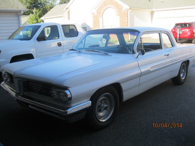

New to this site/forum. Considering purchase of a 61 Ventura Bubbletop with 65 389/4bbl, HP unknown. Was a column 3spd, now has on floor. Poor conversion job. Plan is to  change over to an auto as seller wants to keep manual shift linkage and steering column. He's asking $500 for a fair body, mostly there car with all trim, all interior, complete dash, no broken glass, no major body damage (other than sitting outside for 15 years). Will do mechanical (brakes, fuel, etc) resto to be road worthy. Will thoroughly check frame and replace rusty trunk panel. Questions: Will BOP "A" body steering column from 64 Chevelle auto trans car replace steering column, a source for auto brake pedal setup, what auto trans will fit behind 65 engine, source for 1/4 panels and other sheet metal and anything else needed to consider. I know there are many uncertainties with this purchase. Suggestions and advice greatly appreciated. Many thanks. Attached 62 Catalina picture is what I drive daily now.
