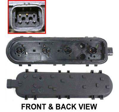

OK next thing would be to completely remove the rear driver's side tail light assembly. Once you have that out, you should find a printed circuit board/bulb holder that the bulbs plug into. I would remove it completely, and disconnect the electrical connection. Once it is out, look for any corrosion or broken leads on the electrical connections or in the bulbs sockets themselves. Also inspect your tail light lens (since you have it off) for any cracks or damaged weather seal where water can get through.
If you find a lot of corrosion on this PC board, it may need to be replaced. Fortunately these parts are available.
If you find slight corrosion, then some sand paper should clean it up and then add some di-electric grease to help keep any moisture in the future out.
I had the exact same problem on an 03 Montana..The PC board looked great no visual indication of an issue...Just replaced whole assembly...Problem solved.
