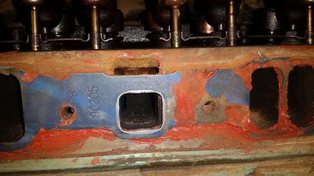

Thanks. I was wondering what that gallery above the exhaust crossover carries? If it carries water I think the gasket was wrong. The number I got from the block was on the right front of the block stamped on not cast. Thanks for your help!
Sorry I am late in responding. Yikes you have aone helluva gasket mismatch. The center cross over is generally for heat - not water, to allow the intake manifold to warm up quickly in cold weather climates.
