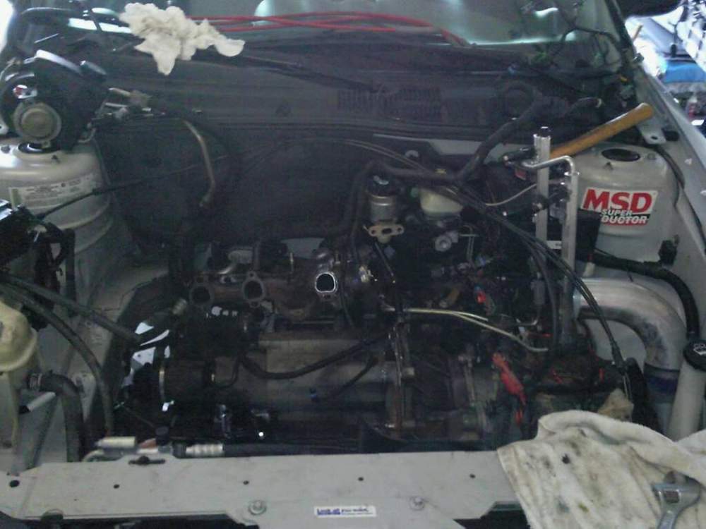

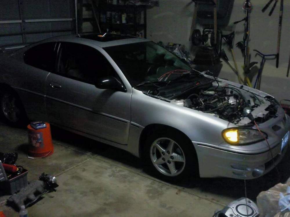

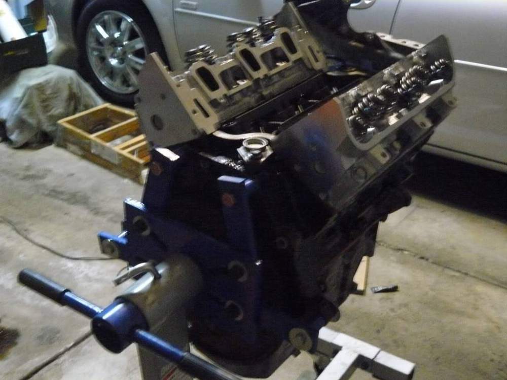

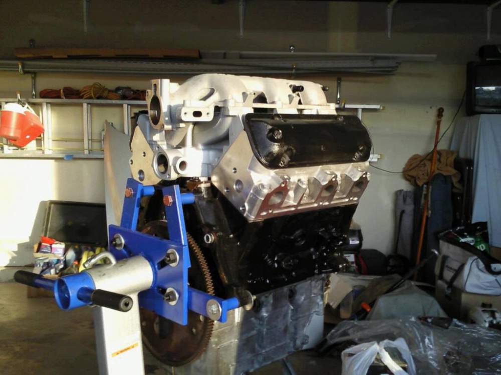

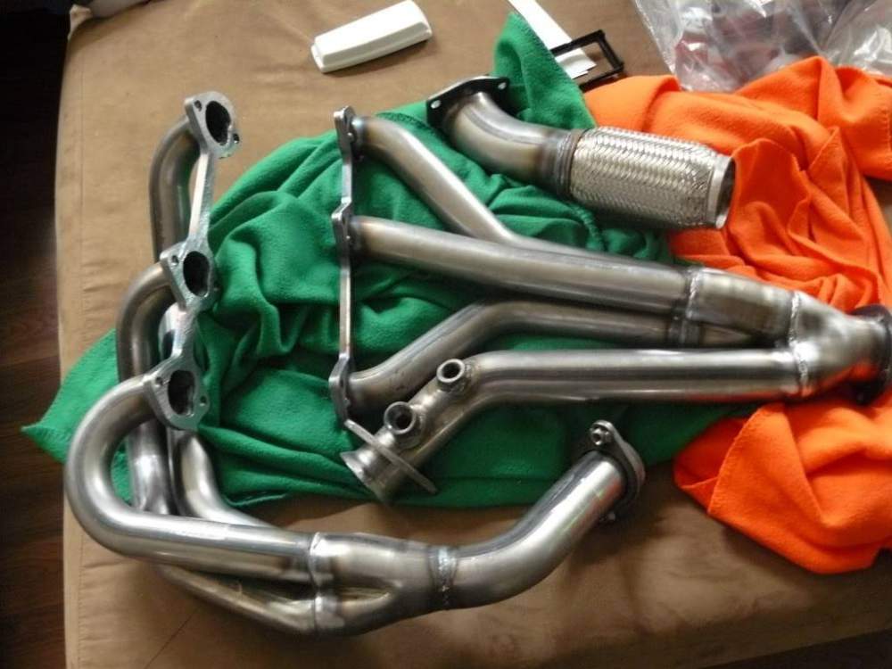

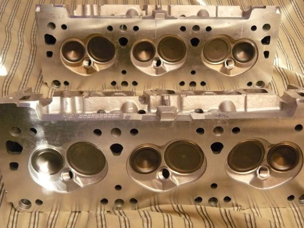

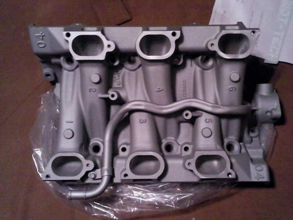

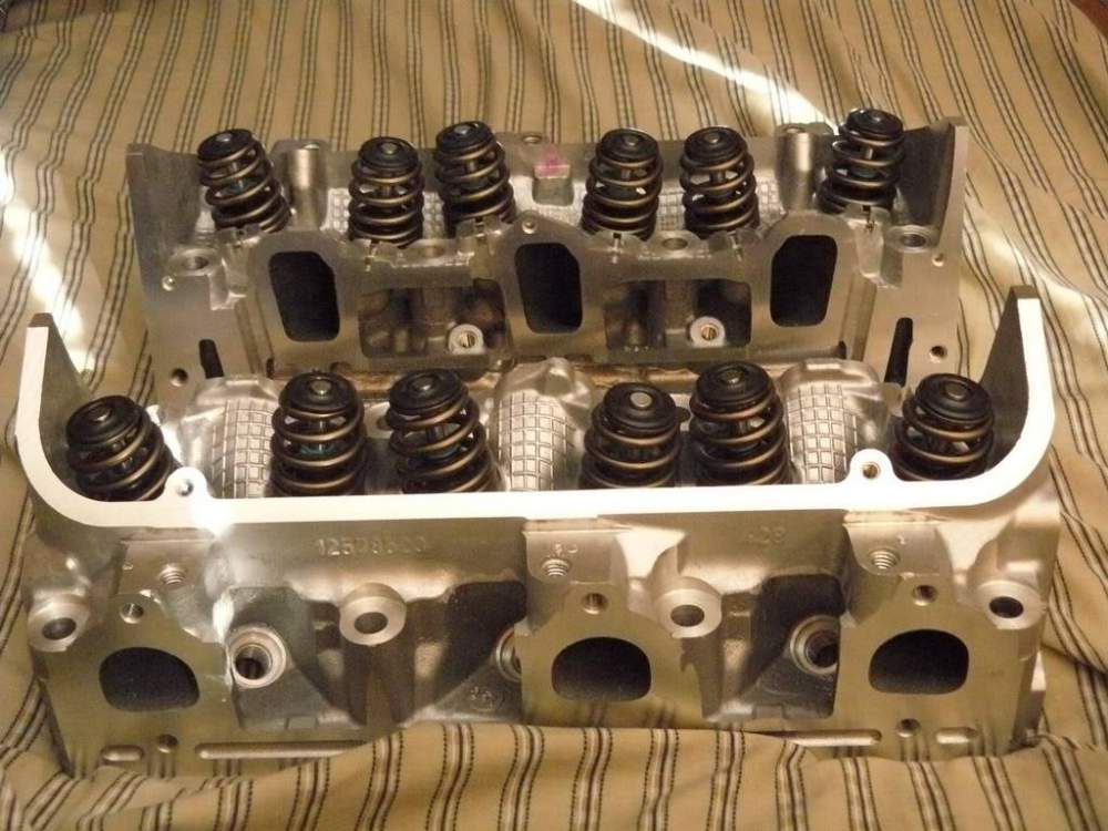

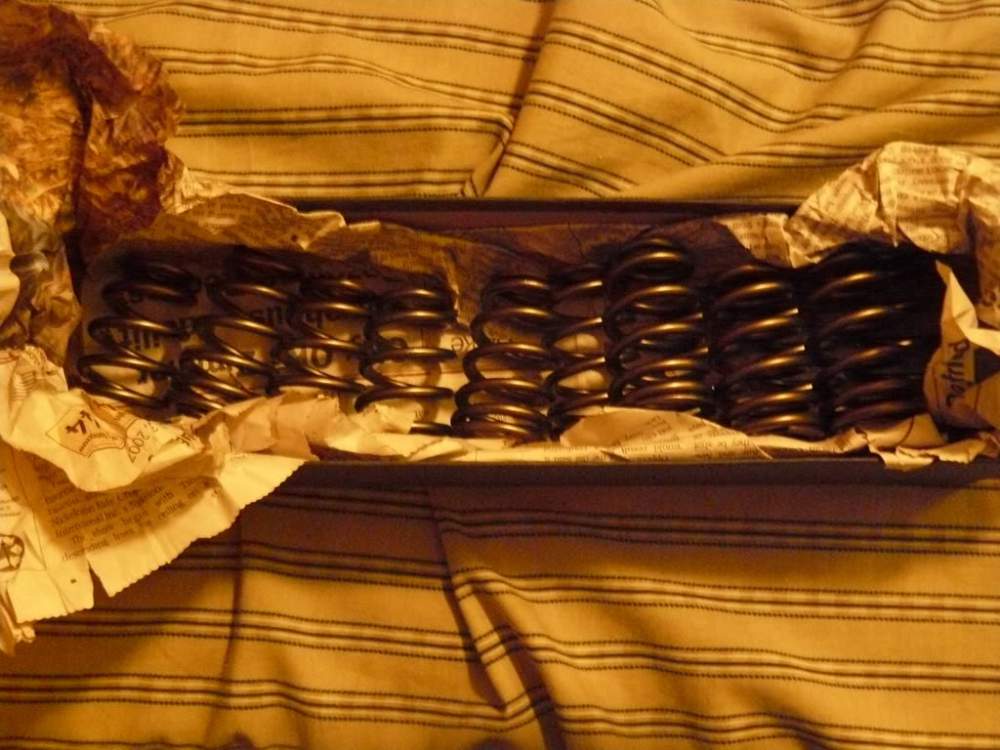

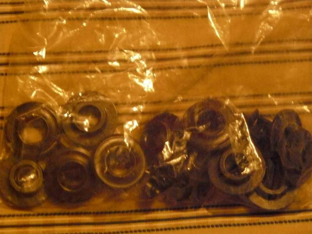

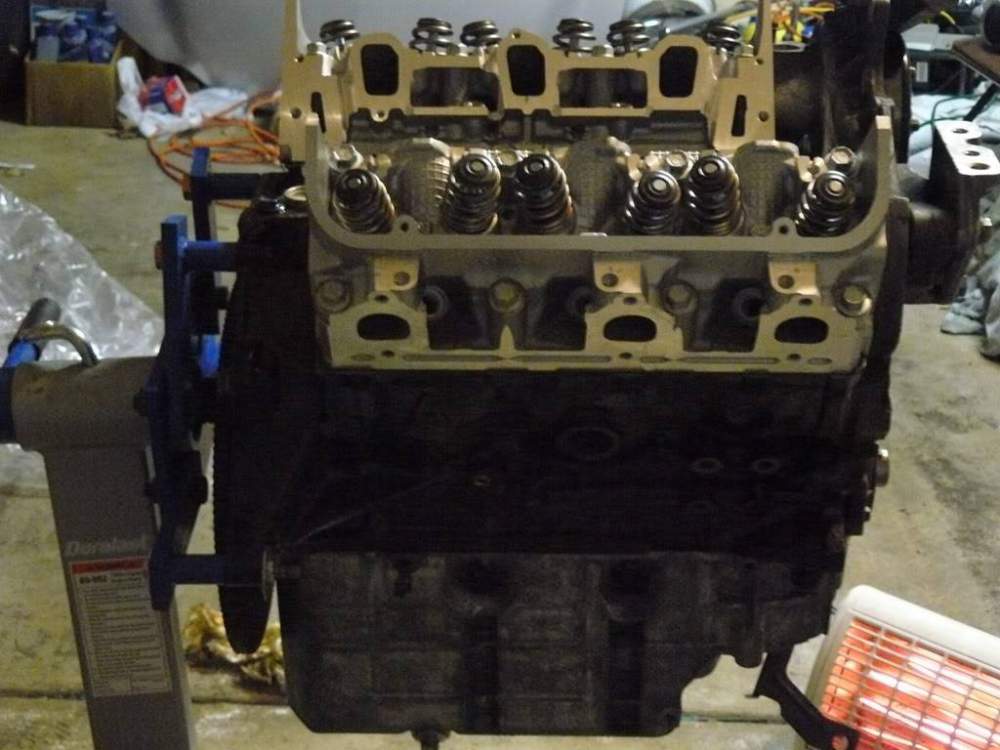

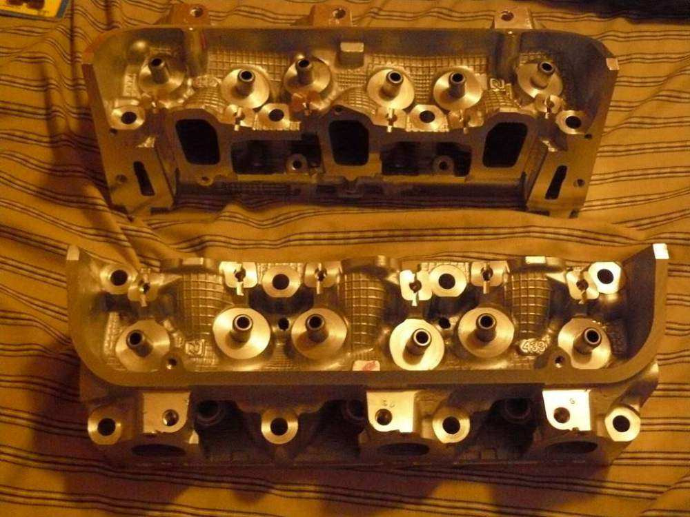

DS stage 3 CAI, TCE 65 mm tb, WOT comp ported LIM and UIM, OEM 3500 heads with comp cams springs and locks and retainers, WOT 1393 grind cam with matching pushrods, S&S headers with flex, full 2.5 in cat back to a flowmaster 80, and an MPR
im prolly forgetting things. i also have a TCE afpr, autometer oil pressure and trans temp gauges, and an AEM Uego wideband.
oh yes, brand new lifters with tce ls lifter springs

i dont know the exact specs on the cam but its somethin like .535 int and exh lift with close to a .220 int and exh duration and 112 lsa. it lopes pretty good. i need higher compression cuz it dies sometimes. low compression + long duration = car cant stay alive sometimes.. but its cool. thats the kind of cam i wanted

it took me almost a year to gather parts alone. Then because of random mishaps during the swap it took me almost a month to complete

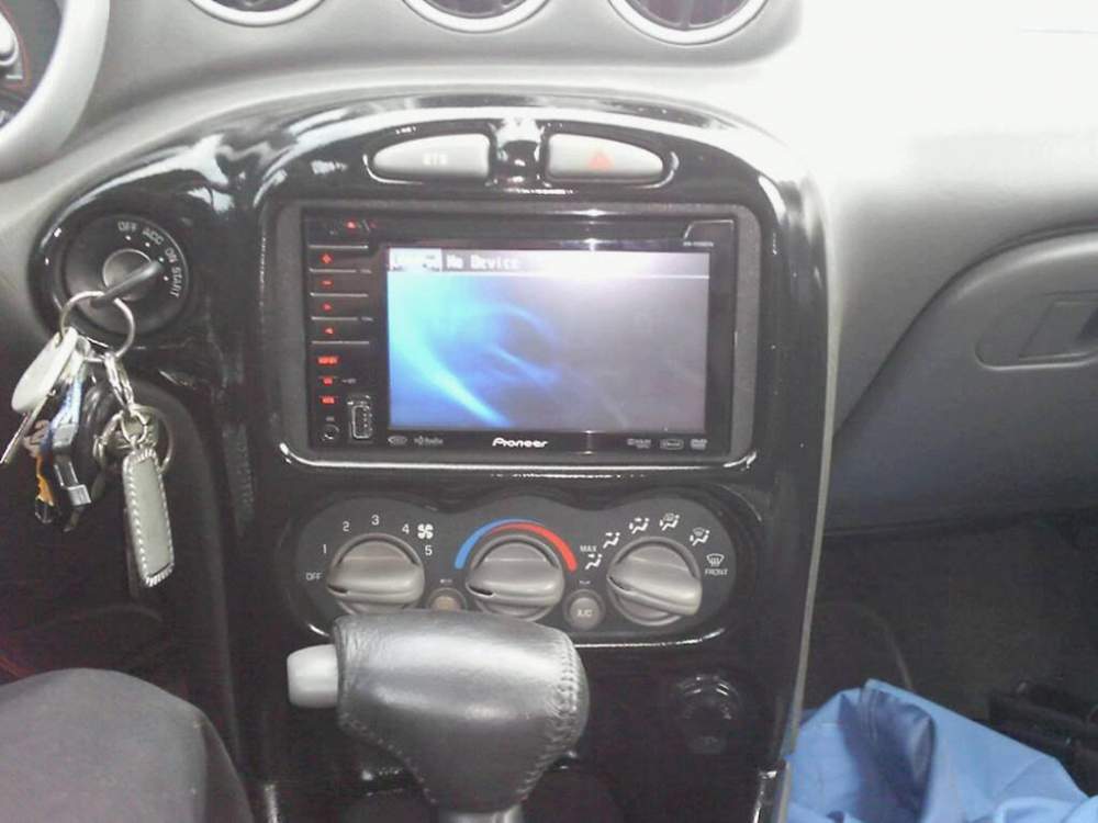

can i haz your double din deck?!?! pretty please?!?!?!

yes, that vid is old. s&s headers with a custom 2.5 in header back exhaust with a flowmaster 80

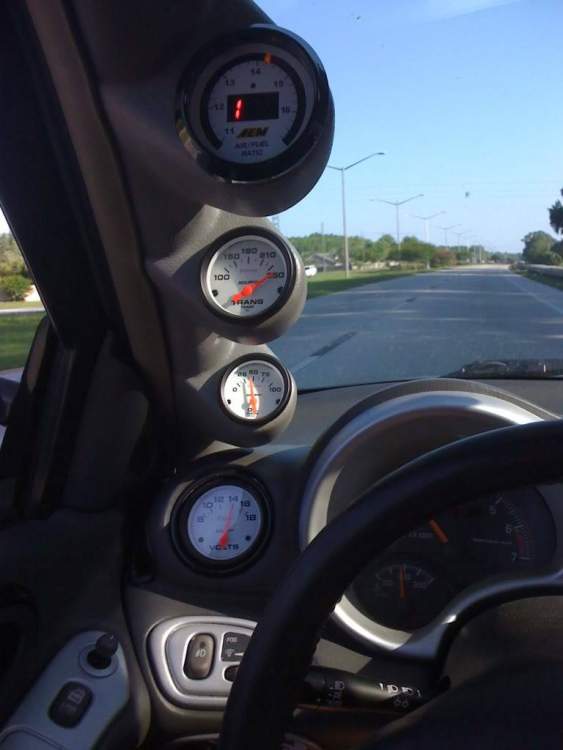

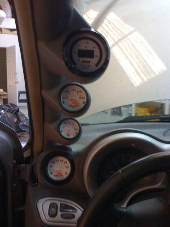

update. new gauge in the dash...also new project in the works. more to come.
