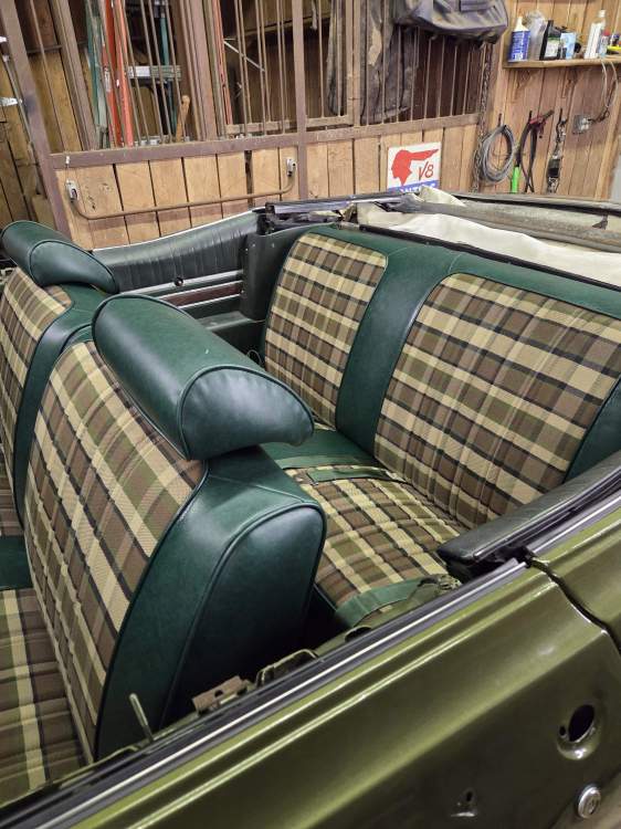

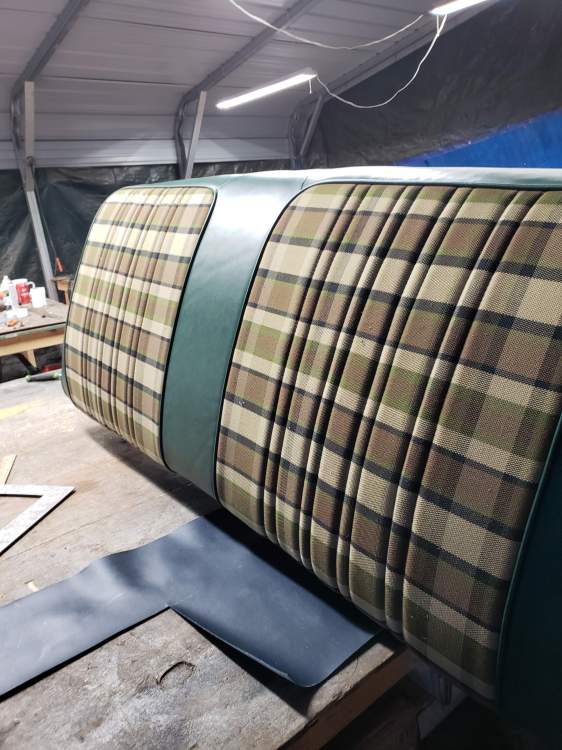

I went with a tan & light green plaid for the upholstery in mine from a company called "Relicate". You will also likely need all new seat foam and I did not do an upholstery kit, this was yardage. Look carefully in the seat springs of your seats and if you are lucky, you will find perfectly usable factory build sheets for your car. There's also probably a sheet behind the sound deadener board behind the upper back seat section.

Thank you for the info, wow your upholstery looks fantastic !
