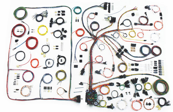

I have not had to replace the wiring harness on my Catalina but I certainly did on my A-Body Chevy El Camino. I went with an American Auto Wire "Classic Update" kit and it had plenty of modern device / amperage upgrades. No more glass fuses, they were replaced with the modern "ATO" style. Each wire is well marked along its length with precisely what it connects to. You lay in the wires, cut to length and attach the correct connector. The instructions are sectioned and very well written. Get comfortable with a multimeter for testing as you go. It took me most of a month to get it all in, loomed, cut to length and connectors soldered / crimped. It was a night time and winter project that could be done faster. Their new fuse panel will fit your firewall hole perfectly.

Classic Update Wiring Kits
American Autowire Classic Update wiring kits are the perfect vehicle-specific solution to modernize your ride. They easily accommodate swapped engines, fuel injection, aftermarket gauges and a host of
A company called "Painless" also makes a kit but I have no direct experience with them. They do have a good reputation among car enthusiasts.
