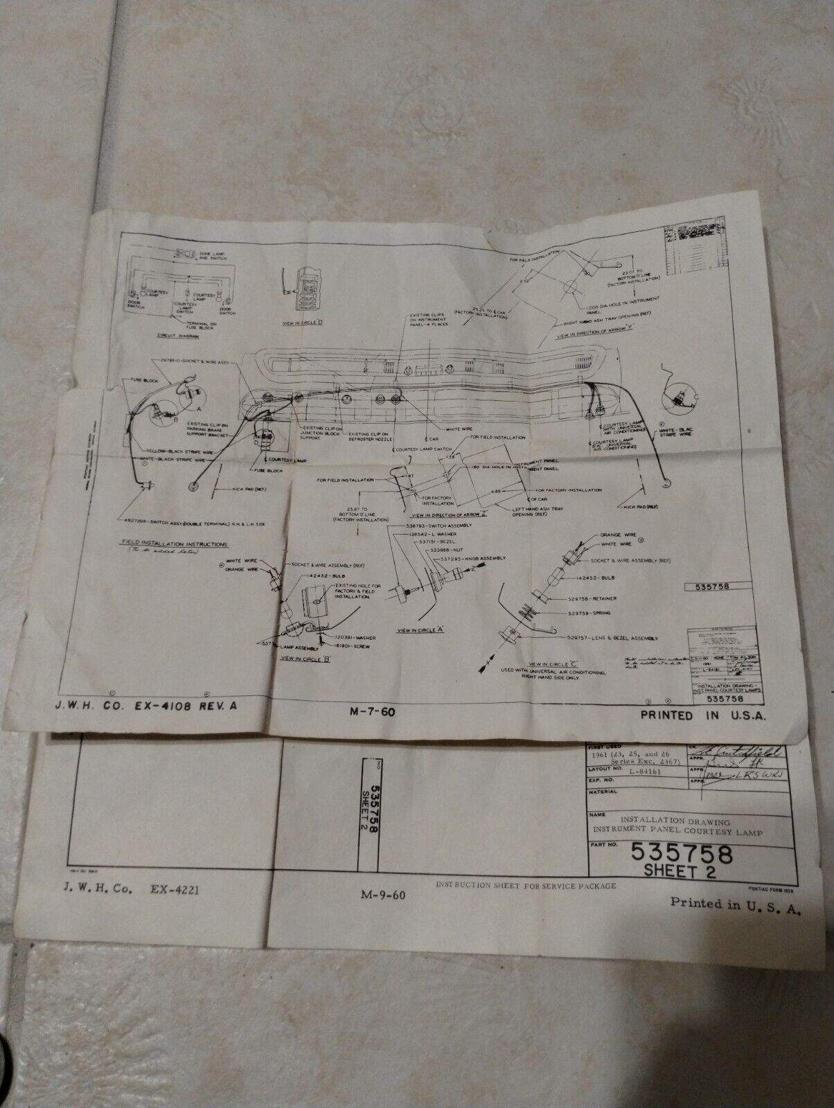

I can post the Dealer Installation instruction sheets of 60's Pontiac accessories. This is information that the dealer got on how to install a Pontiac accessory at the Dealership's Service Department. This information typically is not shown in the Factory Manuals, and usually includes diagrams, electrical, and/or operation procedures. An example of this is attached below. I can usually help with info, if you have a problem installing with my expertise in 1960, 1966-1967 Pontiacs. Good luck and have fun upgrading your Pontiacs.

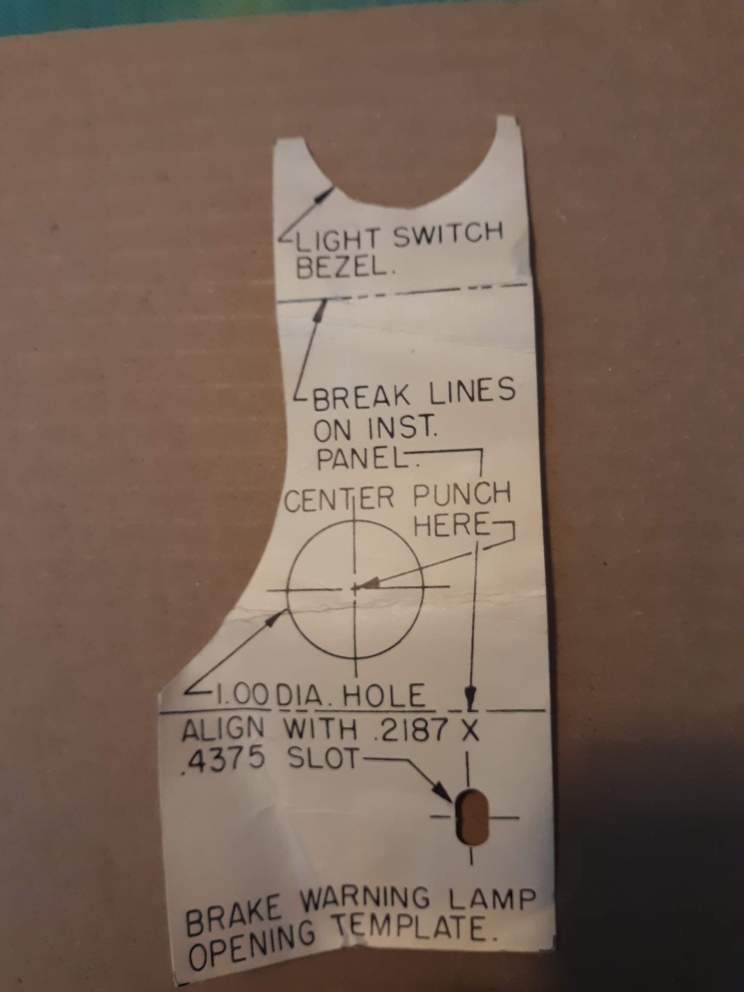

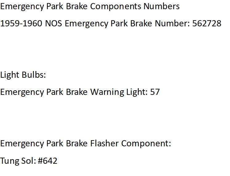

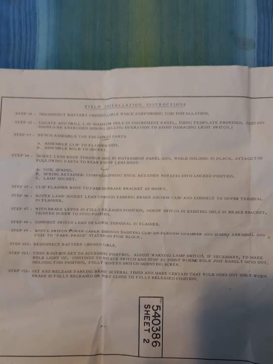

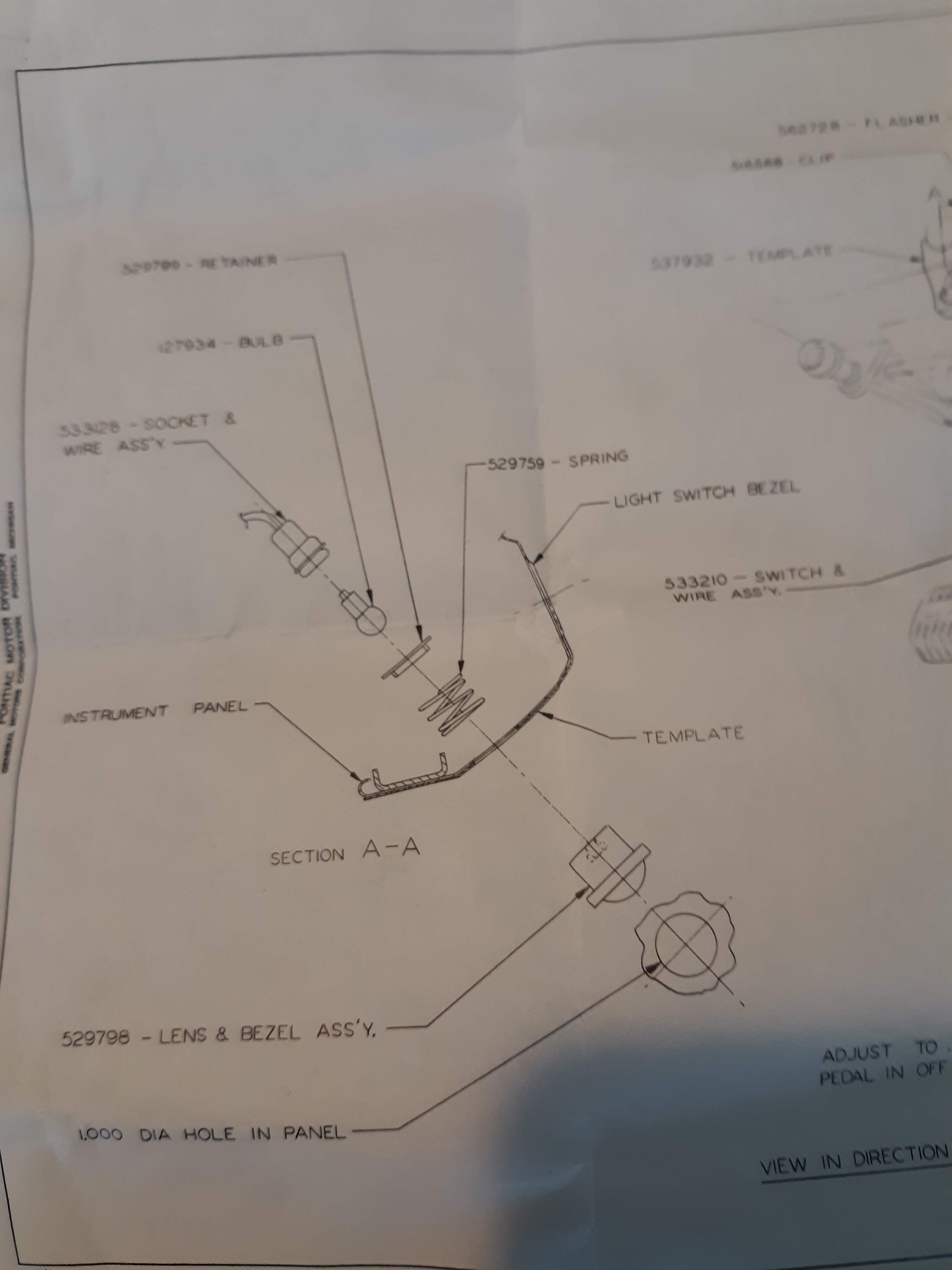

Many times, I would accidently drive my 1960 Ventura with the Park Brake on. I was able to purchase and install the correct 1960 Pontiac NOS Emergency Park Brake Warning Light option in my car. You can sometimes find them in good used shape, or NOS on eBay. The files attached should be able to help in the installation of this safety option. If you have any questions, or need help, please feel free to ask. Some files may also be included that has information for the 61-64 Pontiac as well. Good Luck and keep safe. Rick
Ps. The Template file did not match my 1960 Dash configuration. It may be for a 61-64. Use it for reference.

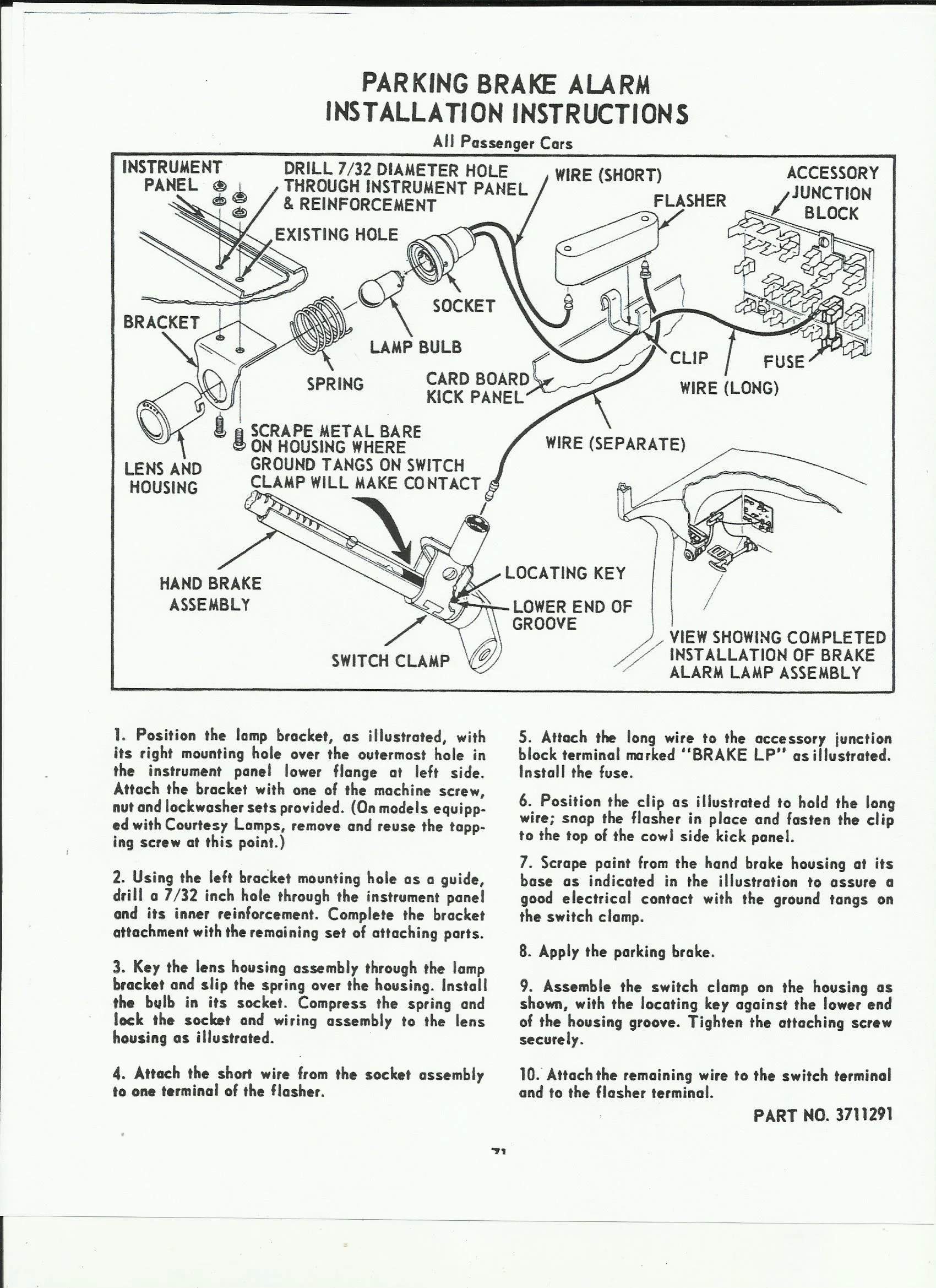

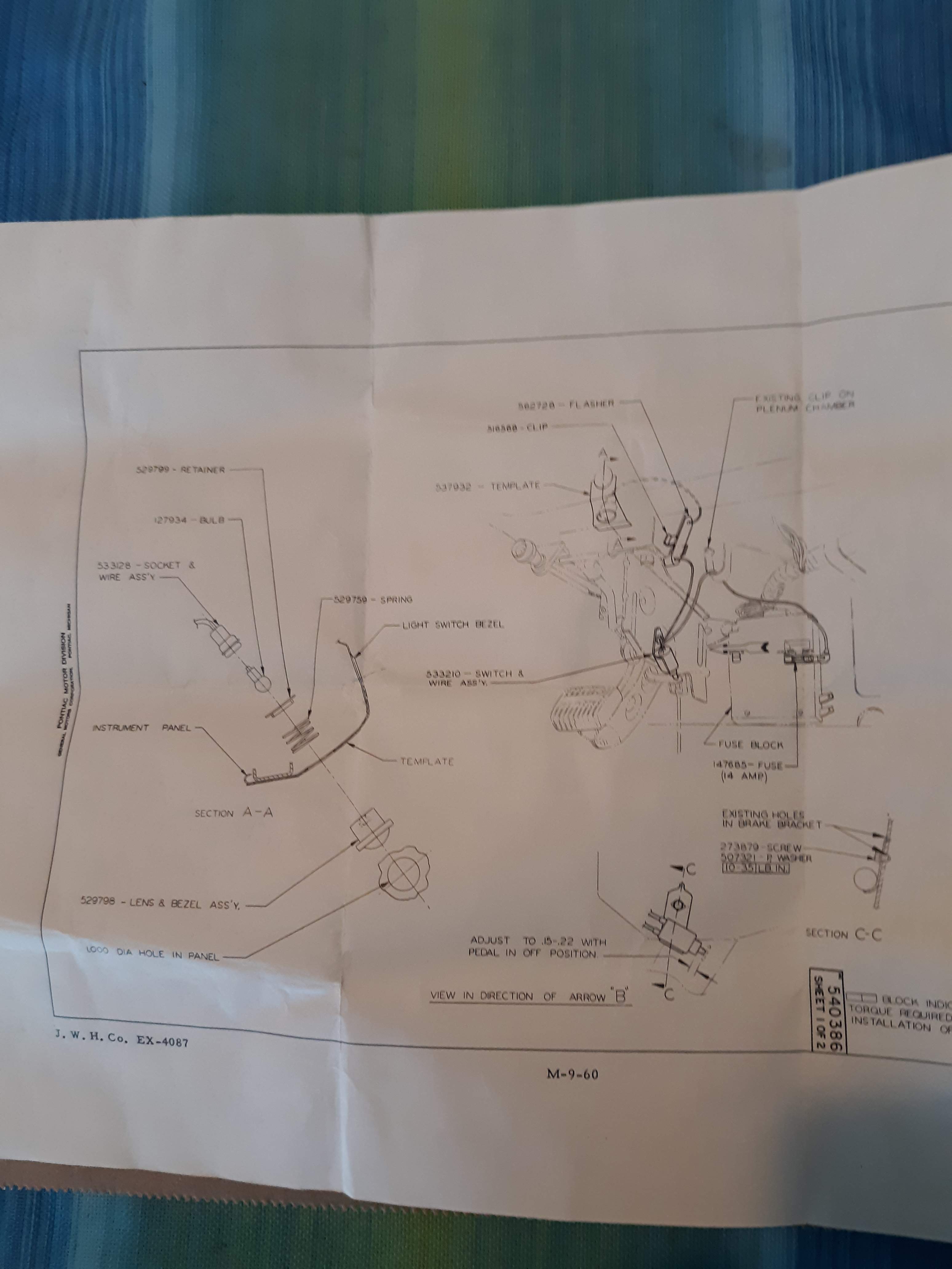

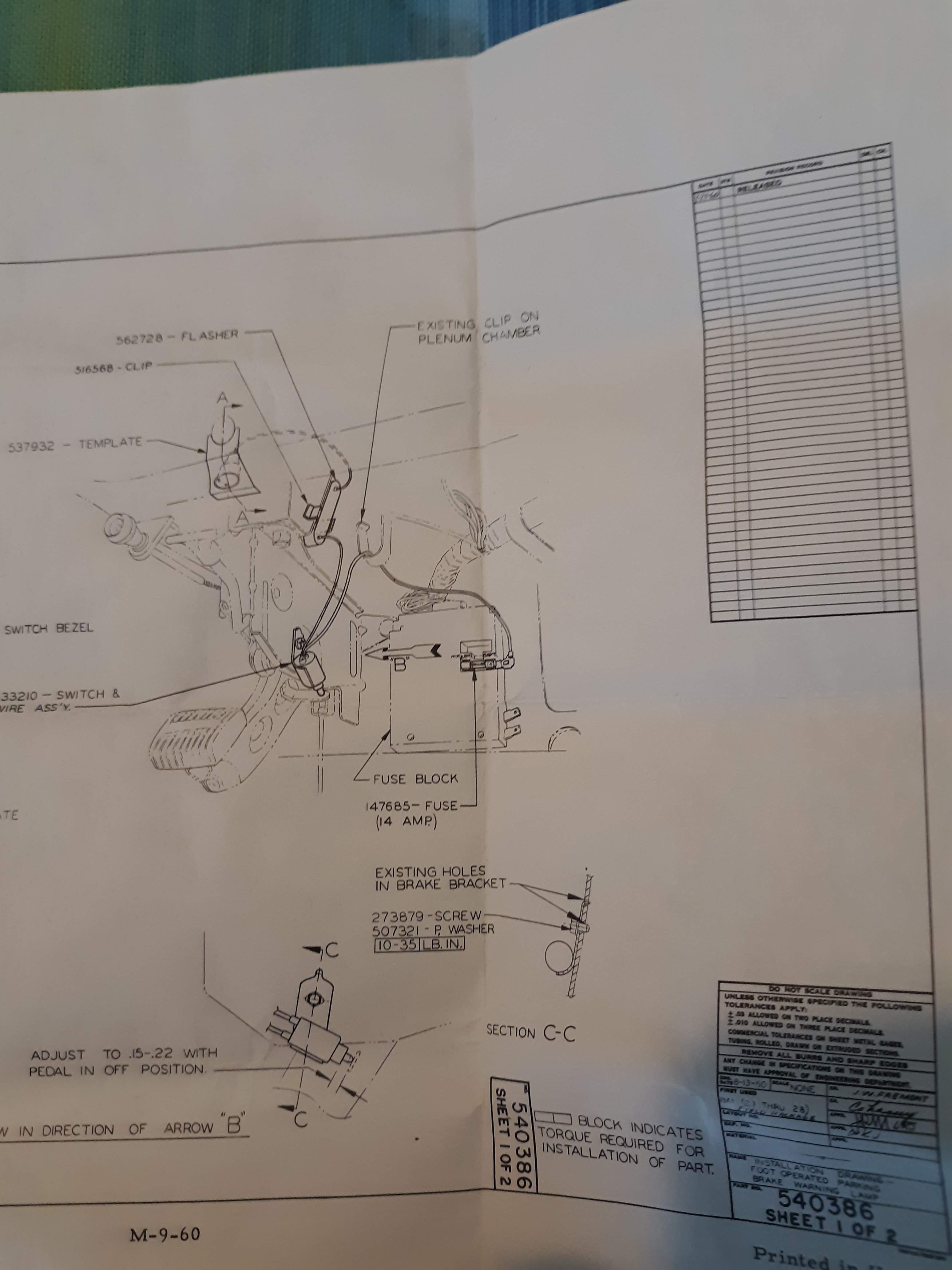

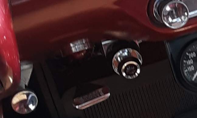

This post will be dealing with the Dealer installed: 1960 Pontiac Emergency Park Brake Warning Light
