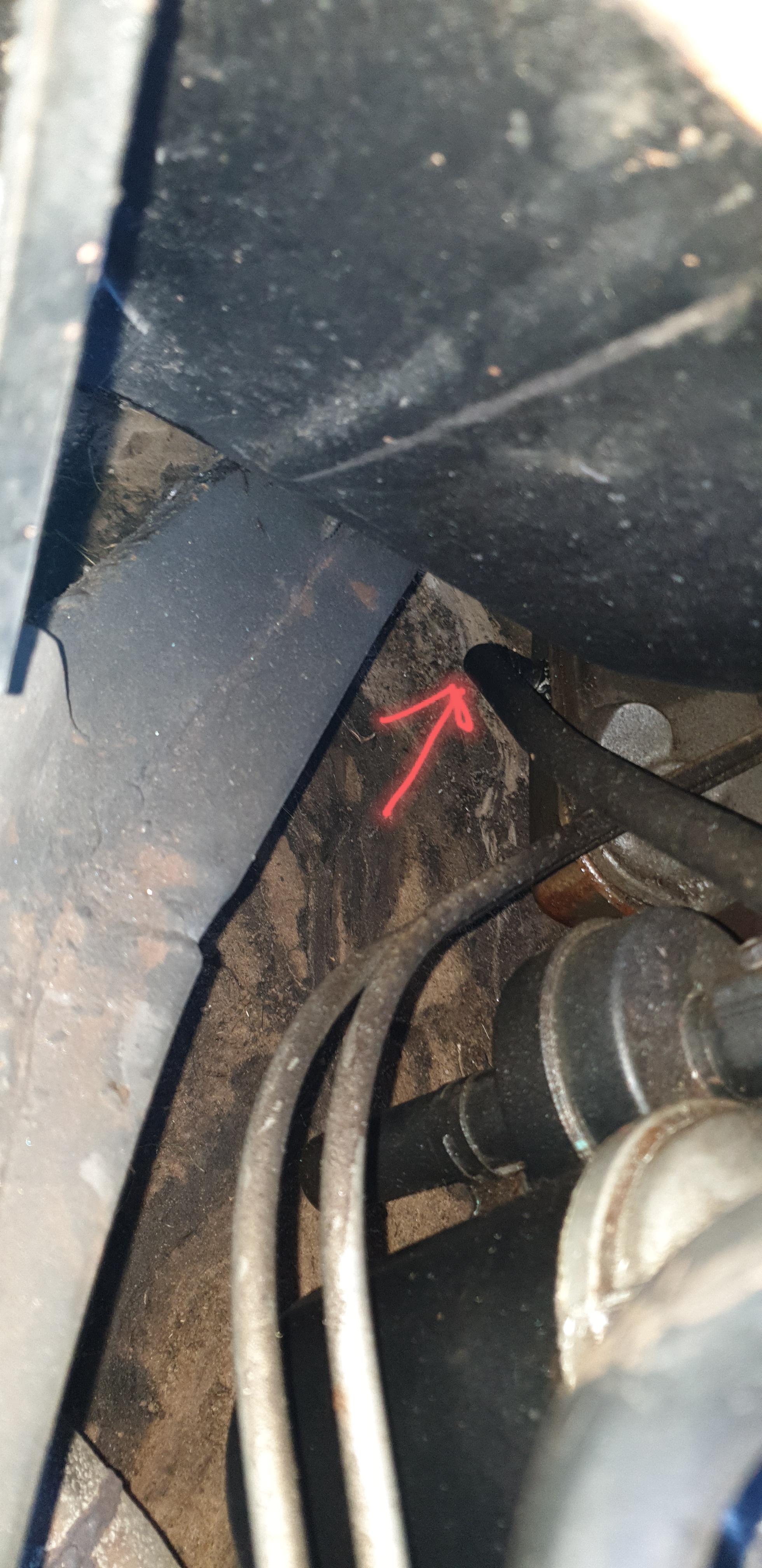

Also might pay to post a picture of the filler tube to make sure its the correct type with the ball in the bottom !
Oh great, that's some good info. Thanks mate.
bit hard to tell but it does look factory, it will have a 3/4 thread on the bottom of that right angle going into the trans
