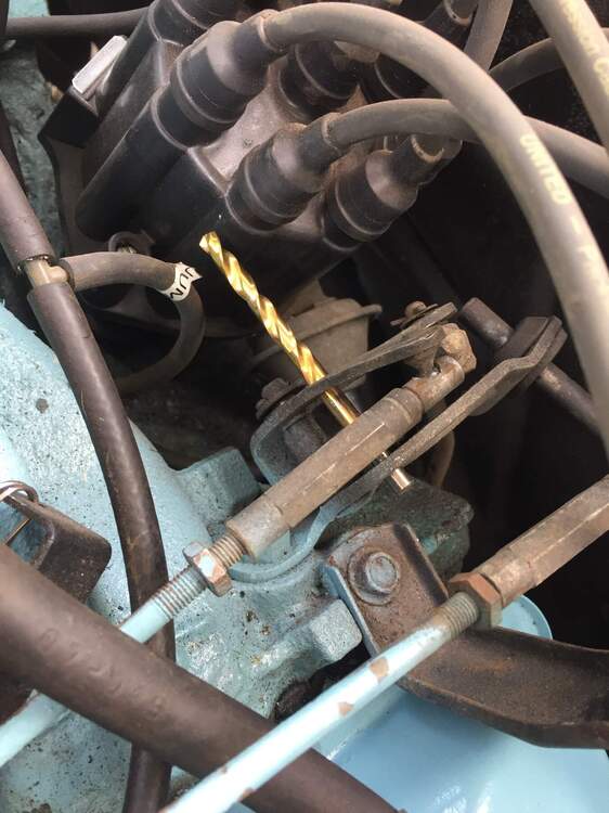

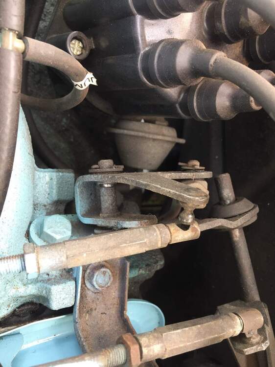

    So today i got time to have a go at adjusting the TV rod i have attached a picture of the shop manual instructions on how to adjust it. at first they are really hard to understand but if you do o
