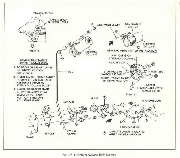

In 68 did they have cloum shifter or only floor shifters for automatic thanks
YES, It was available on both the 2 speed auto & TH auto.

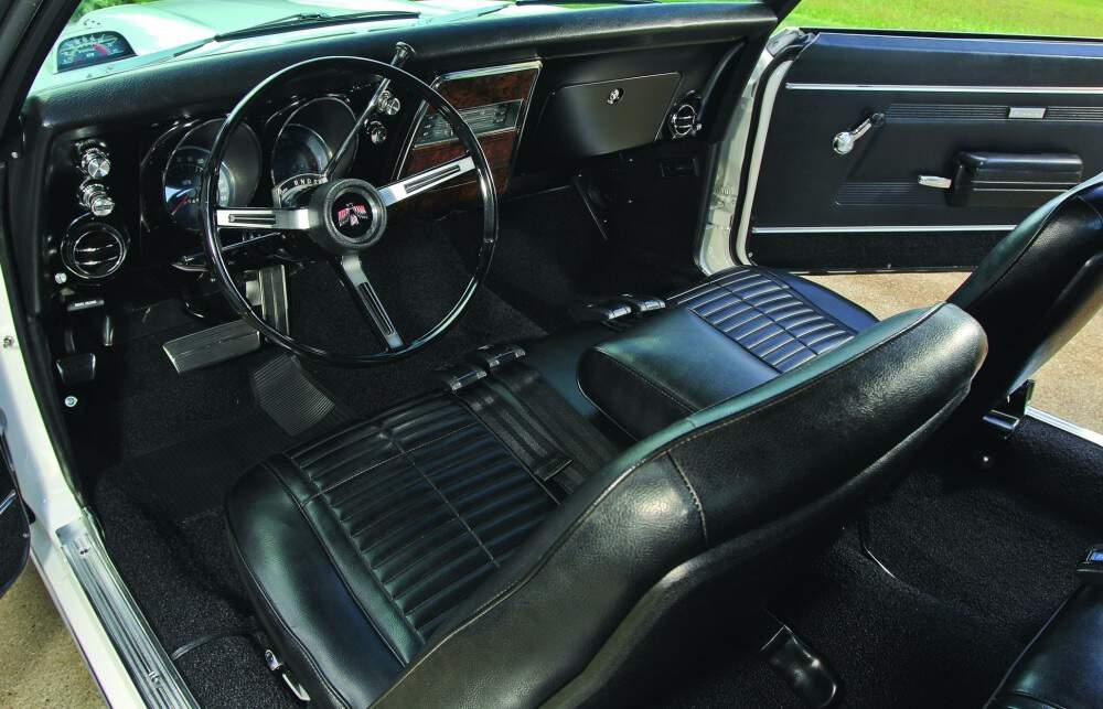

It you ever come across a bench seat FB in most cases it will have a column shift

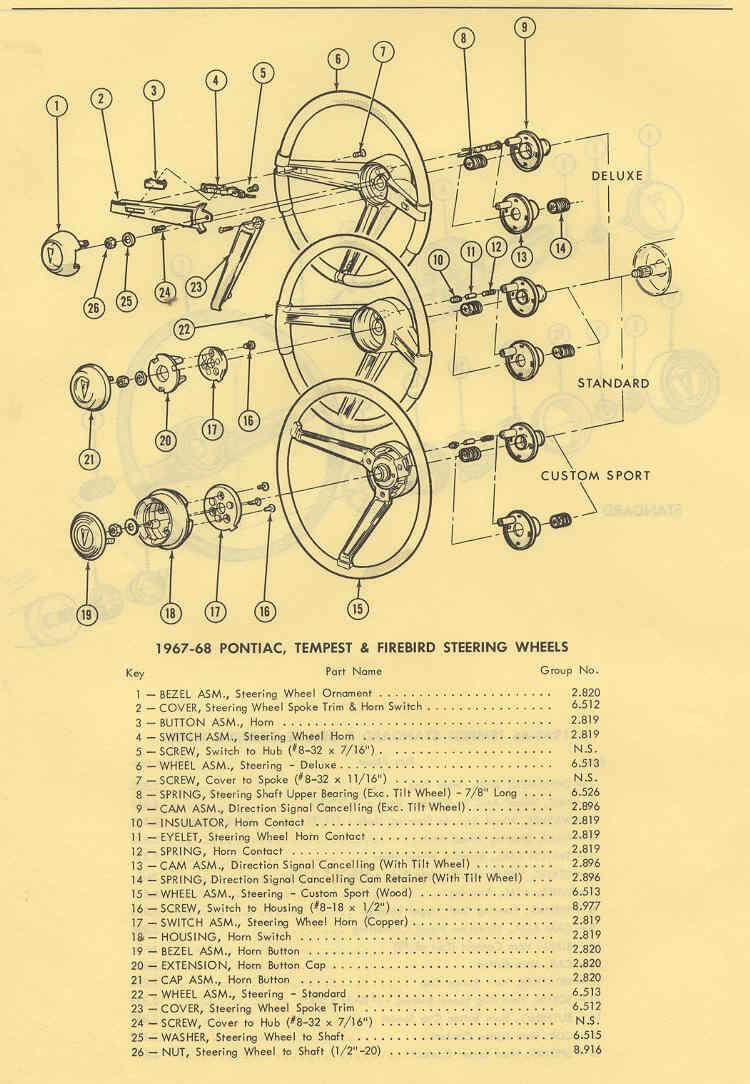

Awesome thanks my steering wheel is different than the one in your pic also I have slop in my shifter it needs the gromet up by the cloum it's in that parts diagram
They offered 3 style of steering wheels in '68.
