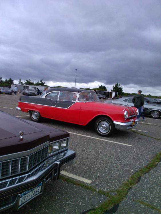

Here’s one
Sweet looking ride Poncho Pete. Tells us all about it and when you get your intake installed, let us know how she performs.

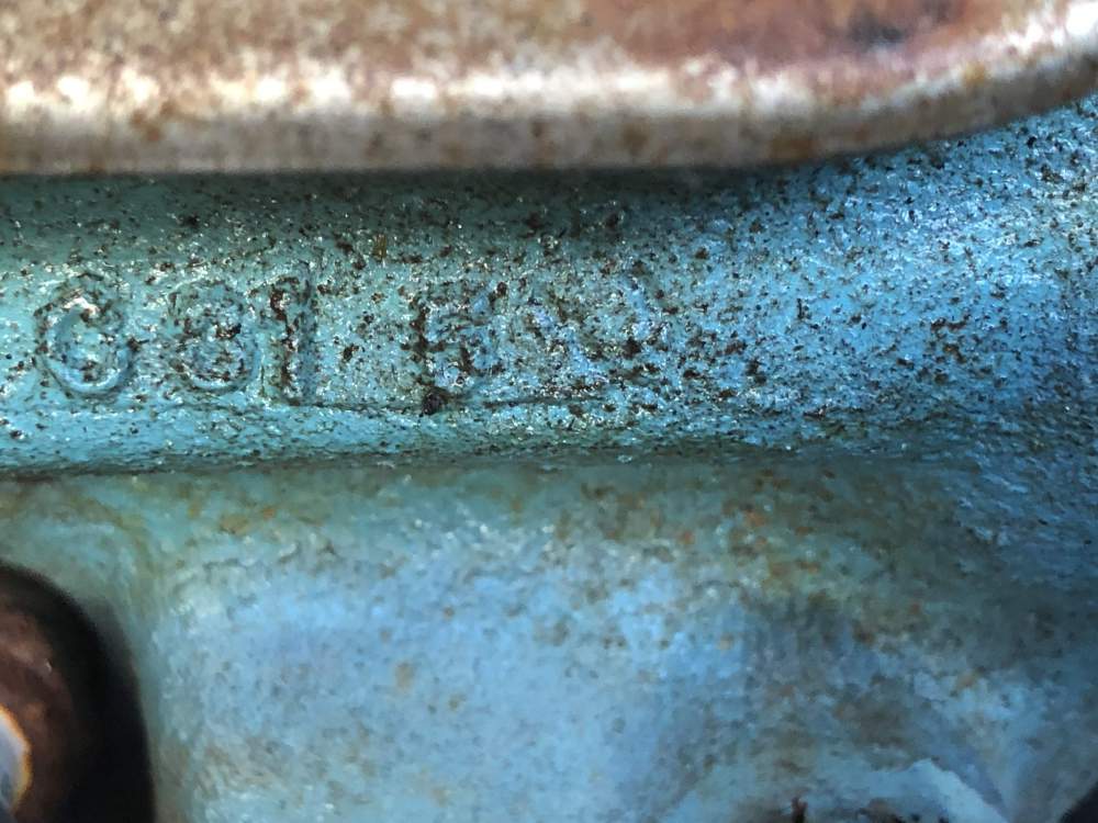

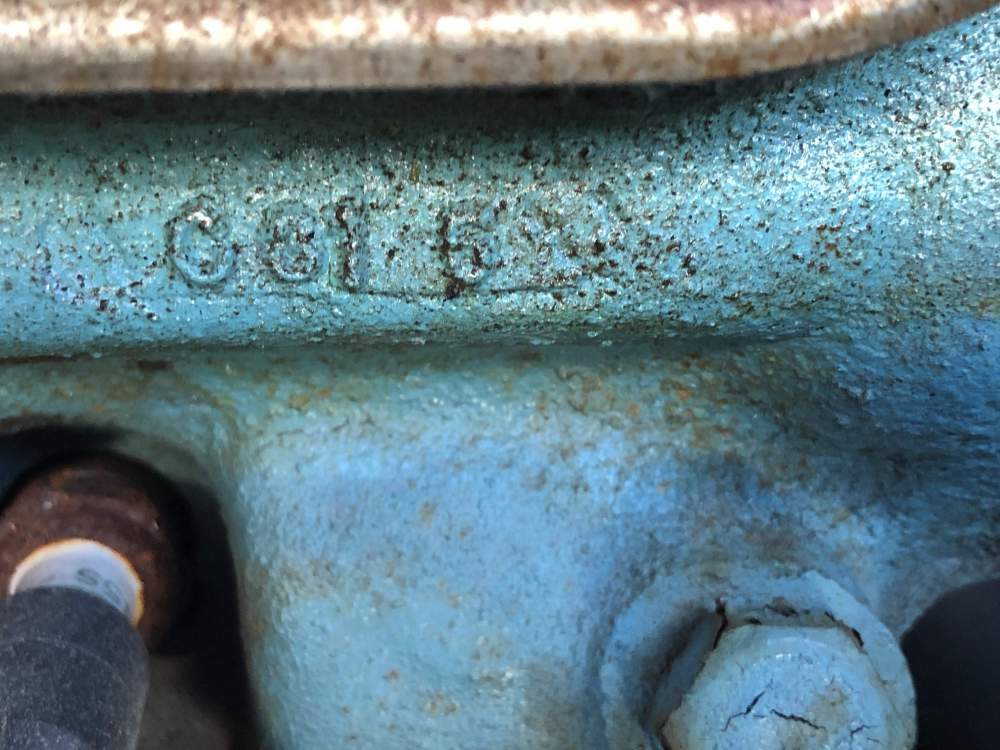

Hey Frosty this is what I have so far
Thanks for sharing Pete.

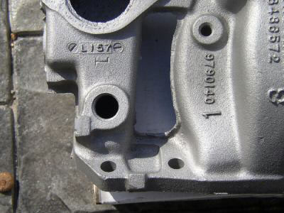

What you are showing appears to be the engine head casting number. The casting number on the intake manifold I am referring to is like in the picture below. So in this photo, the intake manifold casting number is 9790140. You are looking for casting number 521571.
