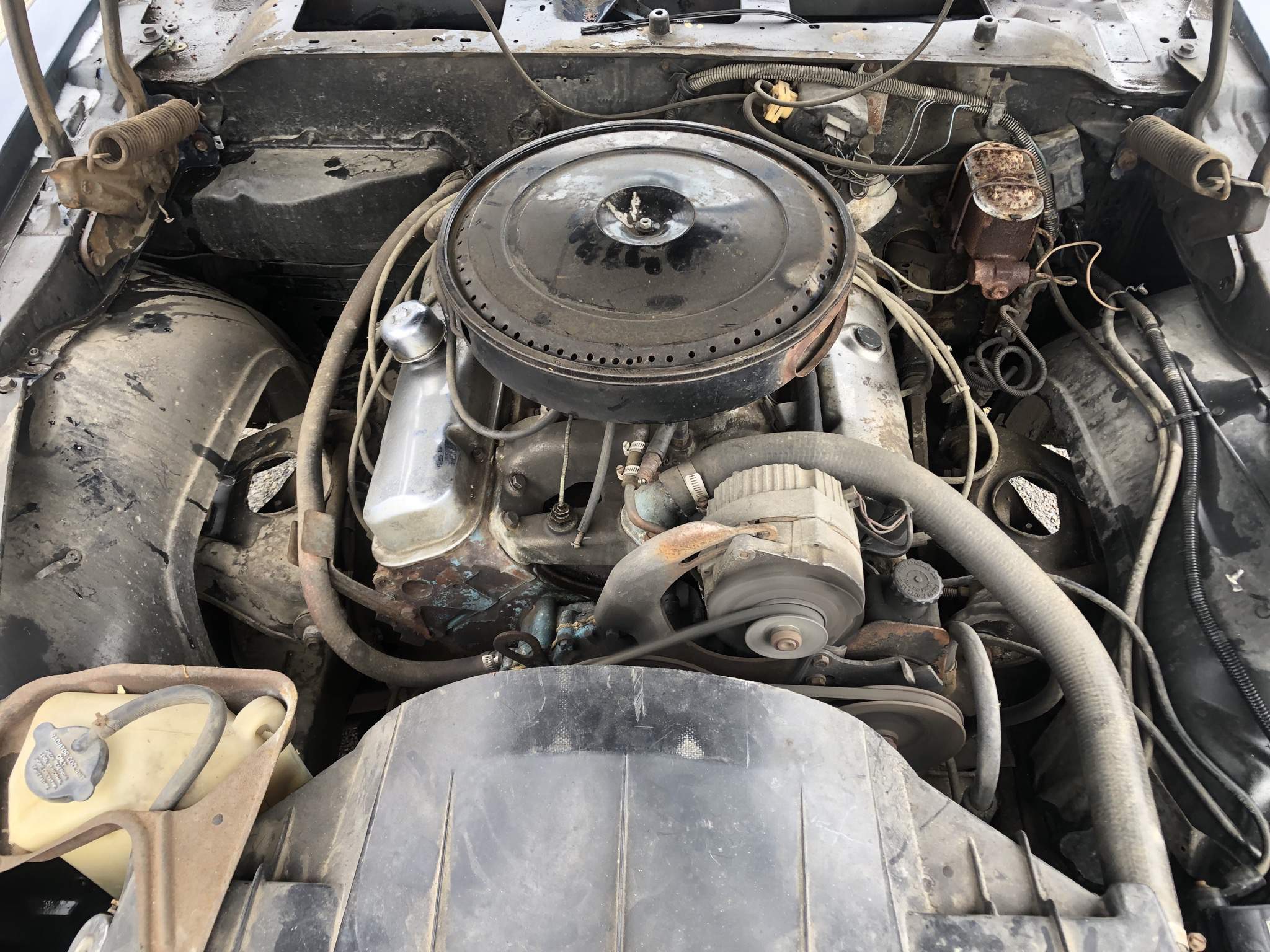

I’m trying to figure out this engine number
I was told it’s a 73 Pontiac 400 engine but having hard time decoding it

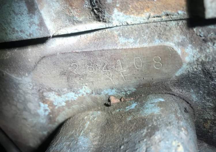

this is the number on the passenger side front engine block right below the head
282108 YE
If there’s anything else I can look at just let me know
Hey Paul, that number doesn't show up on the list of block numbers that I have. Not saying that one of the others guys cant run that one. On my 68 engine the block numbers are located on the top, back of the block right behind the passenger side head and the date code is by the oil plug on the distributor pad.
That's a 68-69 400ci

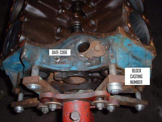

Ok so I came up with stamped in the back of the block  M226 where the date code shows in your picture
i could not find any other number
the heads are stamped GM-1 ? Any info
So looking online is this a December 22 1966 engine? Going off M226
Yeah Paul that's what I show to. M= December.   22= for the day of the month  and 6= for the year
Could it be 1976? Or is definitely 1966

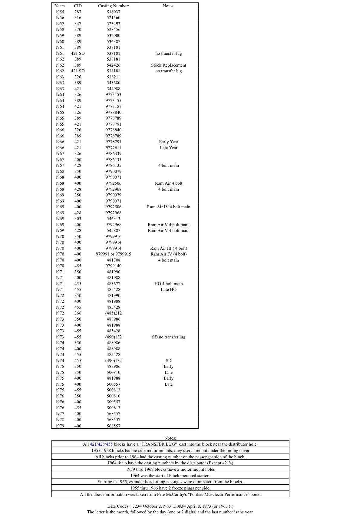

Since I don't see a 400ci listed in 66 id say its most likely a 76. Here's one of the lists that I look at. Hope it helps bro.
Not sure how clear that came out on your end Paul, but I can email it to you if you'd like.
