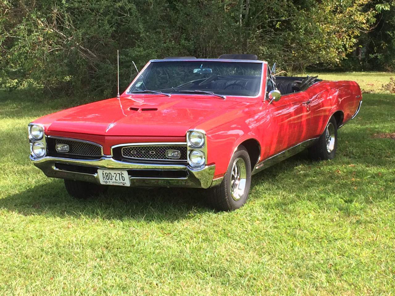

The Drop-Top shown below has the 3rd belt option on the rear seat.

Rick, Glad to help. Yes it's been years. Glad to hear you still have your '67. I still run into a few folks from the club but not many. The Drop Top Is Lois Janule's She is one of the few from the club that still comes out and plays with Pontiac's :D  I help her as much as possible to keep it rollin.   Cheers.
