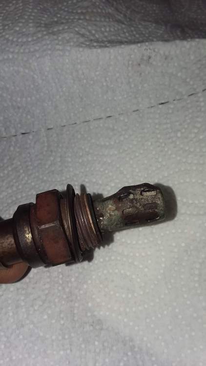

That o2 was the upstream one changed it two month ago w downstream
