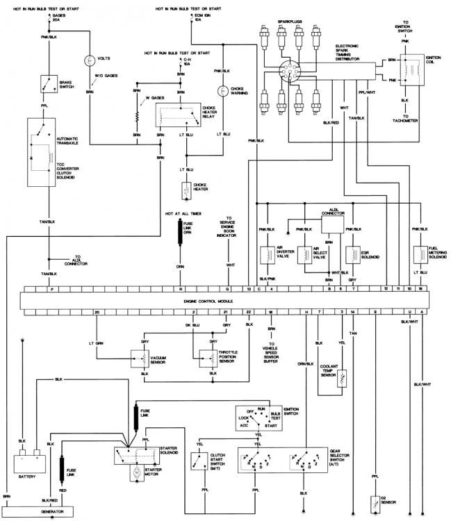

Here is the major wiring diagram for an '82 V8 Firebird. I think this will probably help.
So is there a back up to the column? Because after disconnecting each harness I can still start the car. (Again it's an intermittent problem and I found a position on the tilt it'll work so leaving it that way until I find the harness.) There are 2 major harnesses down there I've disconnected, if it's supposed to be there and it's not it has to be bypassed. I've worked on engines for fun for a while, wirings a whole other bear apparently. So look in the shifter console?
