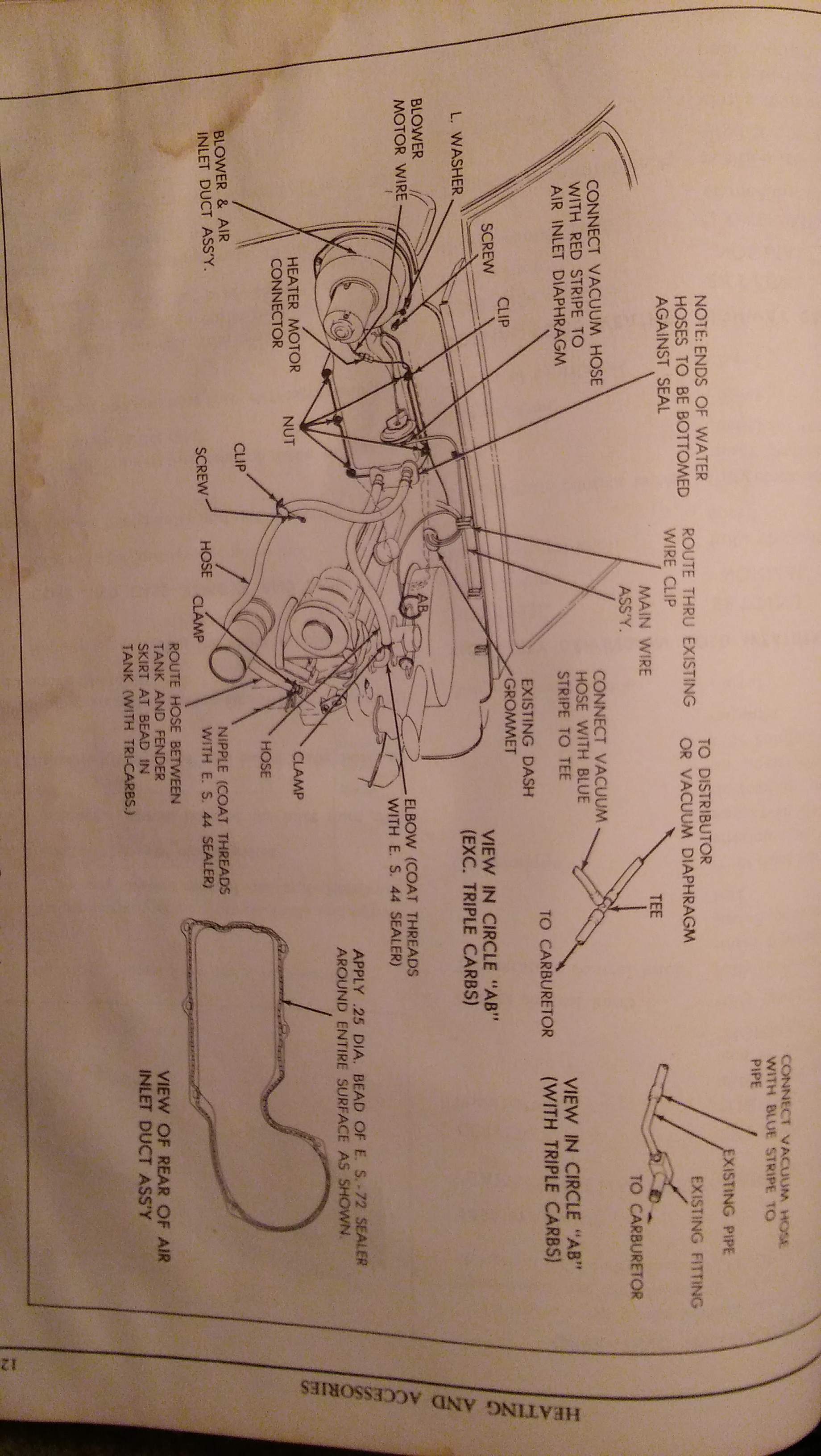

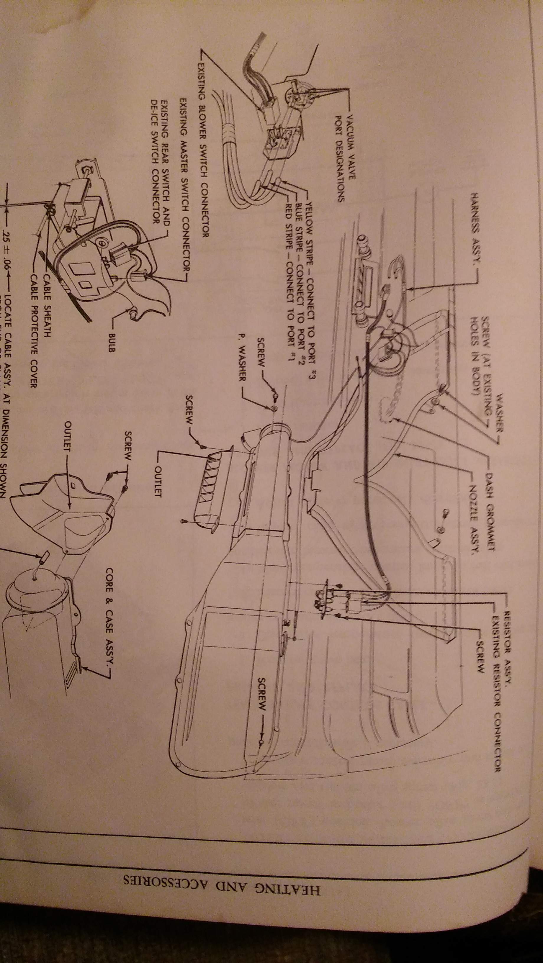

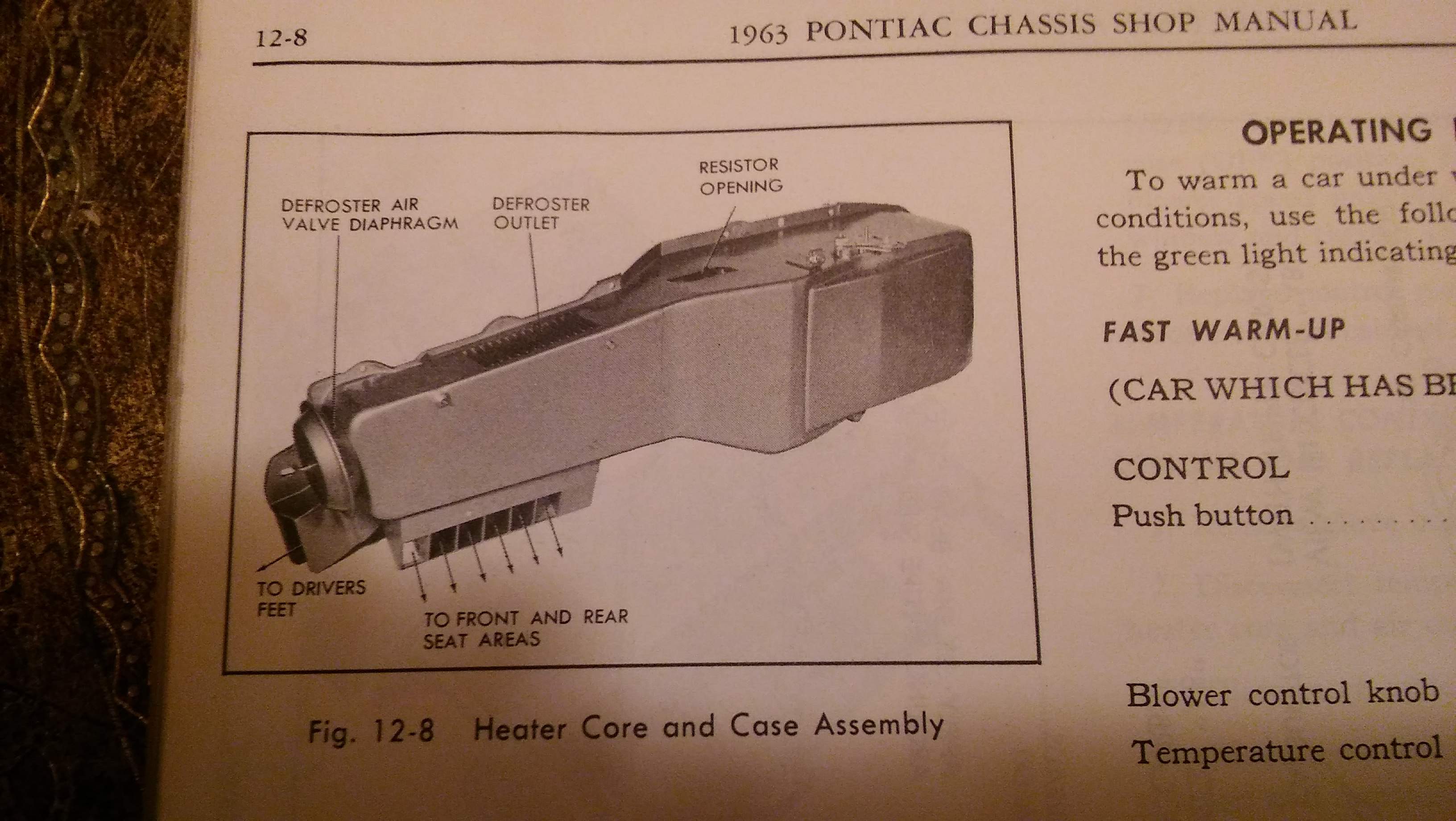

Okay, need to replace heater core on my 64 Bonneville w/air how do I get it out ??
Thanks, Wayne
These are actual GM Pontiac service manuals....Not reprints....
Hope this helps

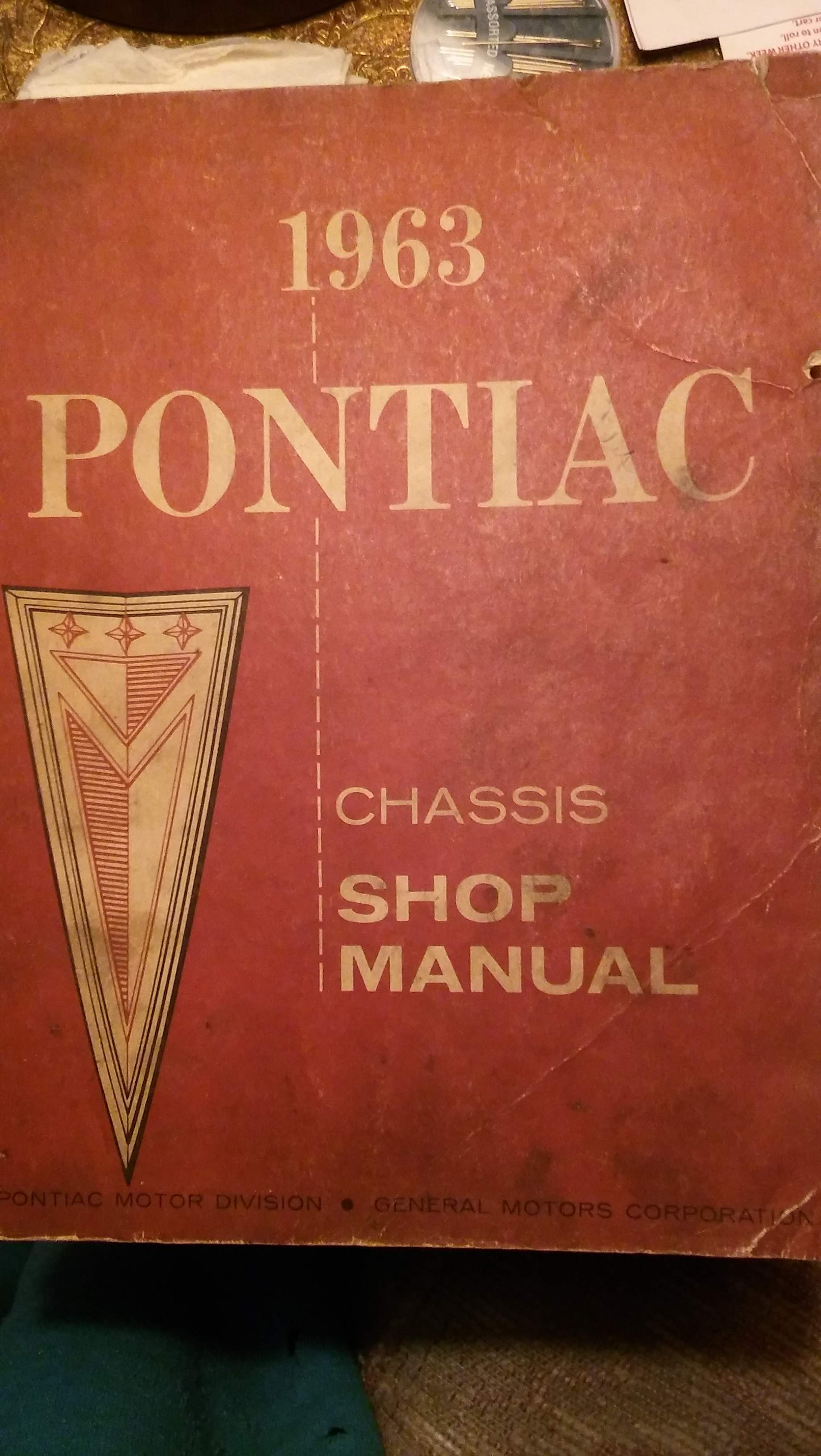

Thanks for the input !! I have the 64 manual, but will order the 63 manual as it gives more detail !!
Wayne
