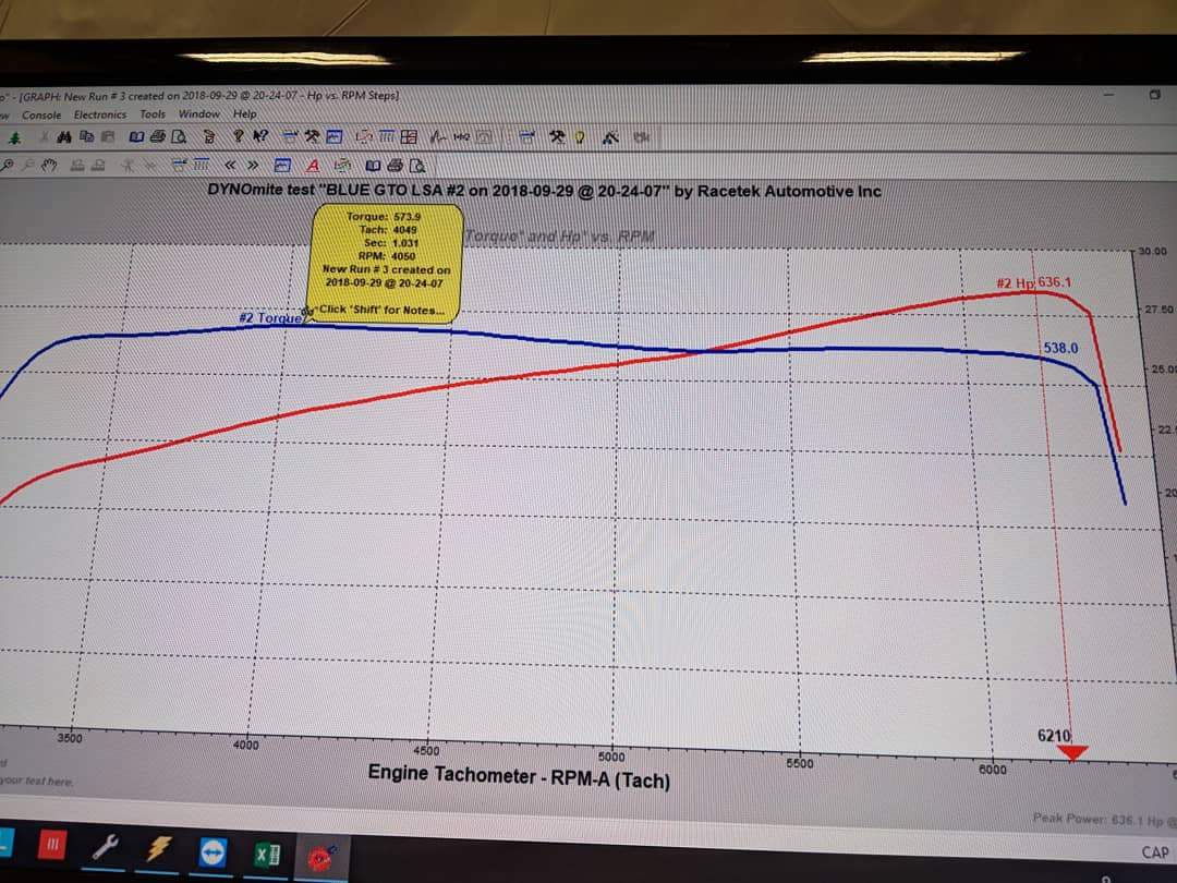

I finally got the LSA kit from Boostdistrict on and tuned by Brewer Speed and Racing here in Columbus, GA. Woah buddy is this car a blast to drive. These cars should have come from the factory supercharged.

Just like the title says, it dynoed at 636rwhp and 573ftlb
42863360_340457683376574_4810272678990577664_n.thumb.jpg.9433eb259ccbc77396438f87af8c62b3.jpg
That's quite a lot of power!
And I love it! The rear tires not so much
