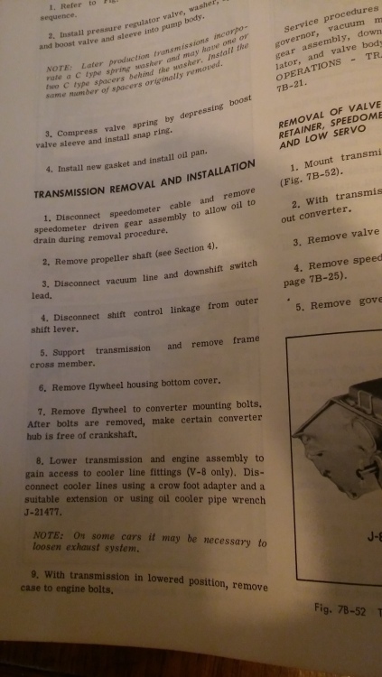

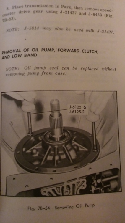

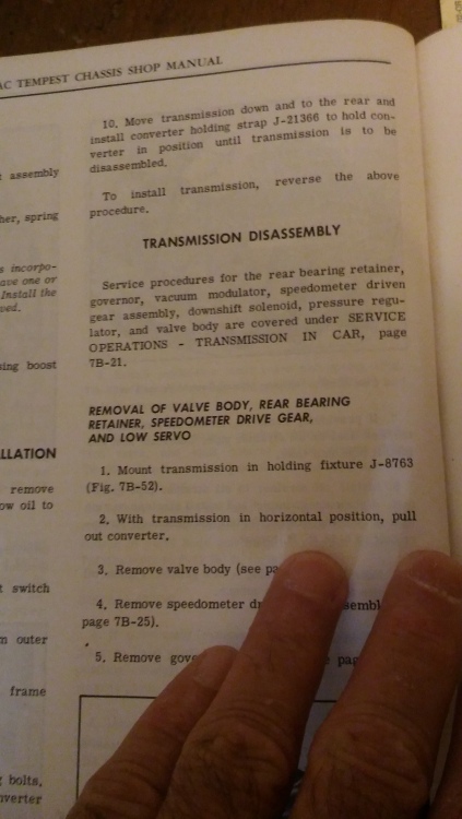

Probably front pump seal...Hope this helps
0424171342.jpgProud
This manual is the one actually put out by Pontiac Motor division. 100% sure it is accurate..... after removal from car just slide torque convverter out..No further disassembly required...can use seal puller  to remove seal from front pump... No need to remove front pump .From trans .Just make sure torque converter is slipped in properly...(will feel it drop into place) before putting back into car....

Two Lane,
Appreciate the quick post and guidance!  That looks fairly straight forward, even for this Air Force veteran (saw you were Navy) and thanks for your service.  I will change trans fluid while I am at it...torque converter too?  Assume any local auto parts store would have the seal?
Mike
Mike G
Don't know if the front pump seal would be available at local autoparts store. They used to be years ago. Might have to procure one from another source..While have apart might as well replace the seal at the rear also..Where the drive shaft yoke goes into the trans. As far as the torque converter goes. If the hub where it goes thru the seal into the pump doesn't have excessive wear from contact with the seal.. It will probably be OK. The trans internally is the same as a Chevy Powerglide. Only the case is different..Seals should be the same..Thank you for your service also..Let know what happens....One Other thing make sure to lube new seal with trans fluid before reinstalling converter.,
