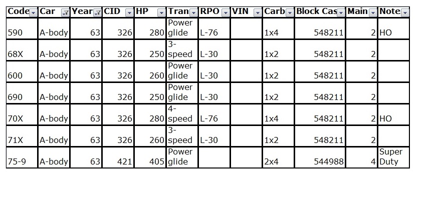

Here are the block codes and casting numbers for all '63 A-bodies.
2 Lane Blacktop, these are the #'s on front of block- on top is 600 just below is 276465 lower down is 263P below this is 124311. On right block side is GM 548311 also has pyramid by distributor hole. This should be a 326, did they have both 4 bolt and 8 bolt water pumps? All the local auto parts show an 8 bolt pump, but the existing pump is 4 bolt. Thanks,Ron

#600 = 326 CID with 2 bbl carb rated 260 horsepower with powerglide trans. RPO L-30. 548311 is casting #   276465 is production # of engine....should match VIN if original...Frostys chart above matches the same info I have. Sure it is accurate...
