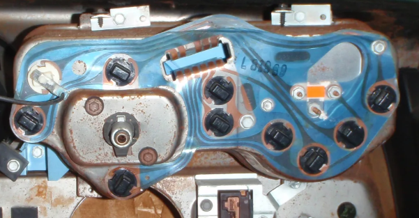

turn signal works but indicator doesn't light up the left one does not the right replaced the bulb it goes into a piece that you turn to remove from dash then put it back in back of gauge I guess it has contacts inside for power any way to test it?
There are bulbs for the turn indicator mounted in your gage cluster. I suspect the bulb is burned out. It is either a 168 or 194, I don't remember off the top of my head. It will say in the owner's manual.. Worst case scenario is the plastic ribbon circuit that is on the back of the cluster assembly (shown below) is damaged/rotting/broken contact. That happened to me and I had to replace it with a new one. While I had my cluster out, I replaced all the incandescent bulbs in the dash with LED equivalents.
