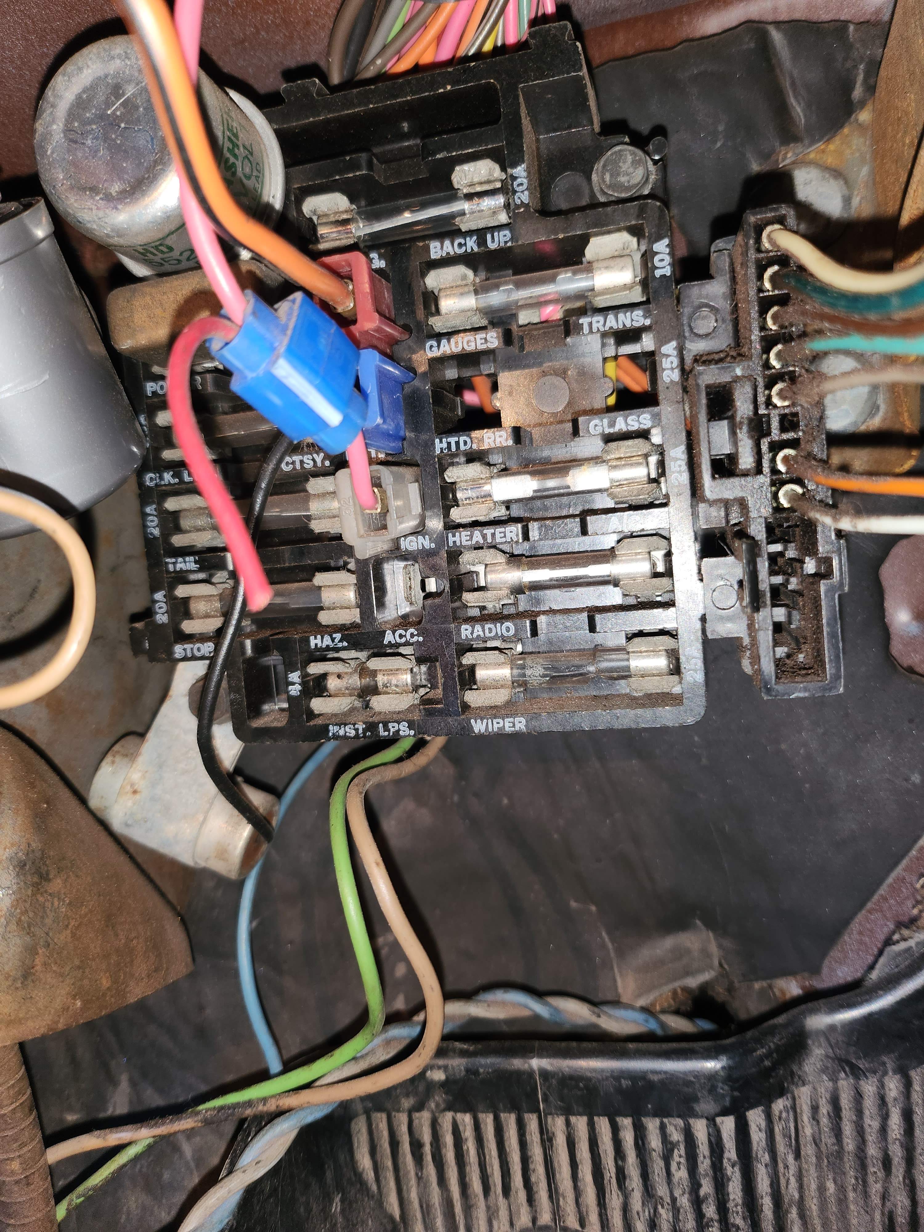

The passenger window doesn't go down either. This is what the fuse box looks like, a little hard to read. I don't see a fuse that says anything about windows but could it be a fuse under Power and Accsy? (Located left of the 3 wires plugged in)

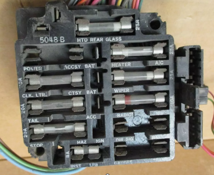

The power windows should run through the Power Accessory fuse. It should be a 20A or 30A fuse. In the picture below, it is the fust that is missing at the upper left corner. There should be a wire with a plug that is plugged into the ACC blade in the middle of the fuse block. This should supply power to the window switches.
