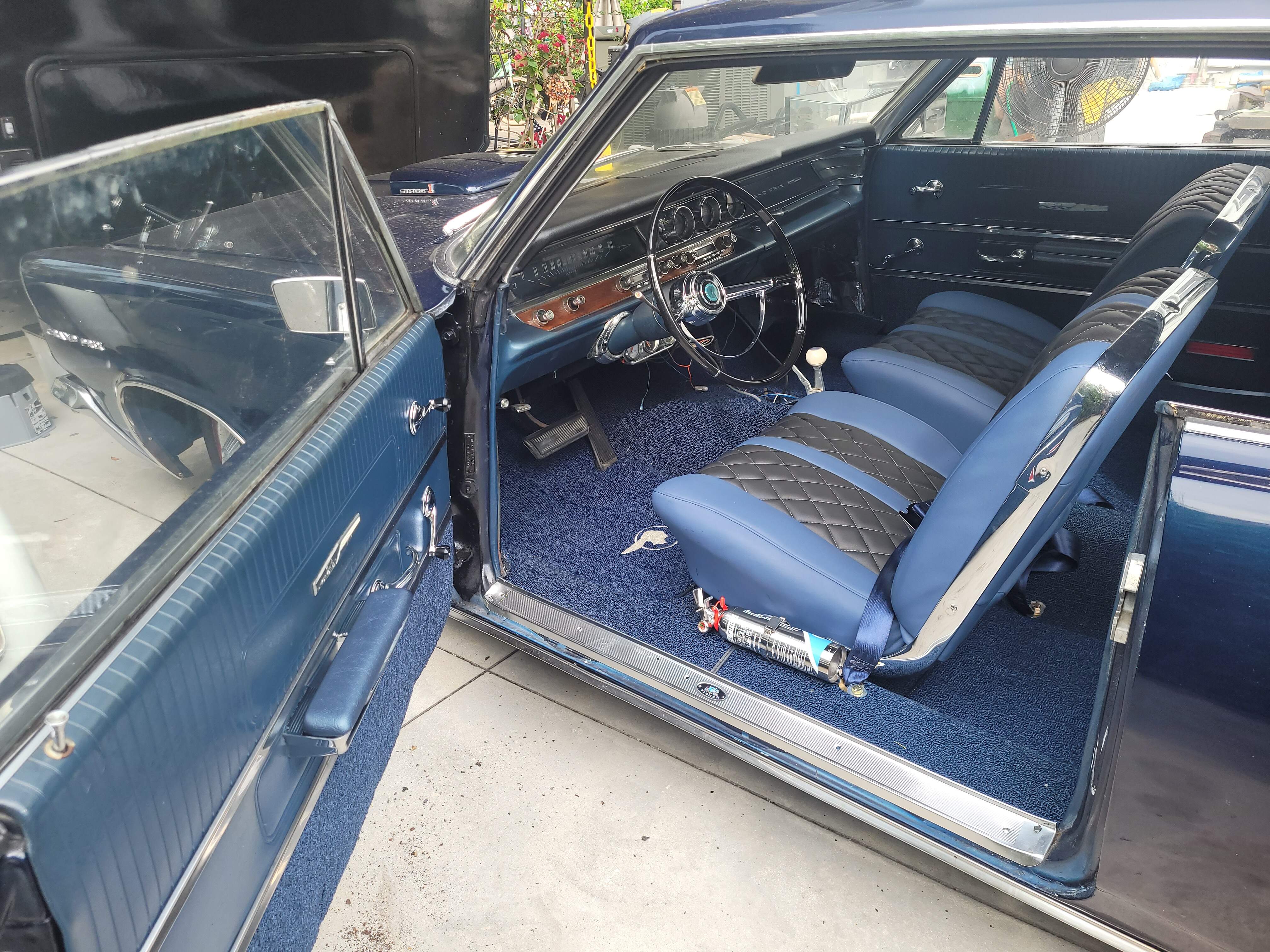

Thanks bro. Right now the seats are the original 1963 white interior. I have charged out the red carpet for black and painted the dash to match the body color.

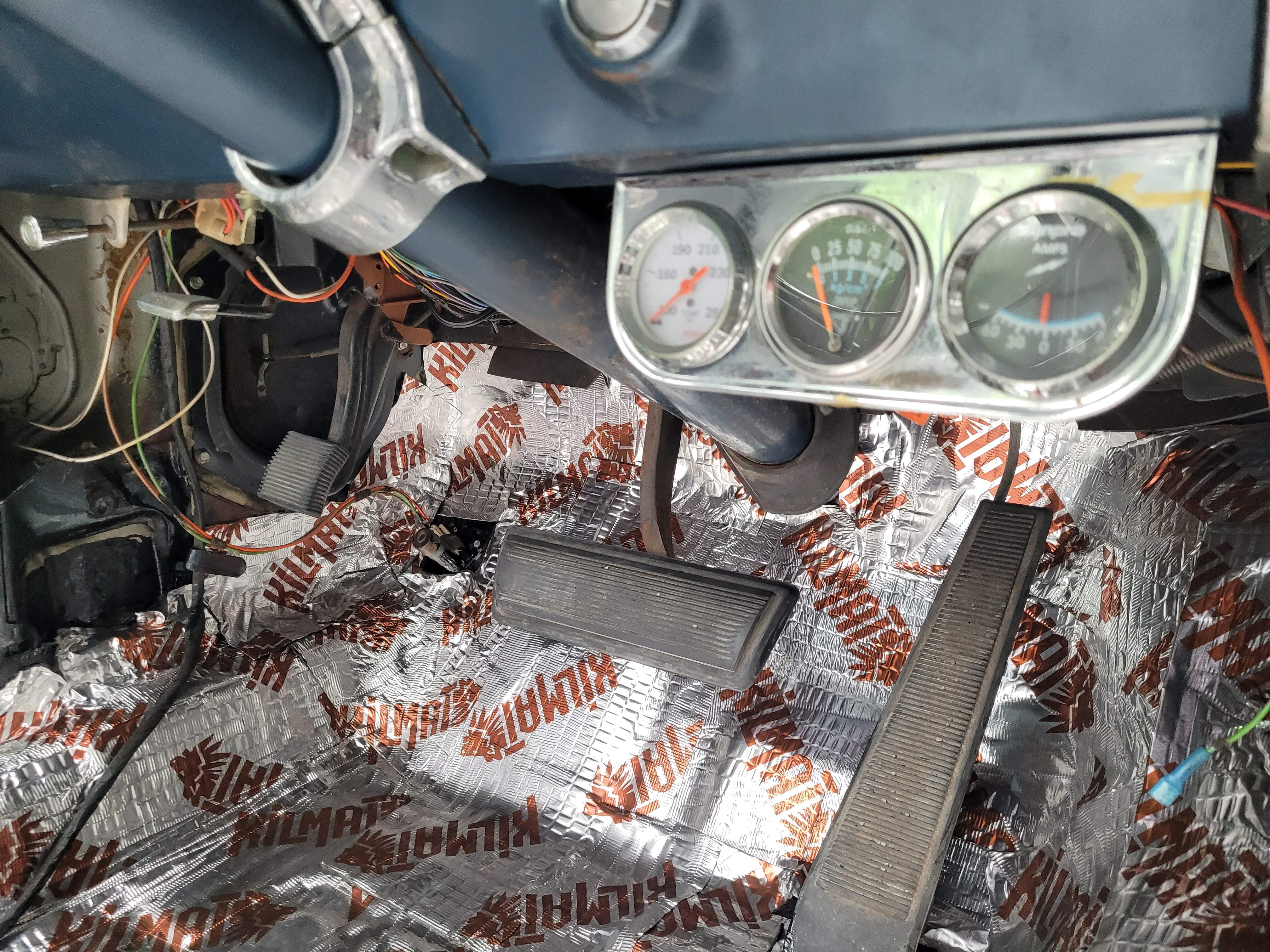

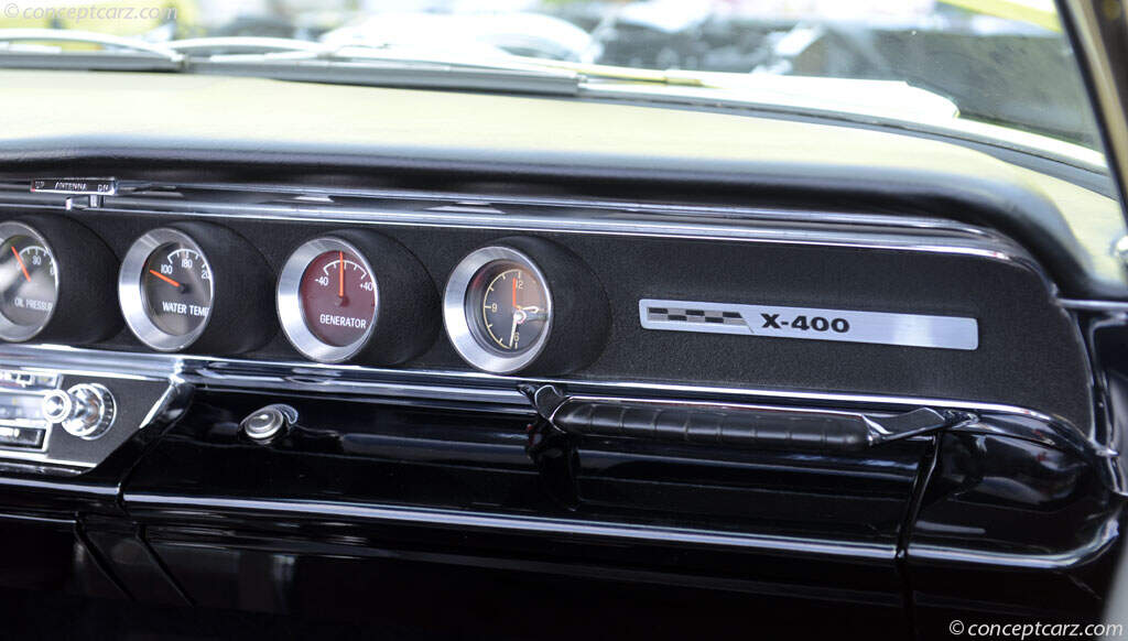

It looks great i need to move my gages to the same location I hit my knee every time where they are now... I bought the individual cups for it but your setup looks really clean... how did you hide the back of the gages / wires & hoses, when you look from the passenger side? Here is where my are now... I also need to move the FM receiver from the passenger side it looks out of place... Do you guys know if that is a dealer installed option and is that the location they were all installed? I was thinking about installing a headless media center but keep the original radio and fm receiver in working condition as well...

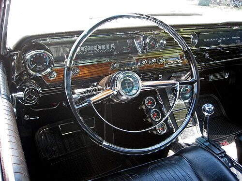

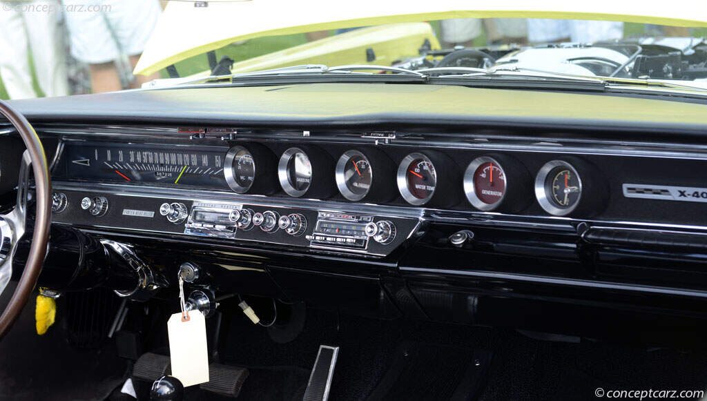

Here are some other ideas I found online for the gauges... Not my cars I found these pic online...

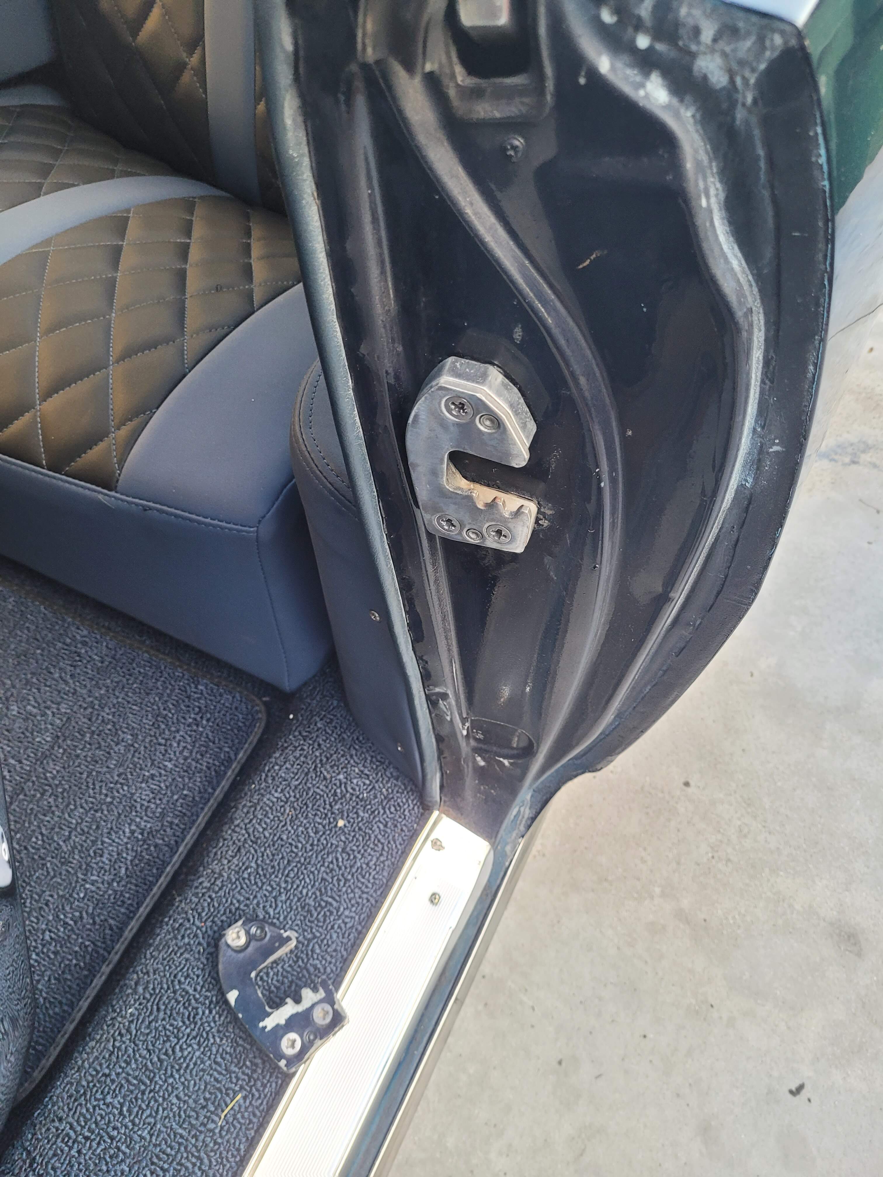

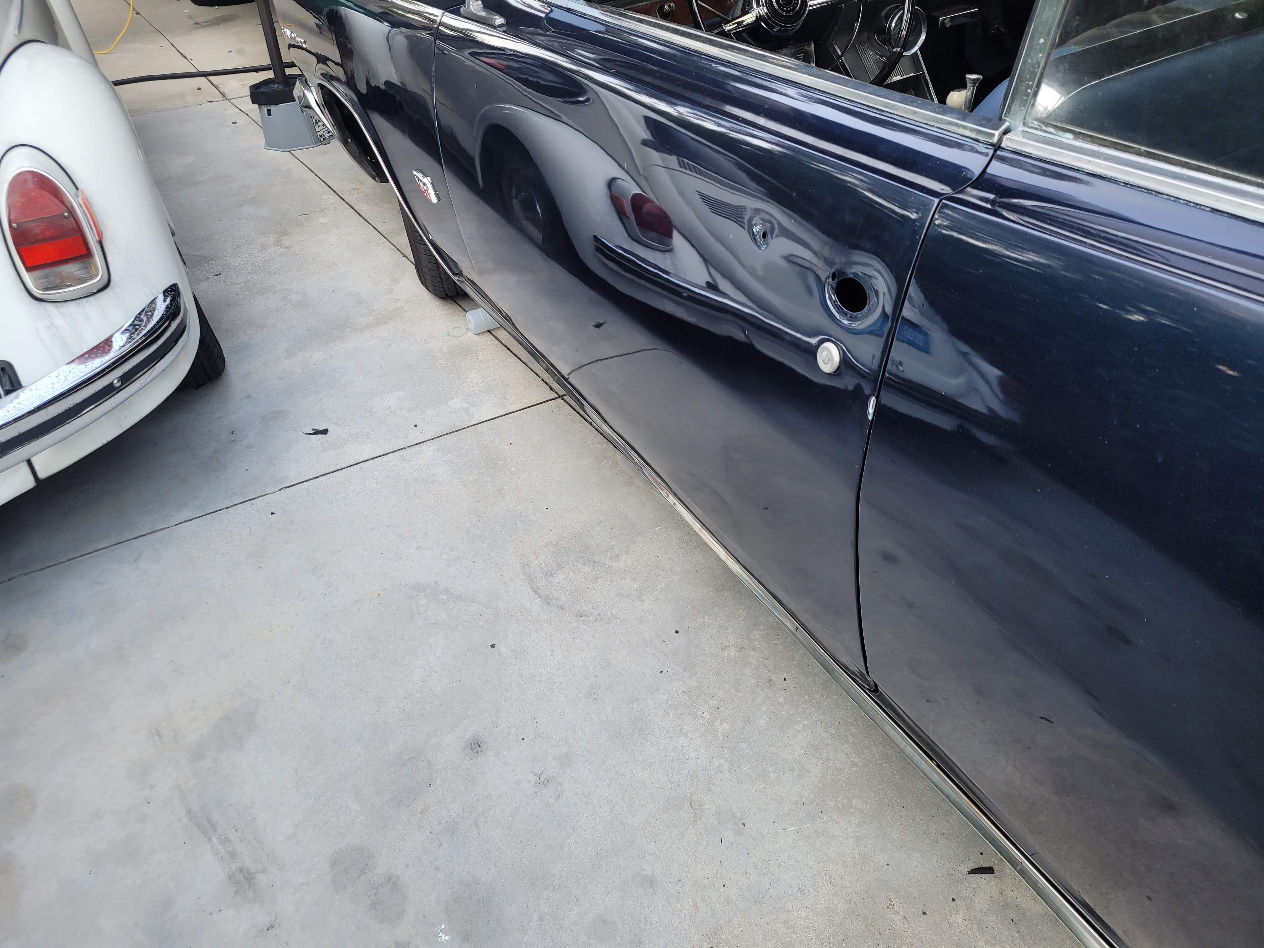

    Thank you, I was working on it today with the guy that took it apart, it looks like the interior handle had to be adjusted to stop pulling on the latch mechanism that stopped the cog from moving freel

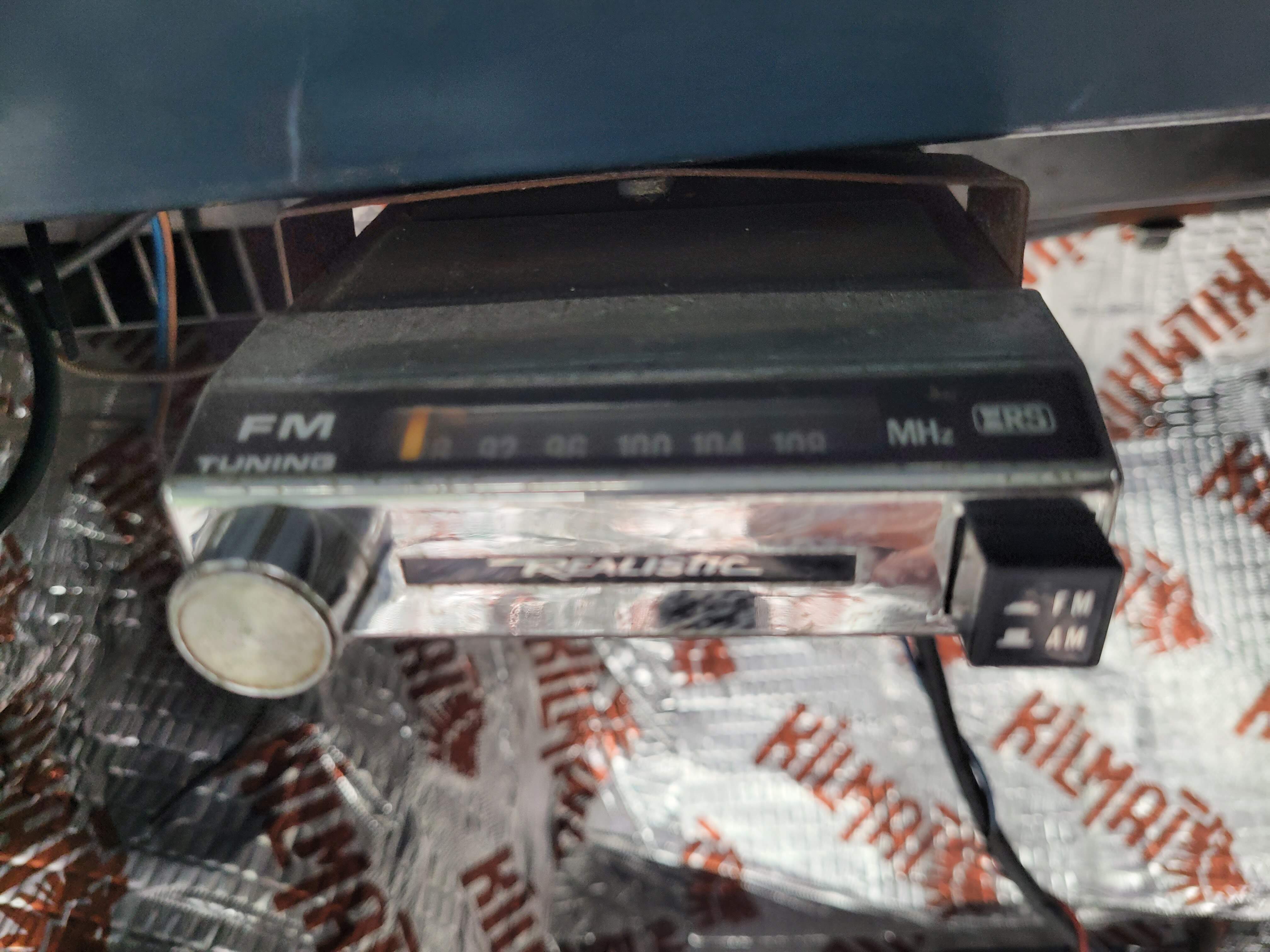

The FM reciever is not factory/dealer installed...it is an Aftermarket unit...The Realistic brand name is From Radio Shack... (Remember them...??)....Probably from the late 1970s early 1980s...
Remember them! I had one back in high school! It was a cheap and easy way to get FM when all you had was am AM radio in your car! Then I figured out getting a factory AM/FM or an AM/FM 8-track radio out of a junkyard was easy and relatively inexpensive.

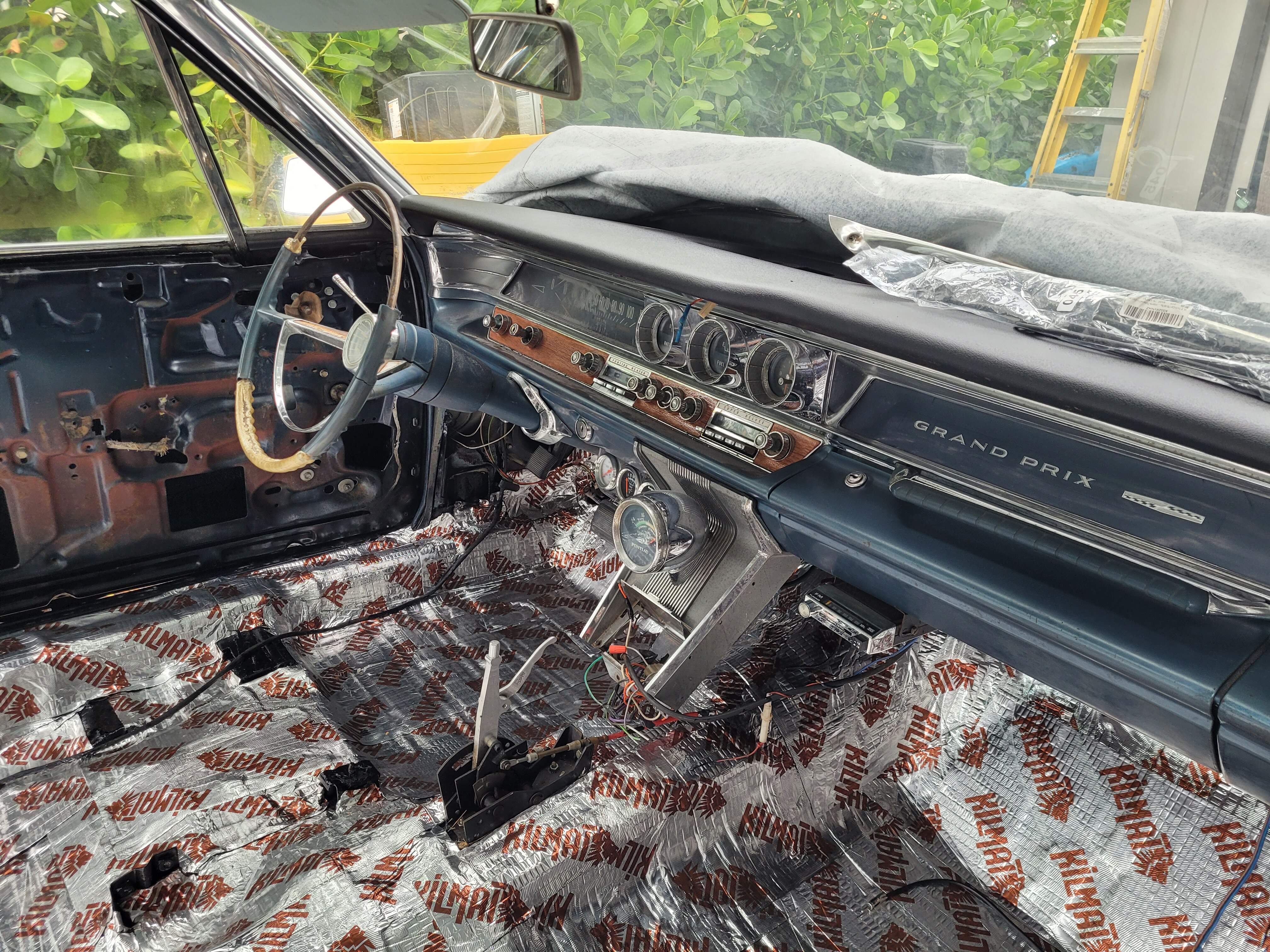

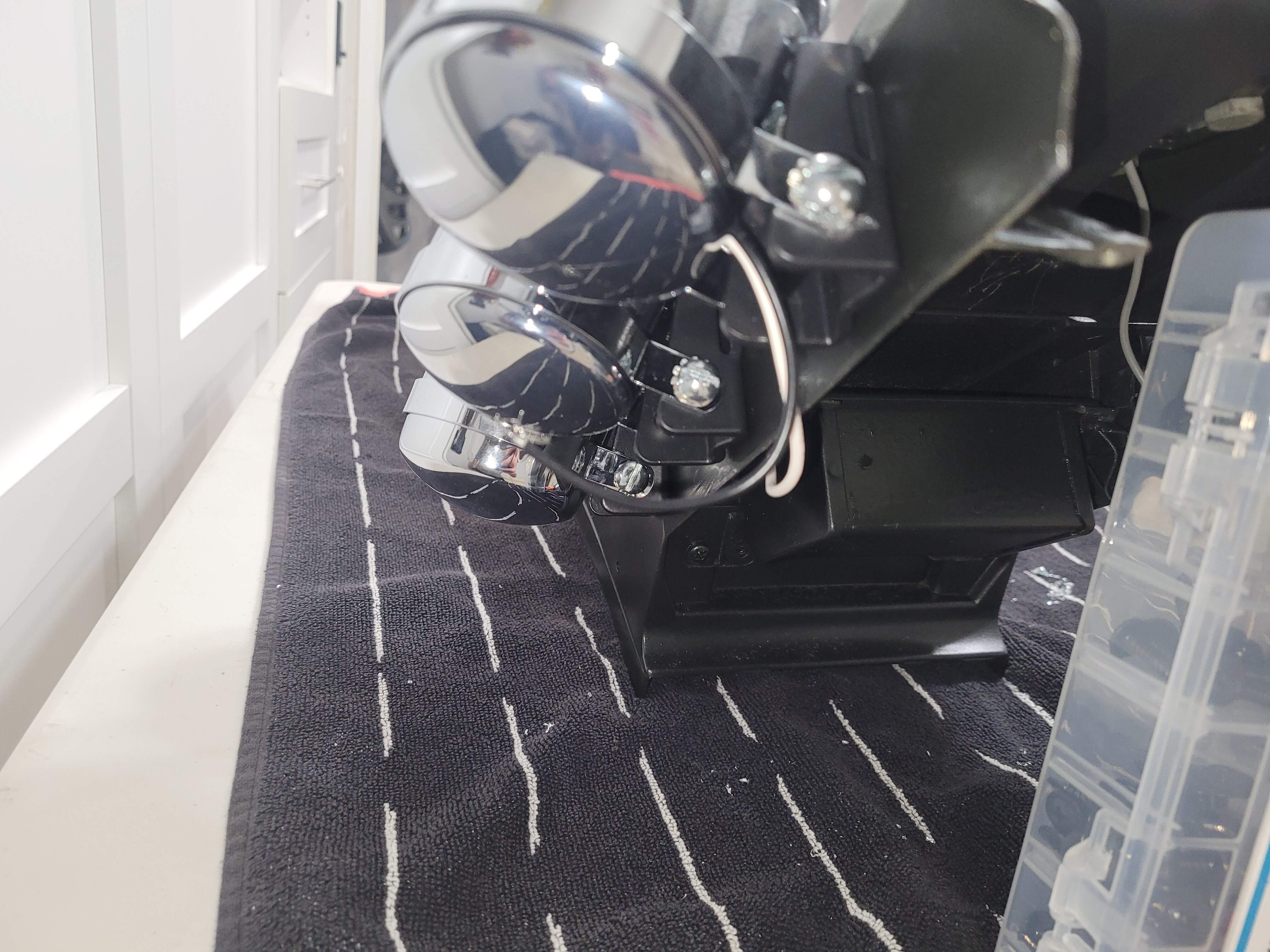

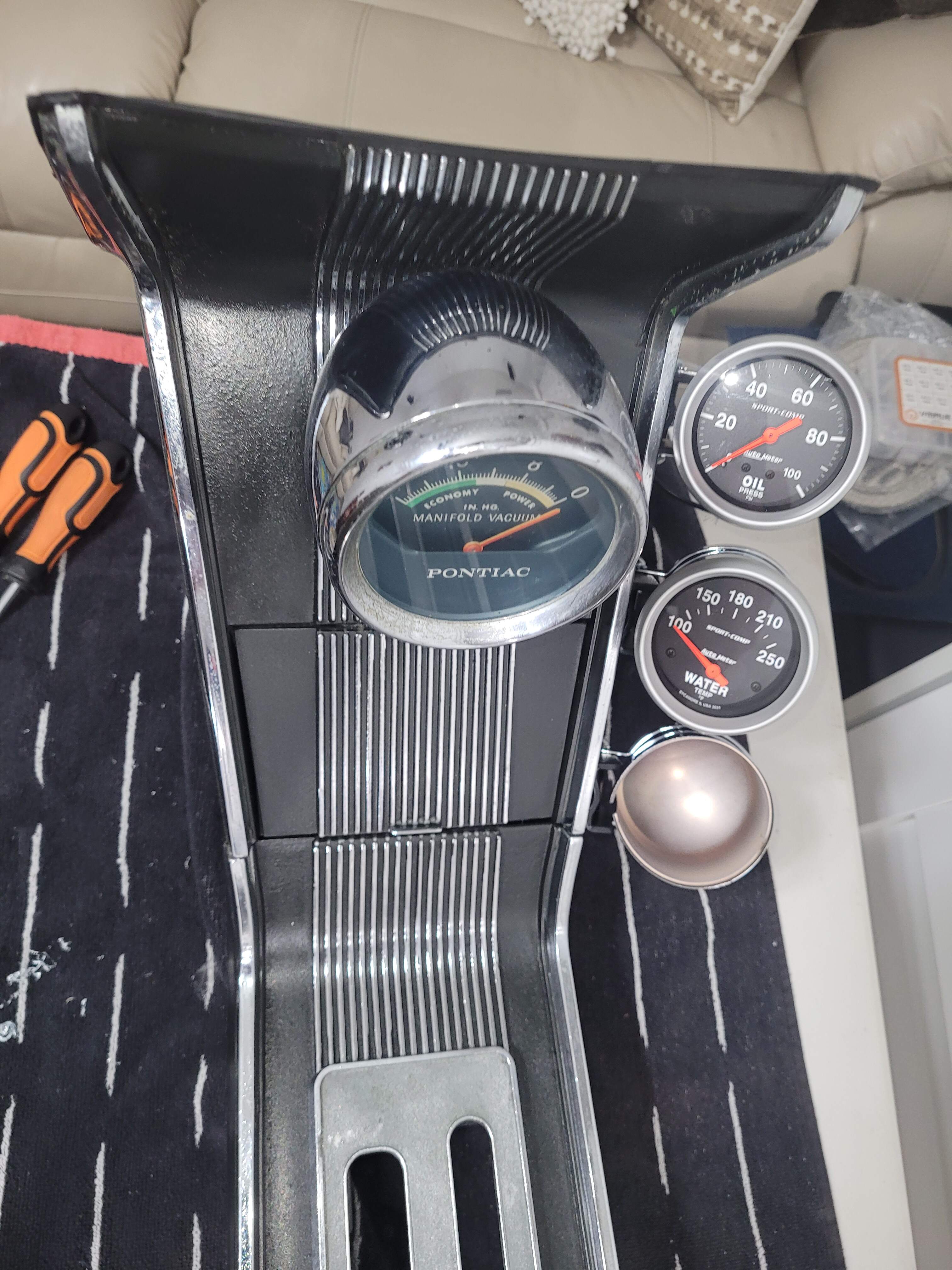

So the only way I could find to hide the wiring, oil line and coolant was to run them up the top part of the console then zip tie the wires together. When I rewired the car the Painless harness I used did not come with the wiring for the console. I knew I was installing these gauges, so I built a harness for the console with those wires included. The oil line and coolant lines also go up the console to the firewall and out to the engine from there. I went with the 2 & 5/8 " gauges because I thought it looked more at home and old eyes can see them easier.
On a personal note, if you are going to run aftermarket gauges in anything, I would highly advise upgrading to the copper line for the oil gauge. You can get it from any auto parts store. It's much more durable and have I personally had the plastic line explode while driving. Running along about 80mph, gauges mounted to the A-pillar and shot hot oil on the inside of the windshield. It was a mess! I haven't run a plastic oil line since.
Thank you for the heads up on the plastic line... I am going to install all new autometer gauges on it. I think oil pressure gauge has a plastic line, I will for sure replace it. The only gauge that is not autometer will be my AFR gauge...

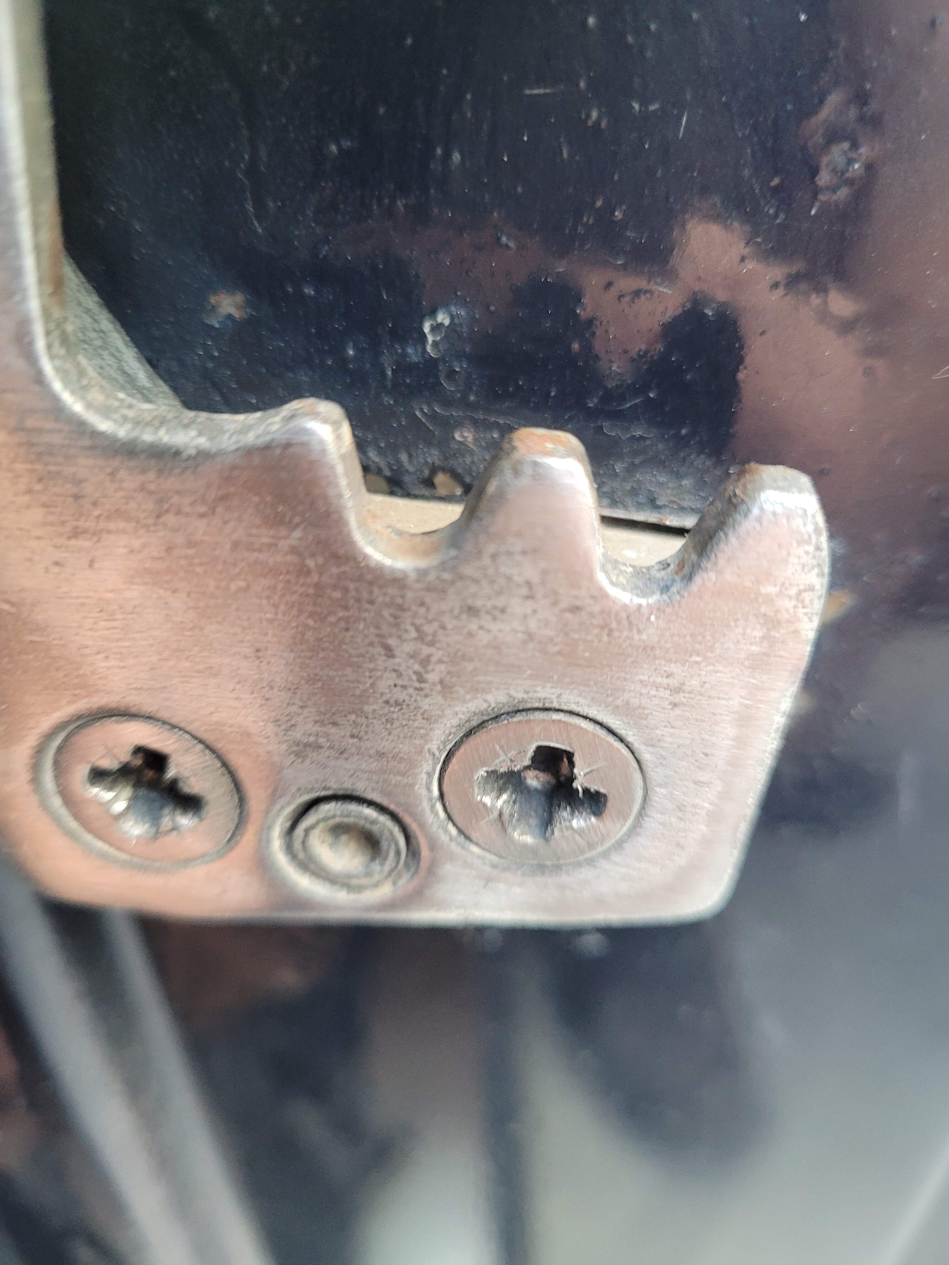

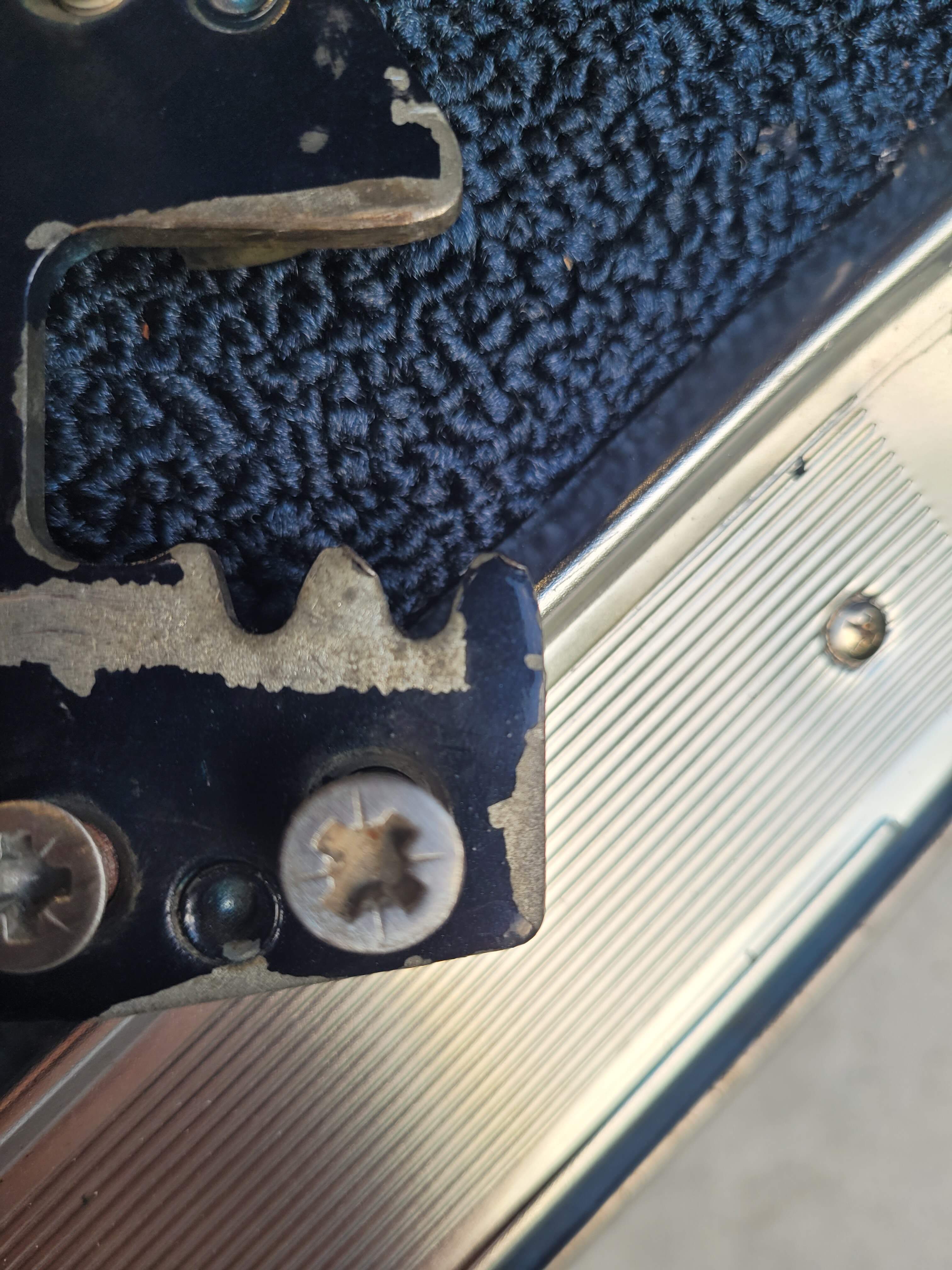

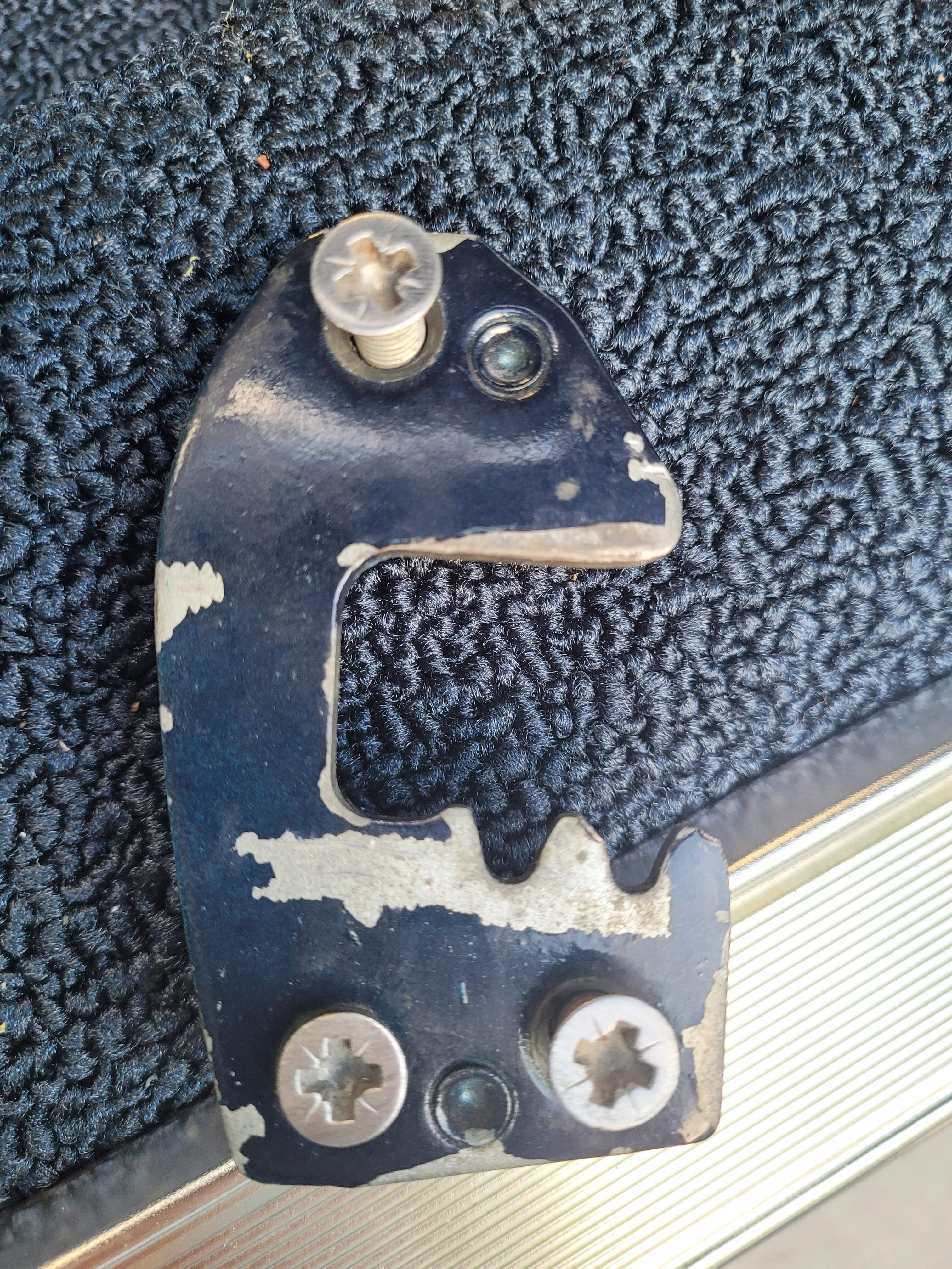

I am going to receive the new striker tomorrow, do you guys know if I remove all 3 screws from the striker will the back plate stay in place or should I leave a screw to hold it?

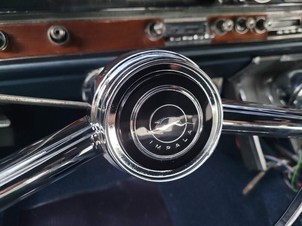

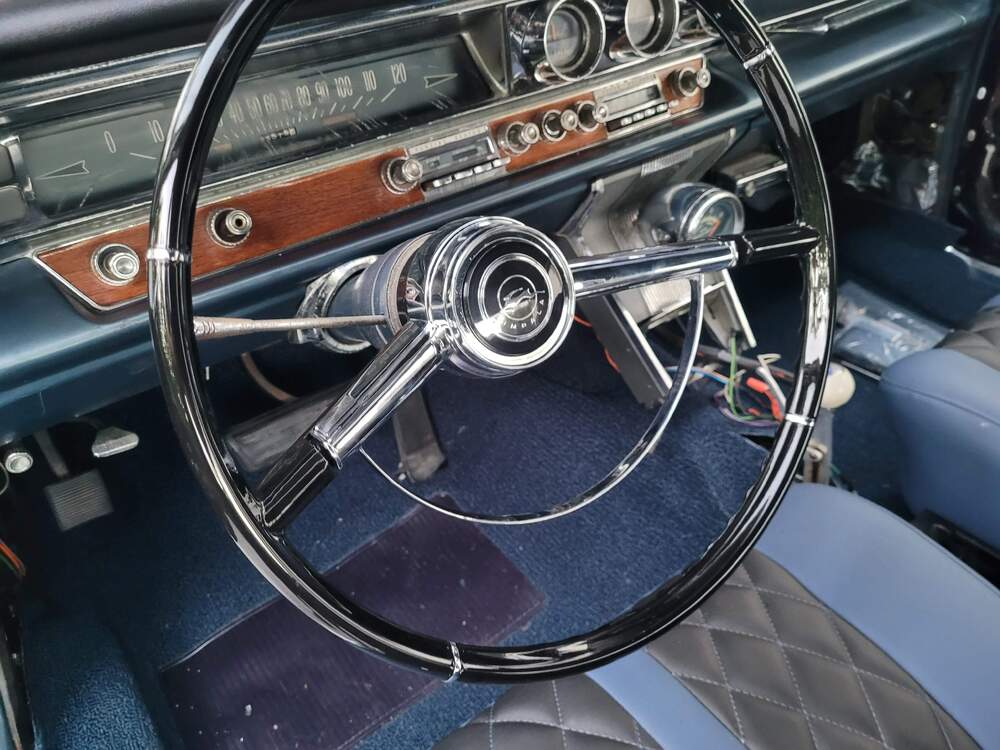

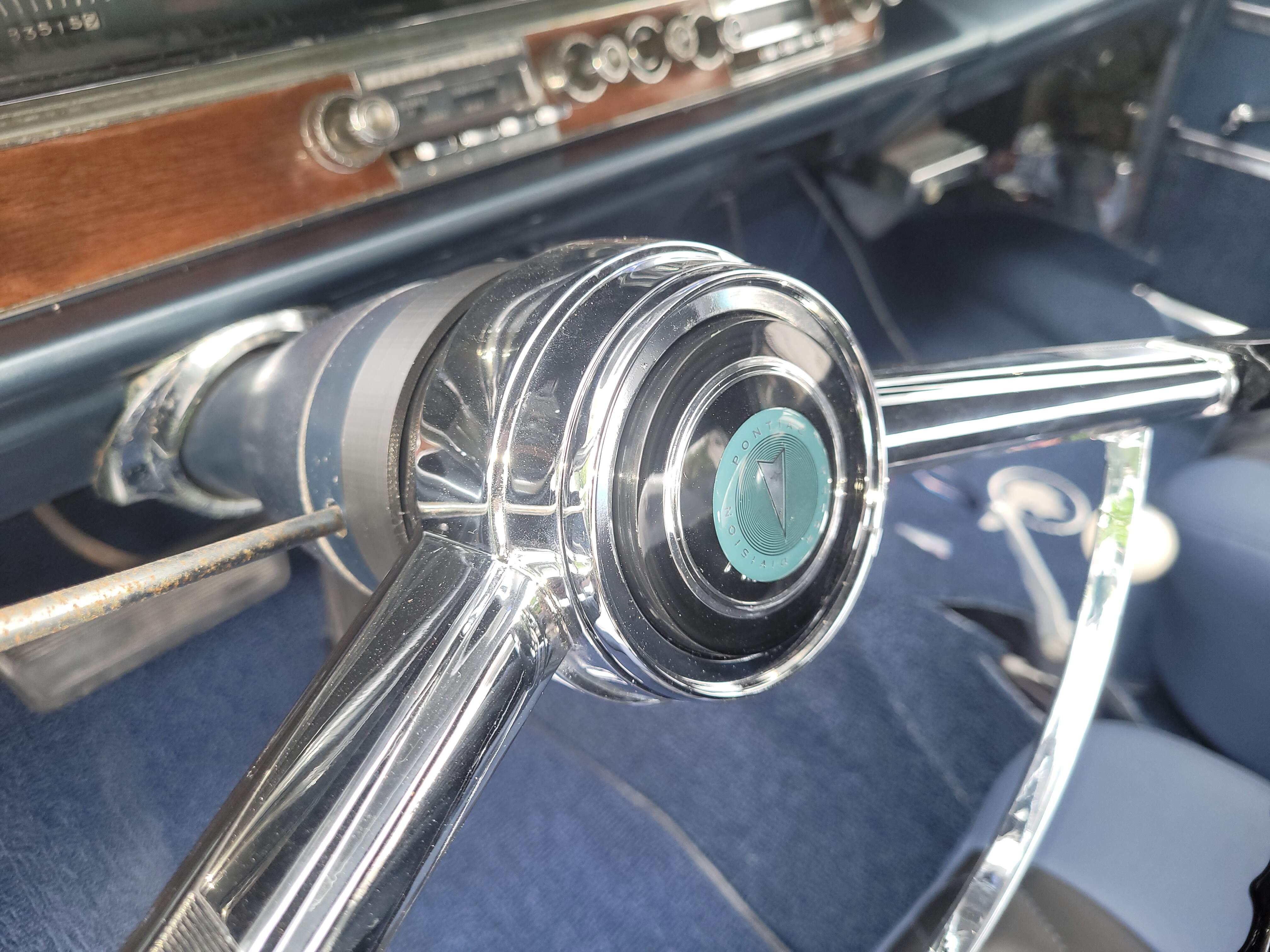

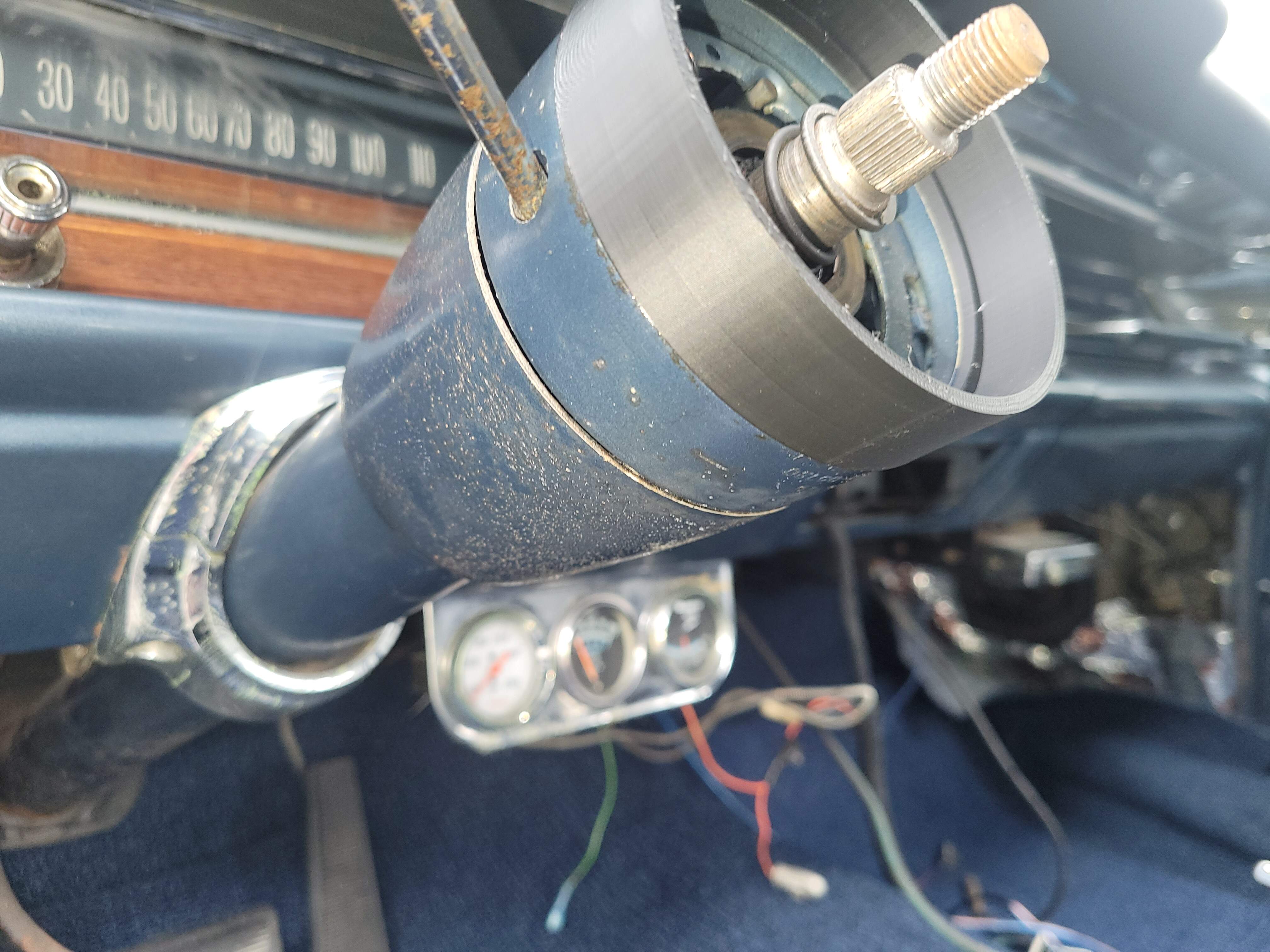

Also I installed the new IMPALA steering wheel, I ordered a Pontiac round logo that I will glue on top of it...

The plate is caged
so your safe as :cheers:

Thank you 64 Kiwi, I got it from Amazon, and the center cap + horn assembly from summit racing.  The cost for all 3 parts was around $400
Was that a brand new wheel or second hand ?
Brand new 64 kiwi
https://www.amazon.com/gp/product/B00513S1FW/ref=ppx_yo_dt_b_search_asin_title?ie=UTF8&psc=1
https://www.summitracing.com/parts/GMK-4031-542-665
https://www.summitracing.com/parts/OER-3841275

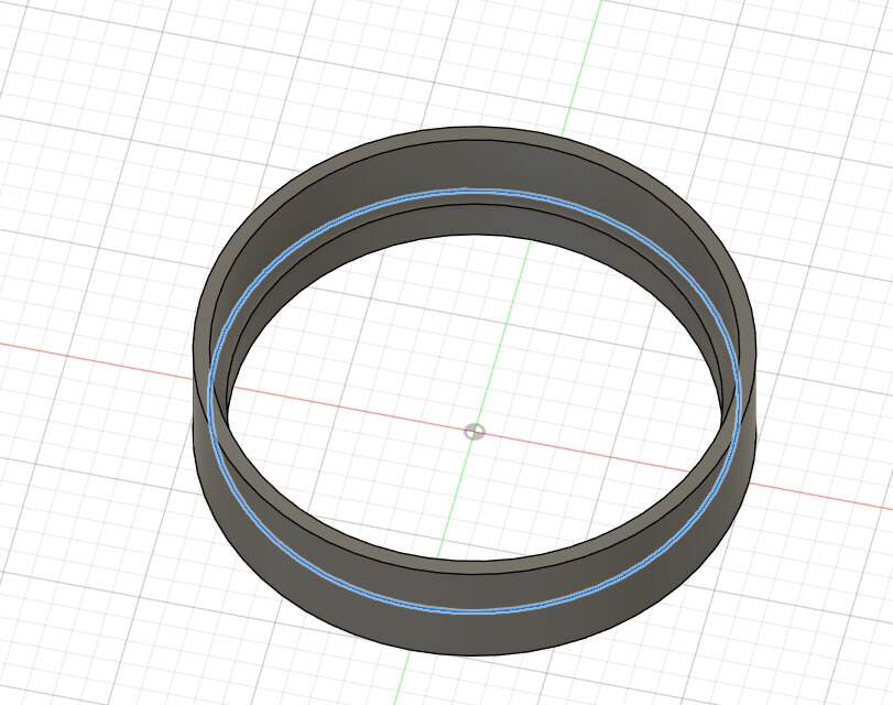

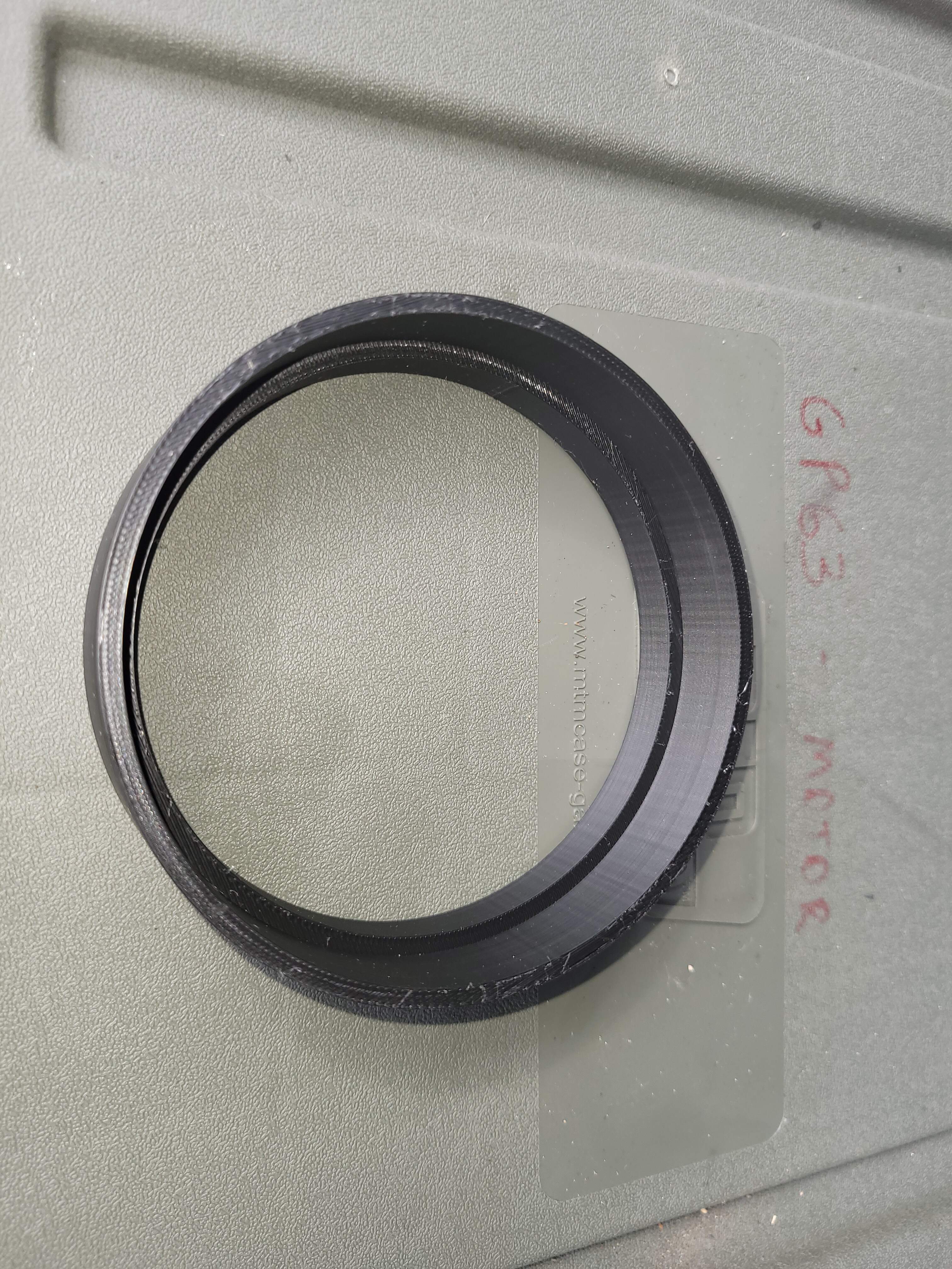

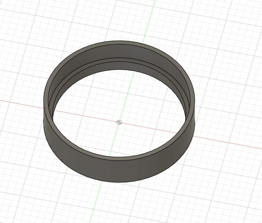

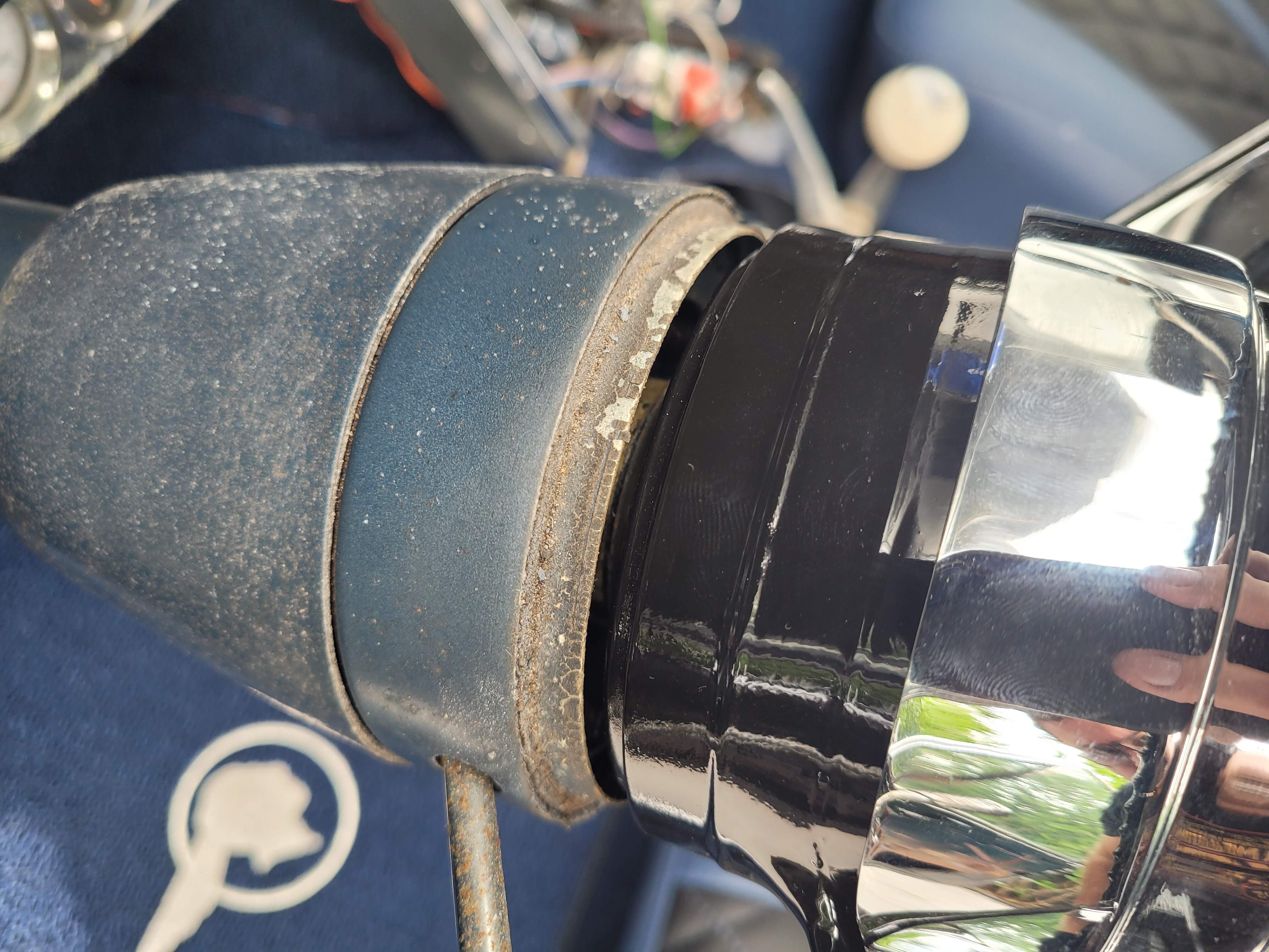

the brand is OER, I was surprised by the quality it is really nice, and it fits nice as well... the cup circumference where it meets the steering column is a bit smaller than the original, and the gap is bigger... I will send you a picture of that area later on today..  They have in black, blue and red... I did not order the blue because I was afraid that the color would be off.
I just wanted to thank everyone that helped me in this thread!!!!!
The problem is finally solved!!!!! It was the striker the "new" replacement just arrived today and after installing and adjusting it's location the door works perfect now....
I can finally finish installing my door cards now, I still have a trunk full of parts but little by little I will have it ready to cruise again soon....

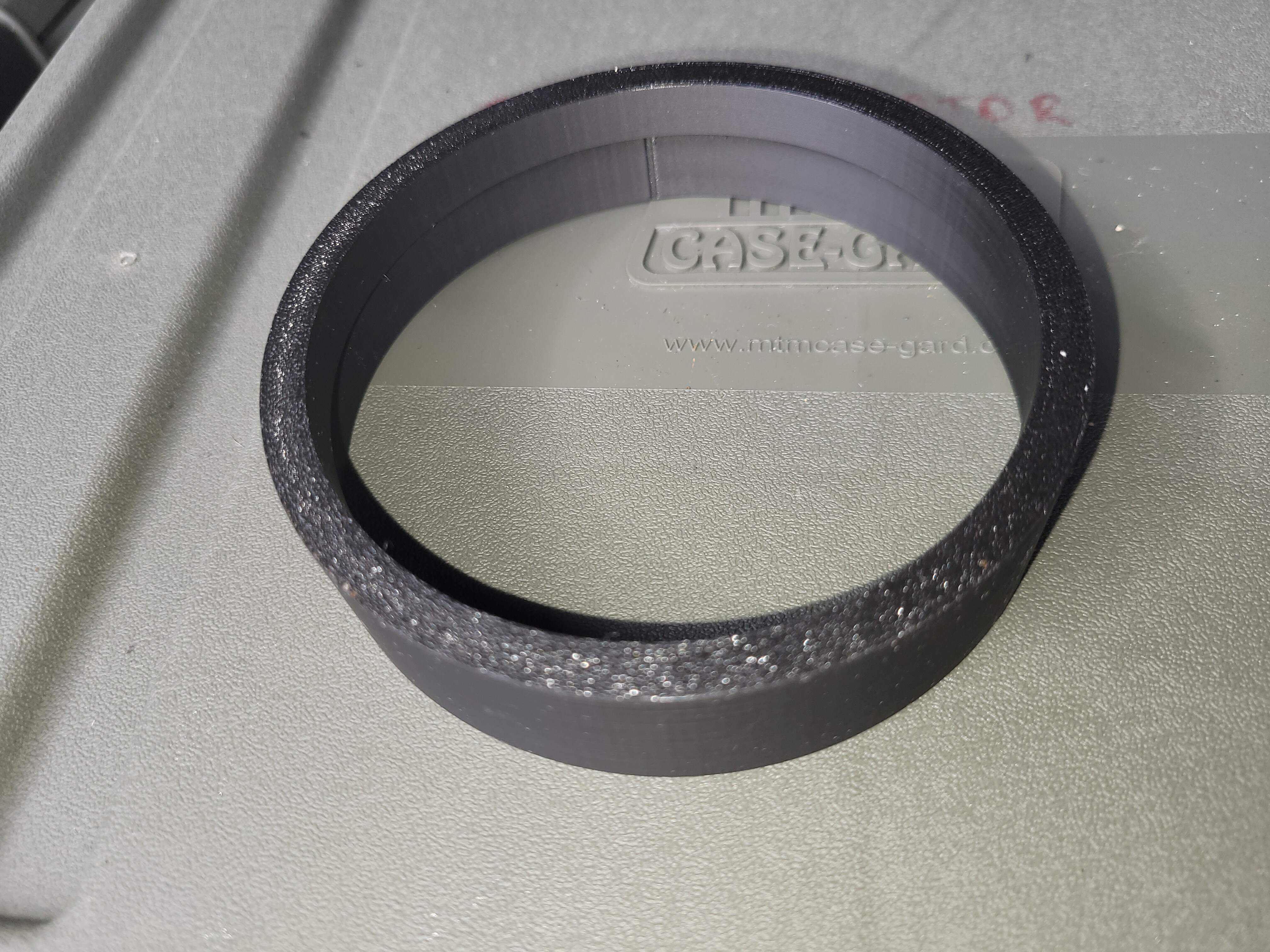

I am going to measure and 3D print a ring to close the gap to make it look better... Once I have it tested and refined if anyone needs I can send you one as well or send you the file for you to print locally...

Very cool 👍
if I had the brains to think Chevy steering wheel , I wouldn’t have spent a week fixing my factory one !!! That impala one looks bloody perfect ! :dancingpontiac:
Good job on the striker Ron, that steering wheel looks awesome bro! Make sure you keep us posted on your progress bro and show us that 3D piece once that's finished. :cheers:

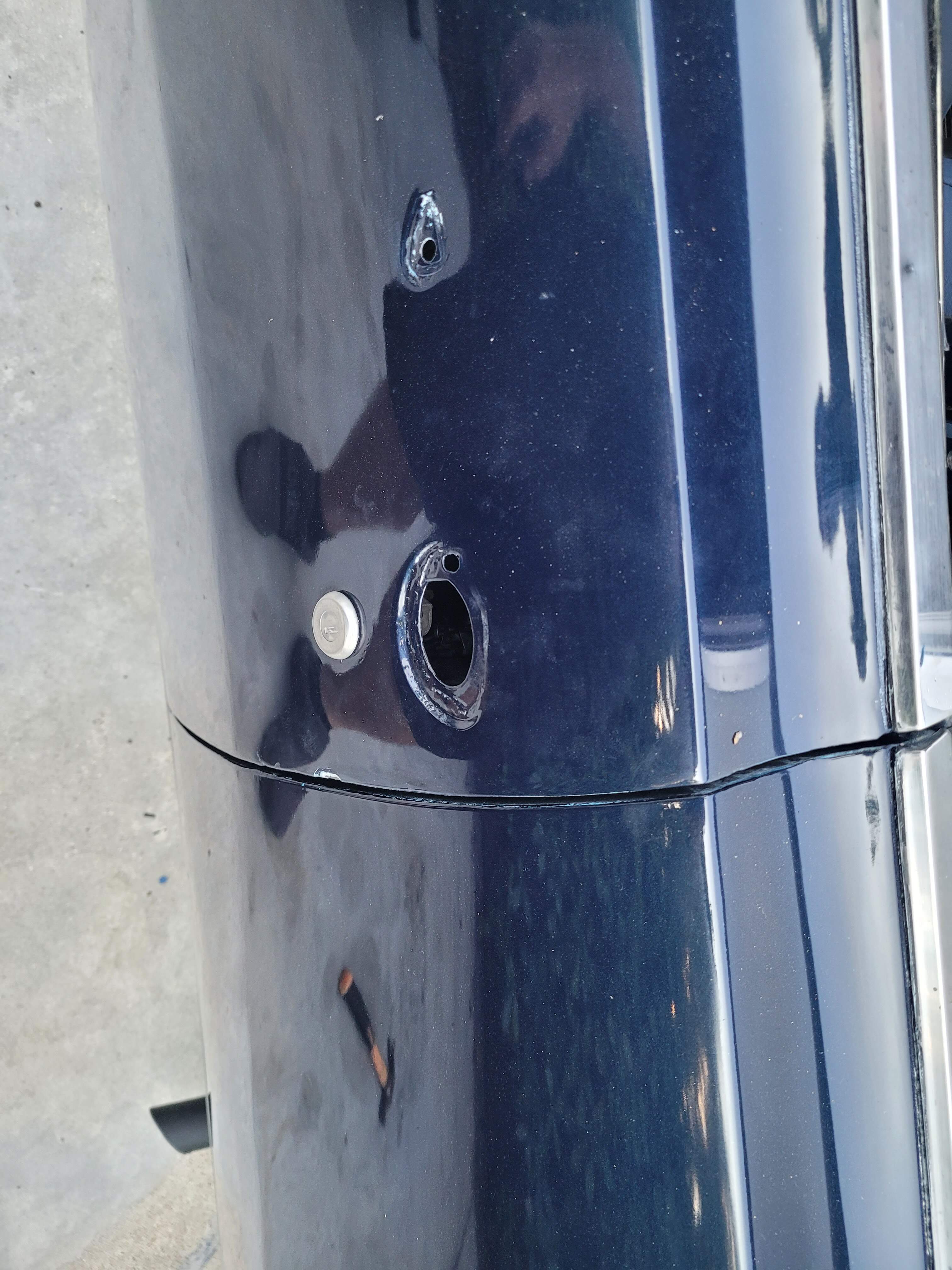

Hello guys... Another weekend working on the GP, I have a water leak in the trunk and a rust bubble appeared close to the back window trim, how difficult is to remove the back window lower trim to make repairs and reseal it?

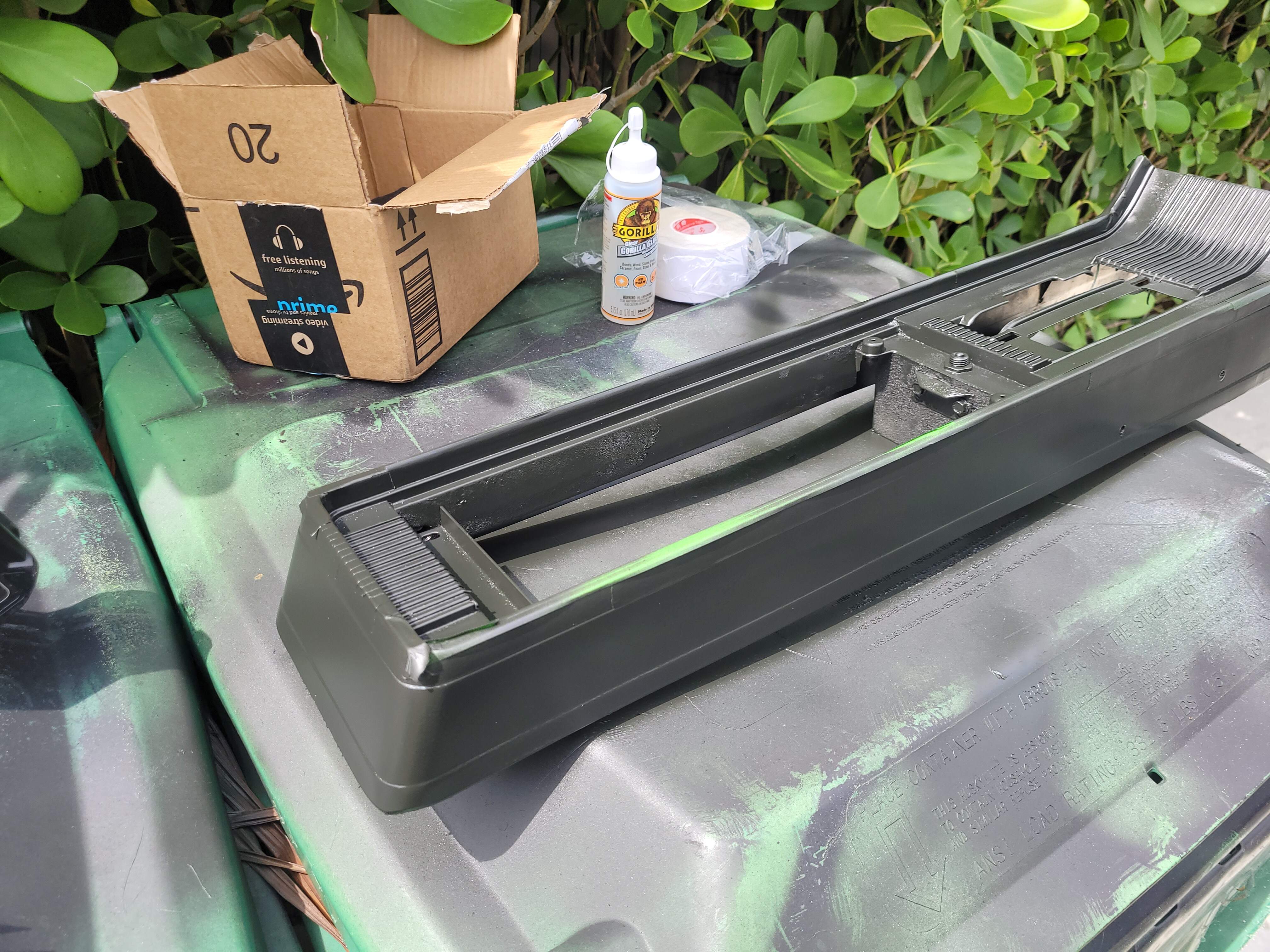

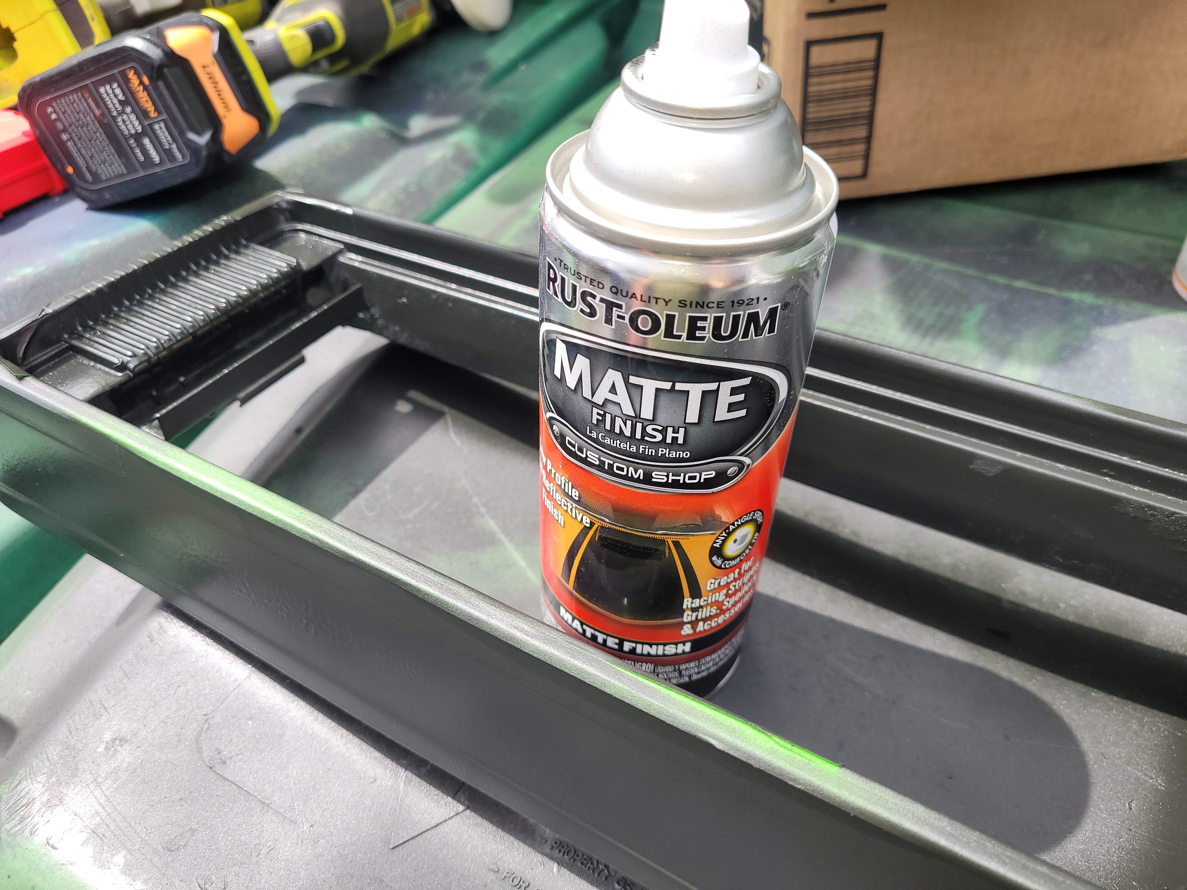

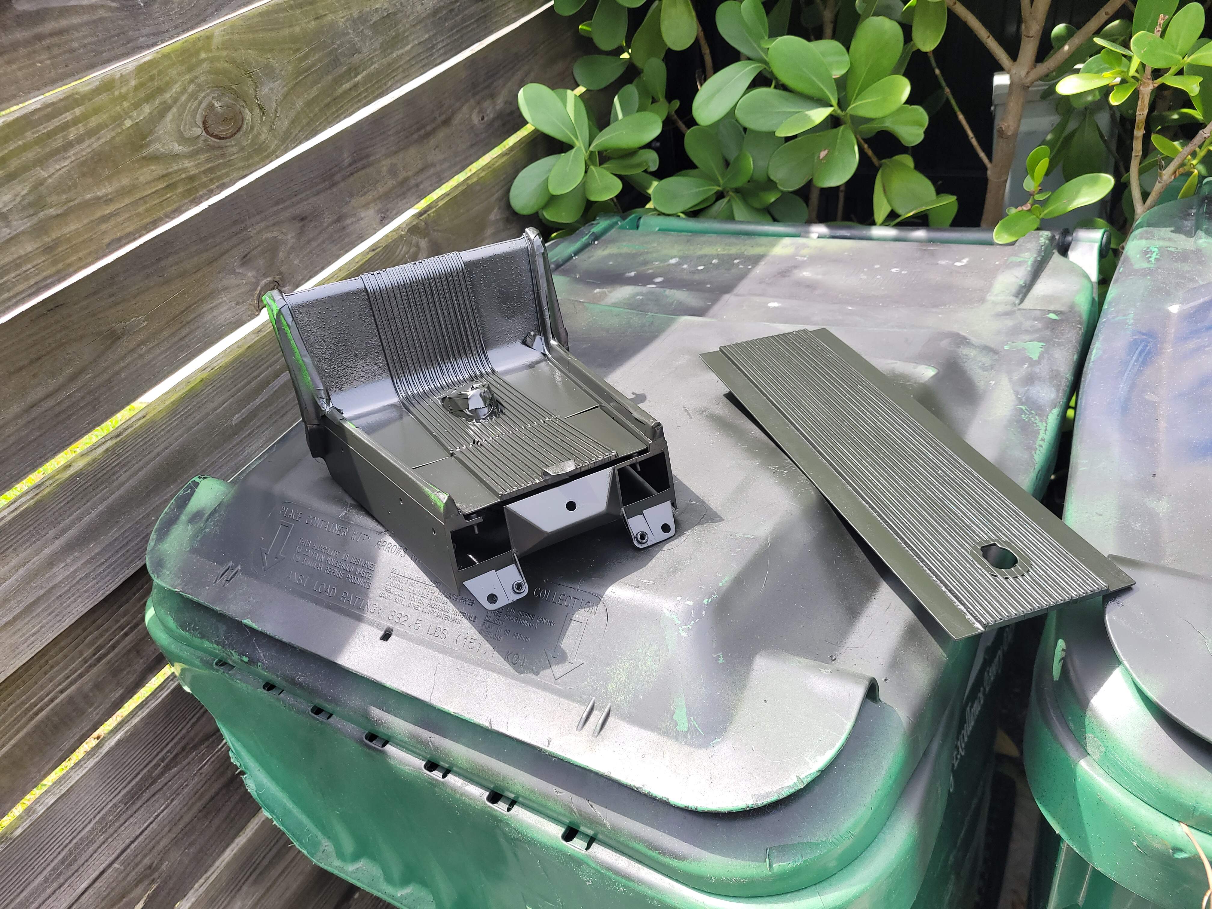

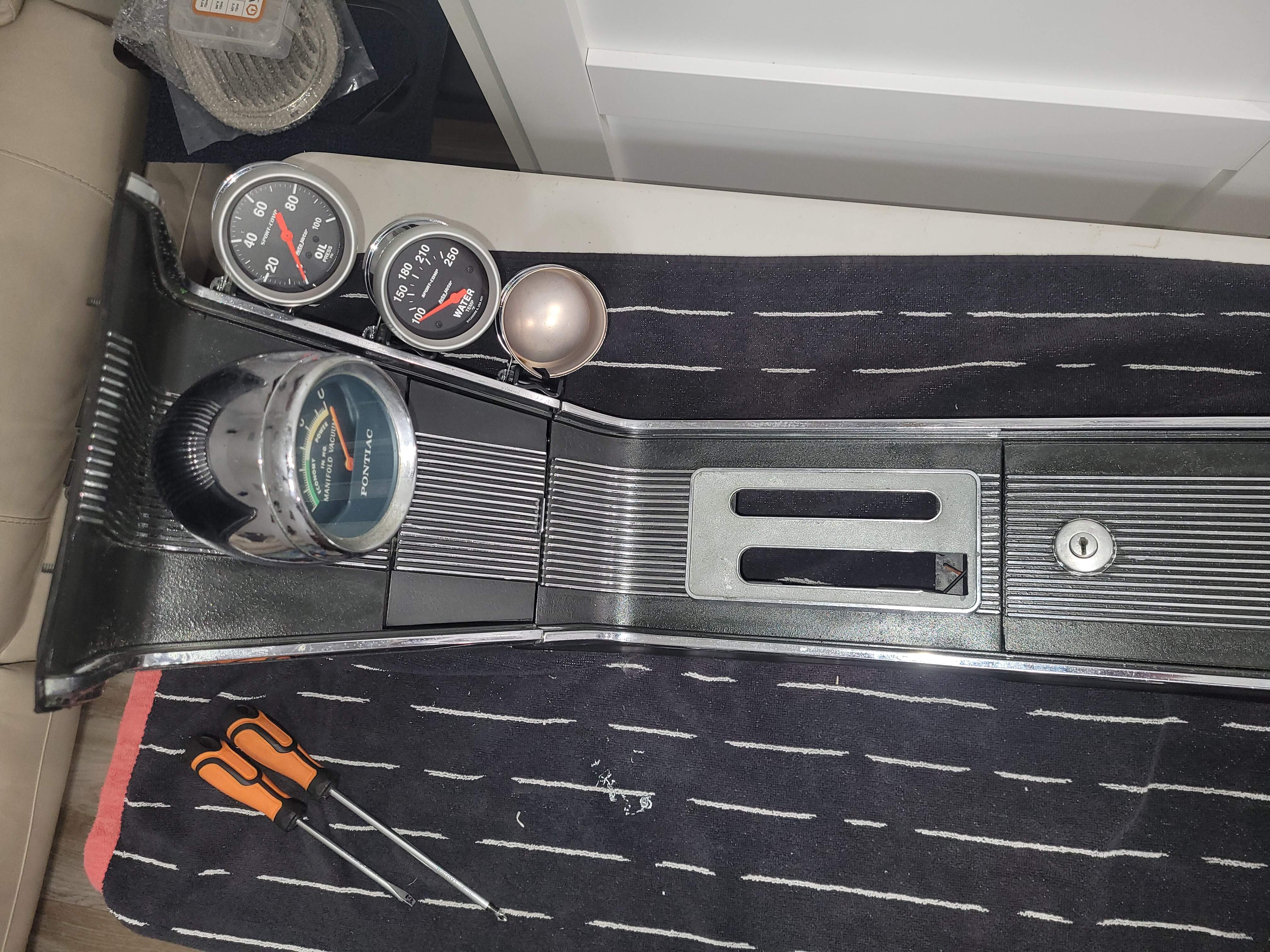

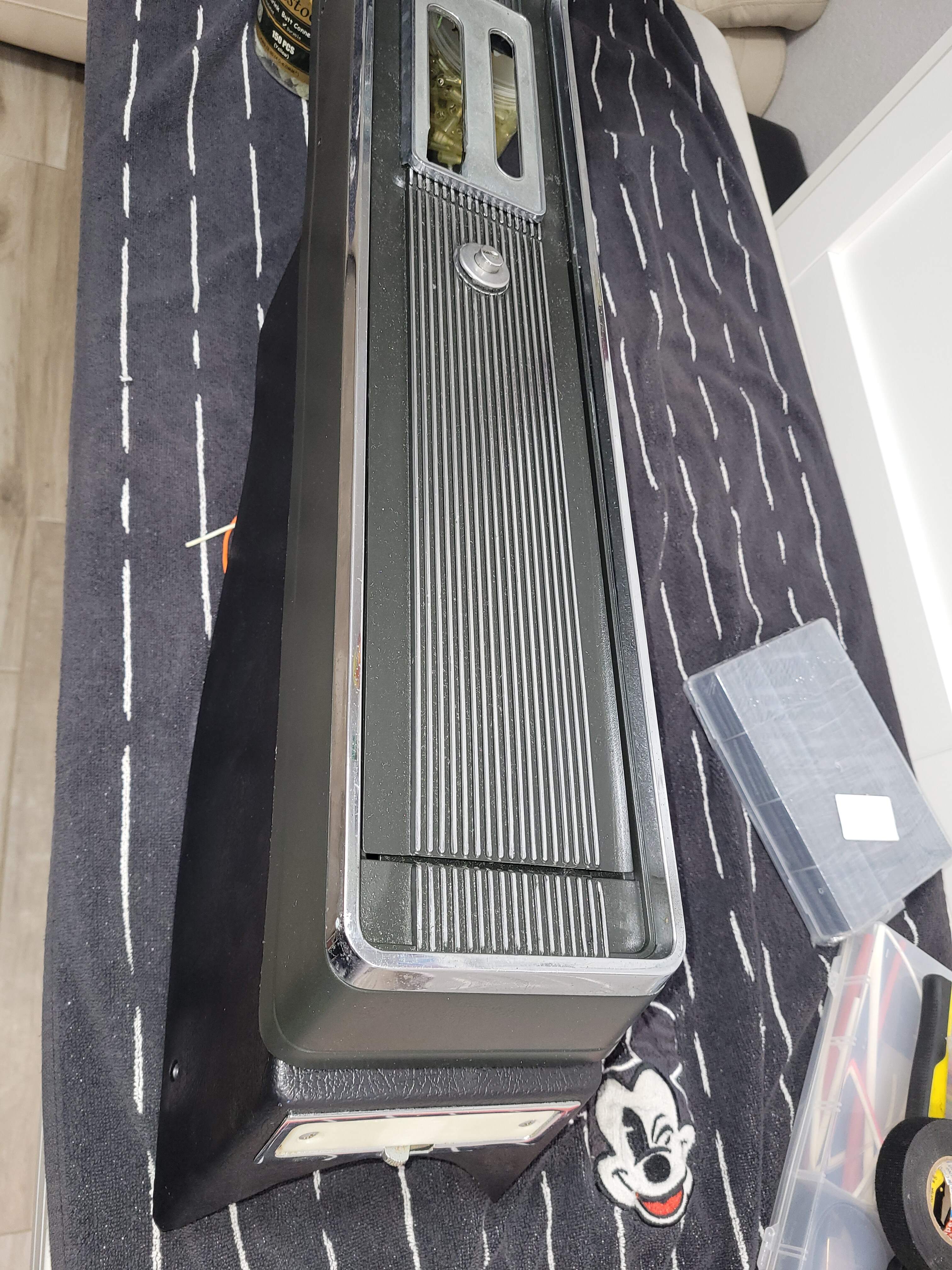

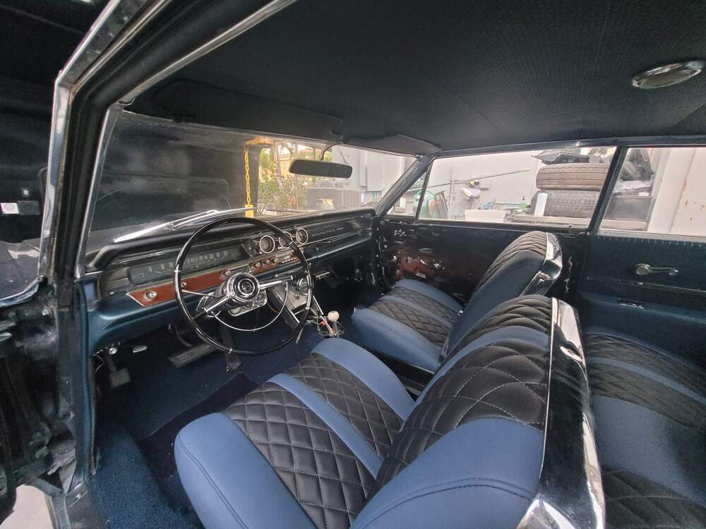

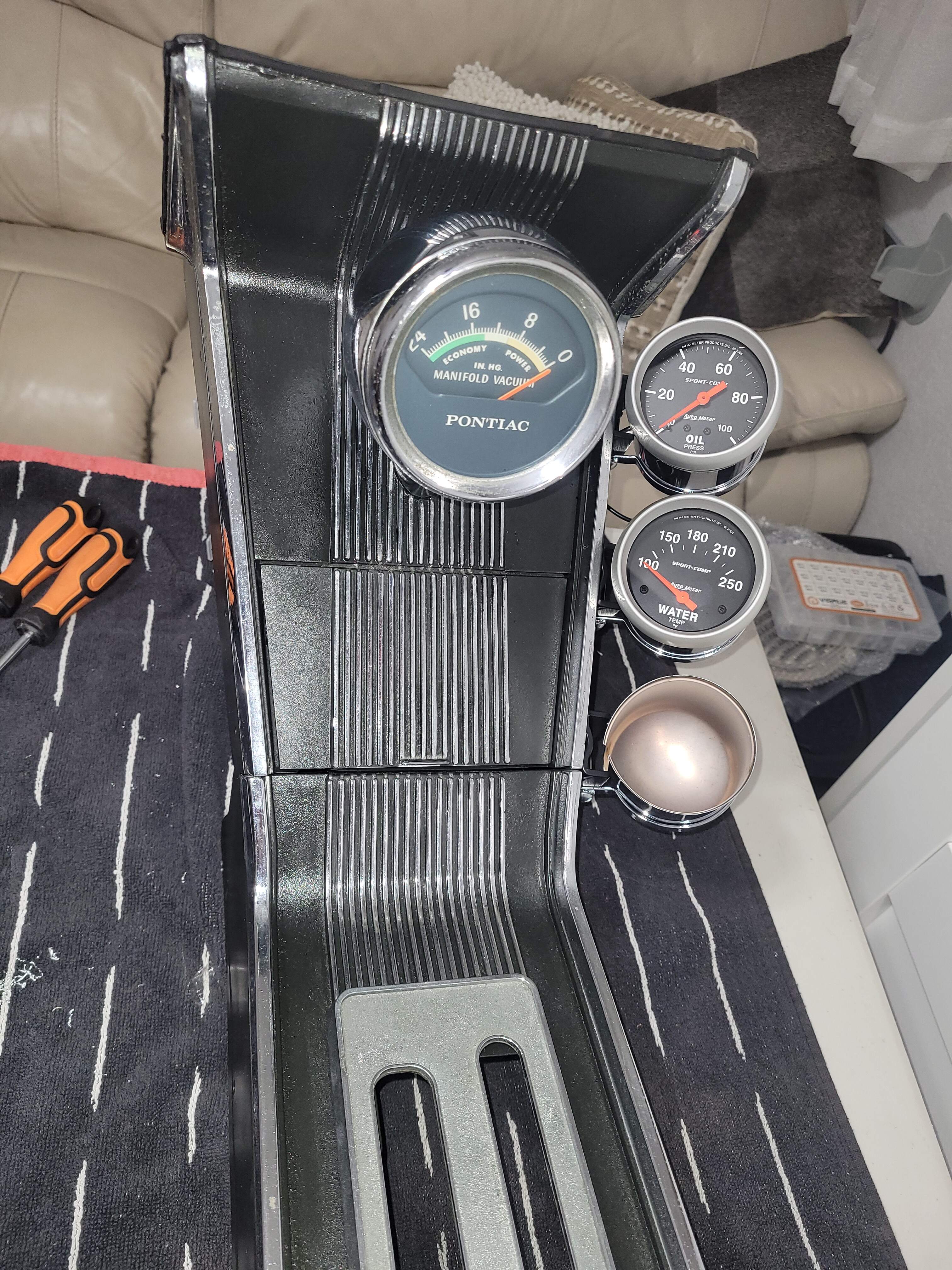

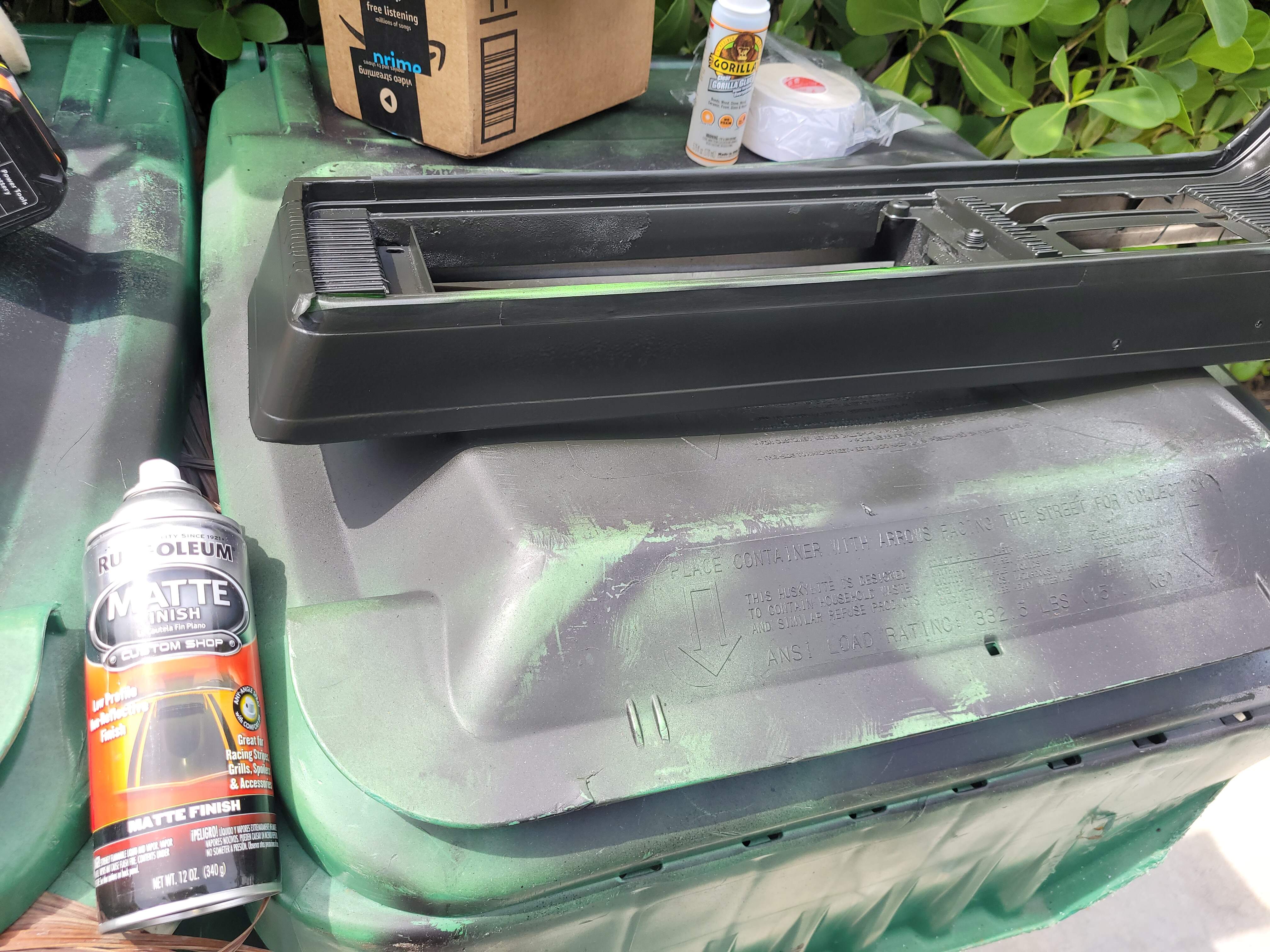

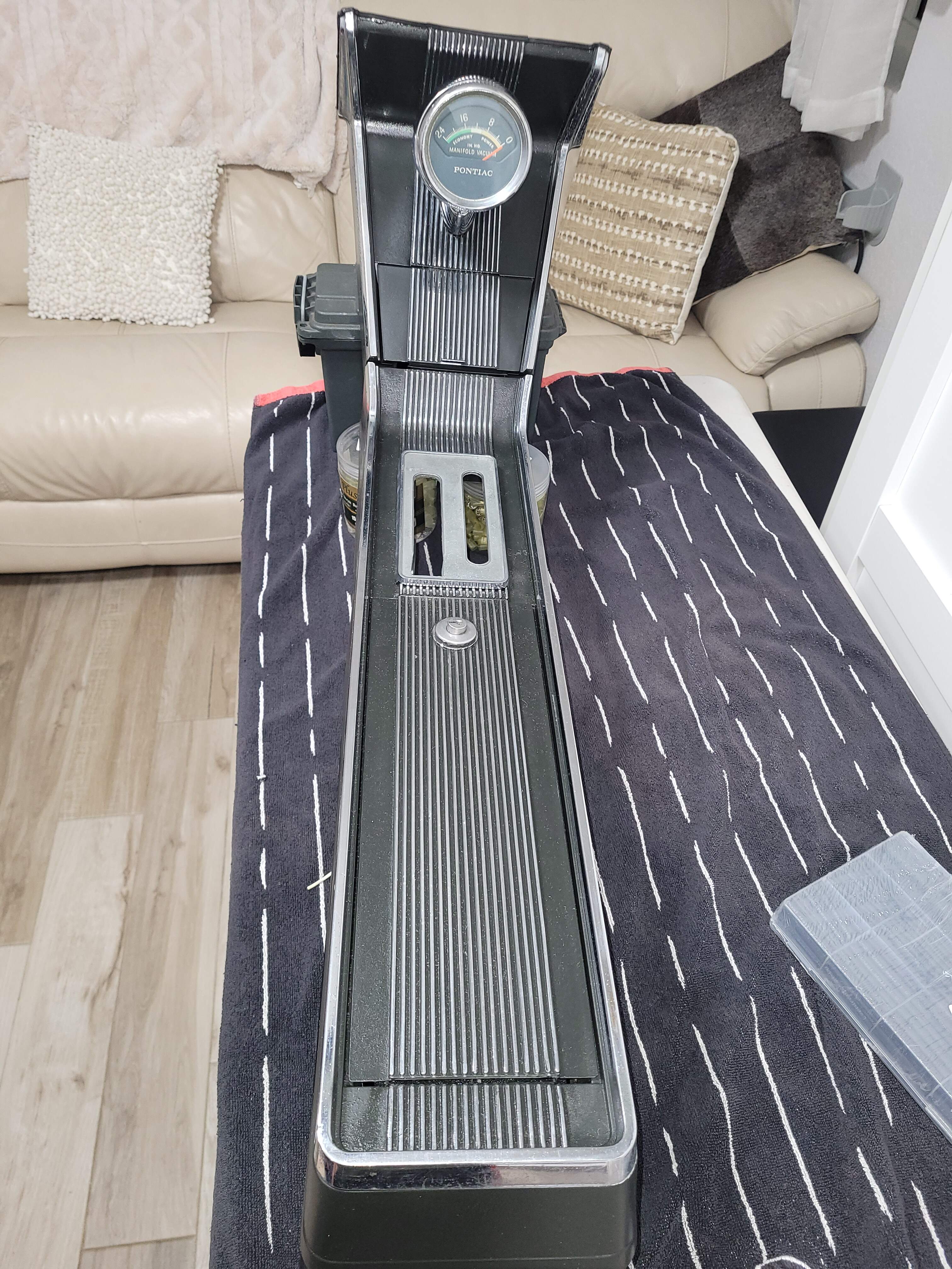

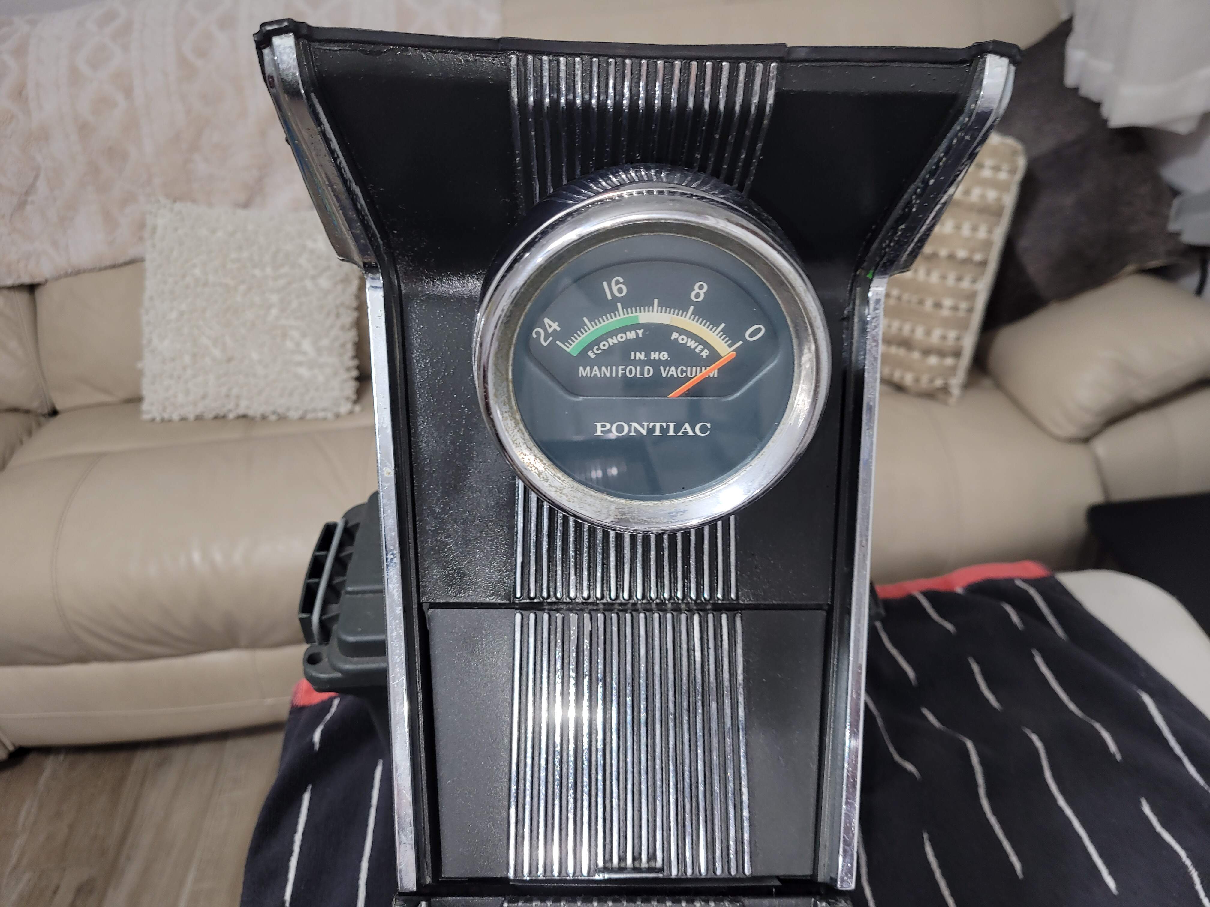

Here are the pictures of the console after removing the tapes, a lot of work almost lost it 🙂 the last 2 pictures are from a few months ago before I removed the interior to redo it...
Now I need to work on the electrical and install my gauge pods on the passenger side of the console..

Lookin so good.  Thankz for sharing your project pic's with us.

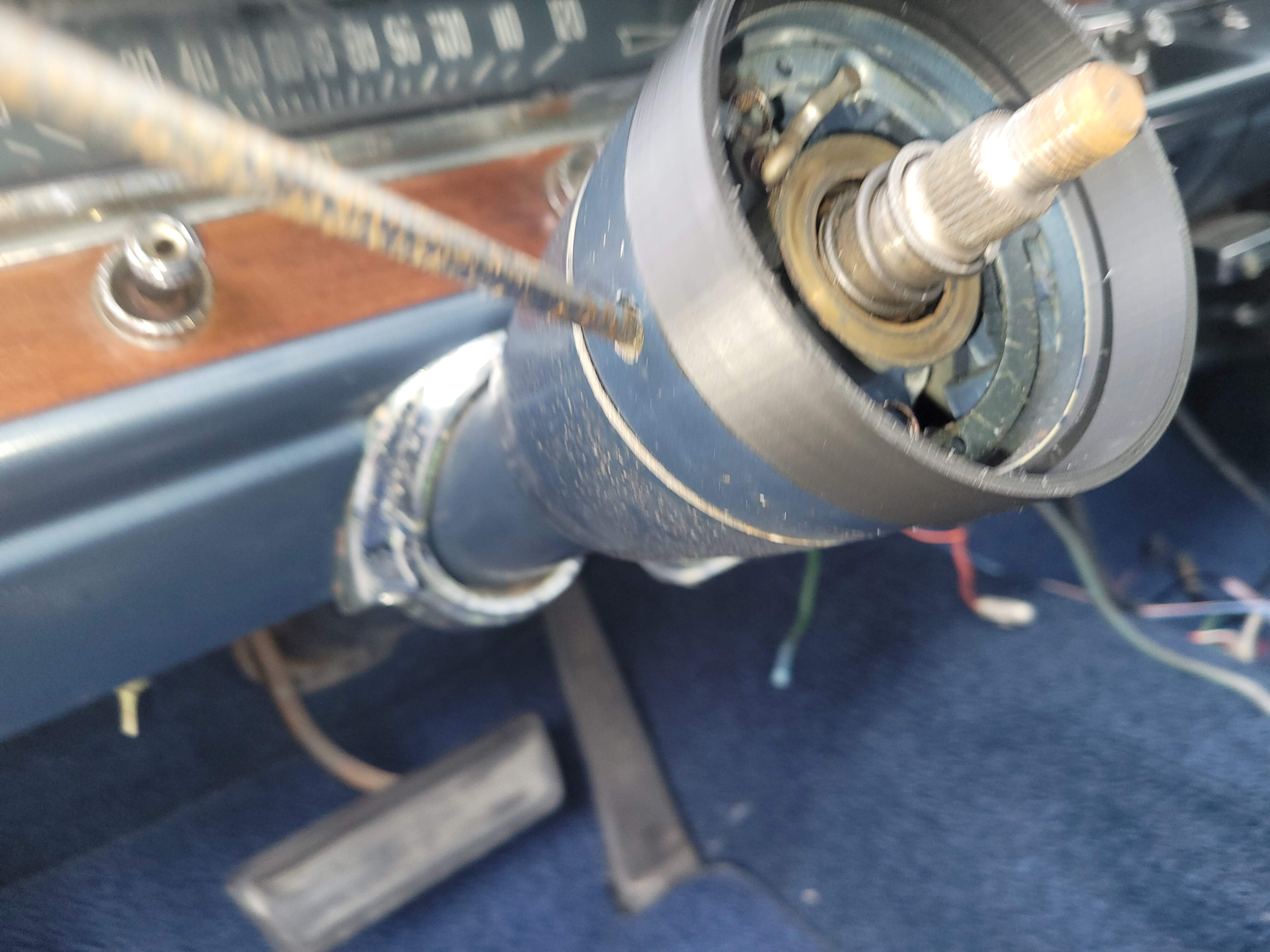

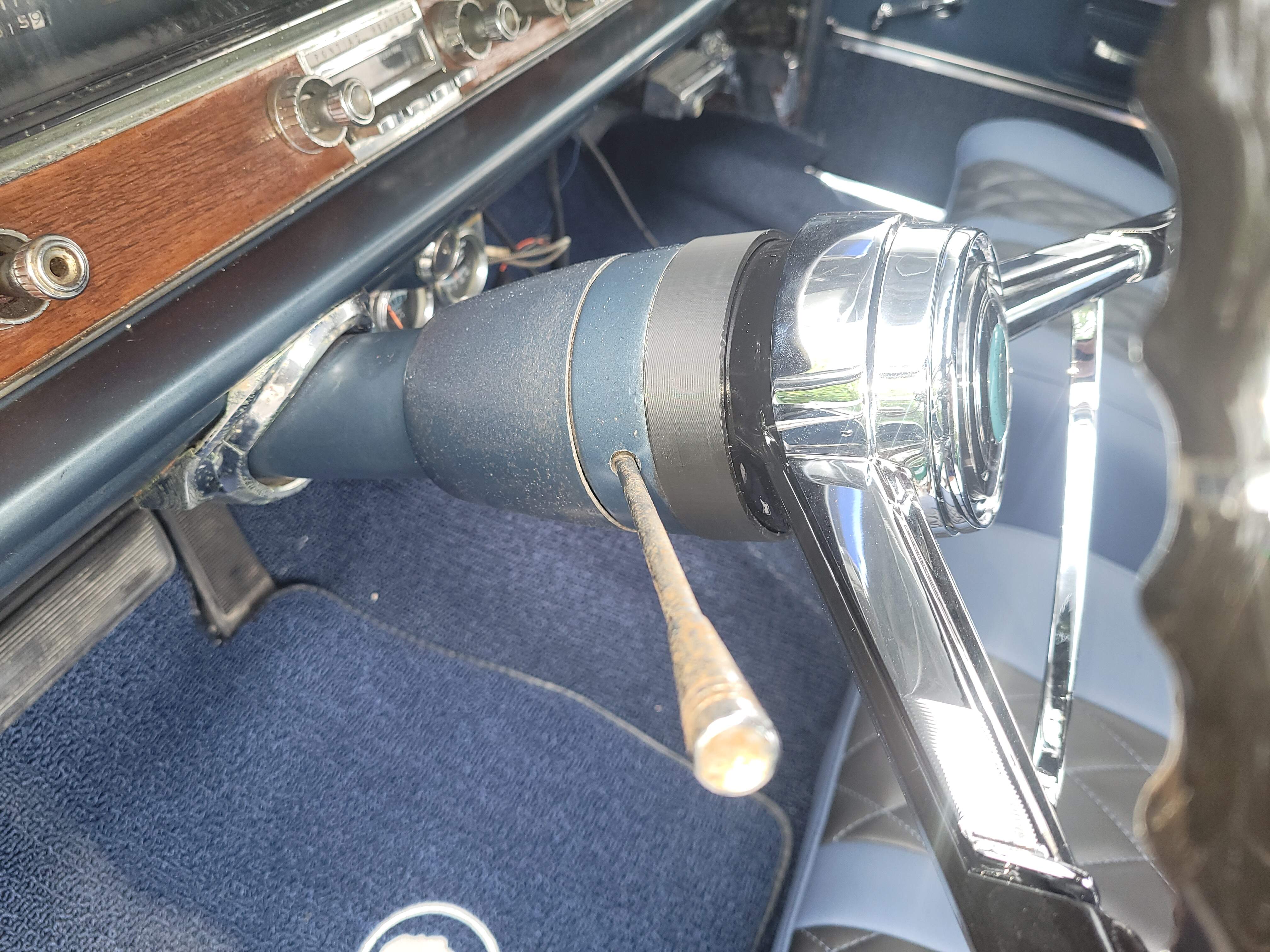

Another day more progress... The door panels have been FINALLY installed!!! The steering column 3d printed adapter worked perfect for the new steering wheel and it is now "official" Pontiac it has the Pontiac logo and no longer has the gap 😉

So first the back windshield trim was not difficult to remove.  I had all my chrome off and windshields out for paint bro. 2nd, the console looks awesome Ron! Gauges on the passengers side of console, great idea :D  and that adaptor looks great man, right at home, and I still love the seats!!! Hey, thanks for keeping us included in your journey with pics bro.

Thank you Wrongway. you center console looked fantastic had to copy it sorry... 🙂
