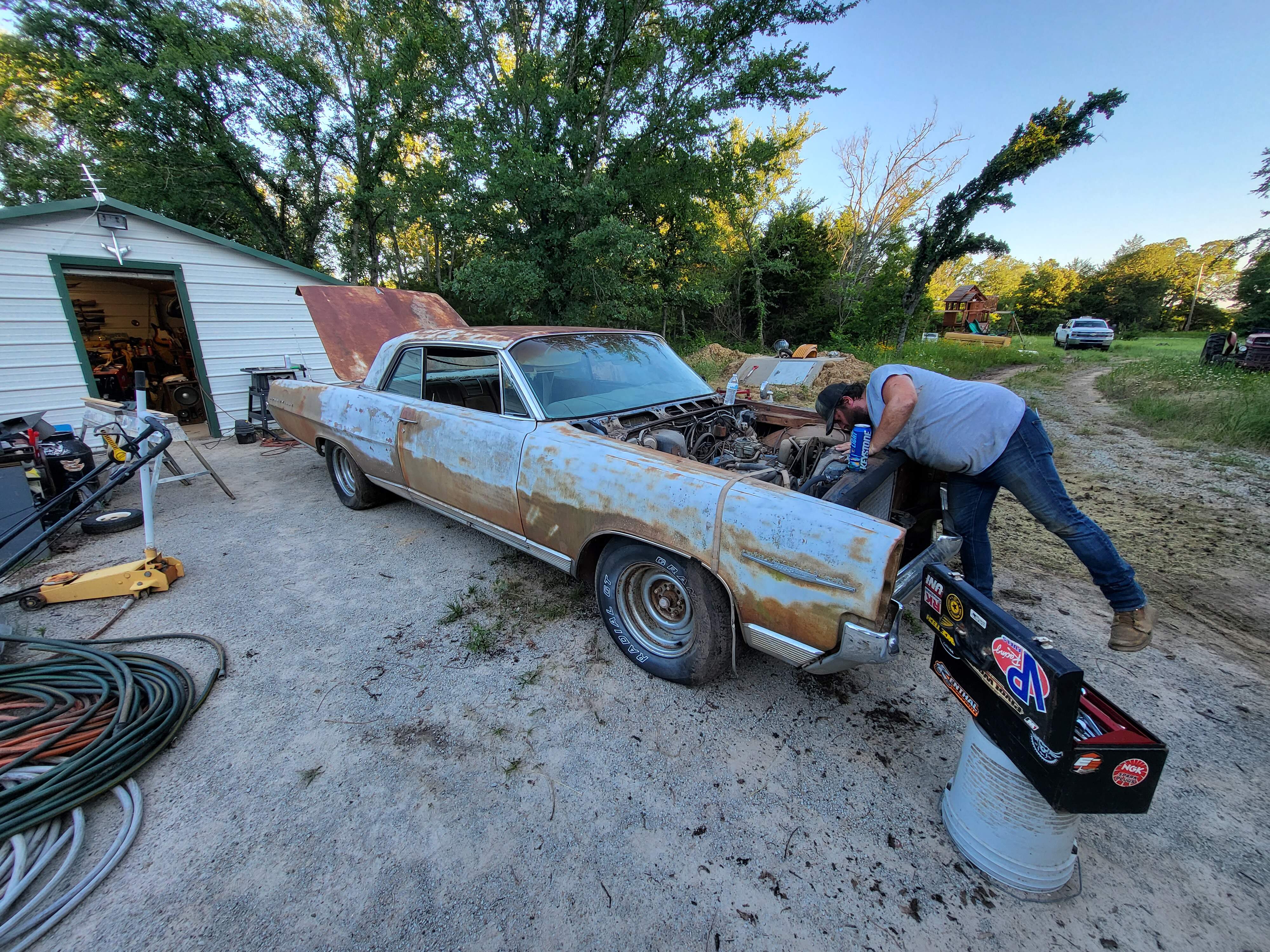

My first Pontiac was dragged out of a back yard in Oklahoma.....
I was at an estate sale that had nothing worth while in the house. I asked the lady if there were any sheds with tools or anything. She told me there was a couple tractors and a car out back. I went out back to find a 64 Bonneville that hadn't been tagged since 2000. Her husband and sons were trying to start one of the tractors when I asked about the Pontiac. I asked what he was wanting for the car. He told me scrap value was $300 and that's what he'll take. I took it and got a title too! I was nervous about all of the headlights and grills missing, but they were all safely stowed away in the very rusted out trunk...I have fallen in love with this car and it will be back on the road again!

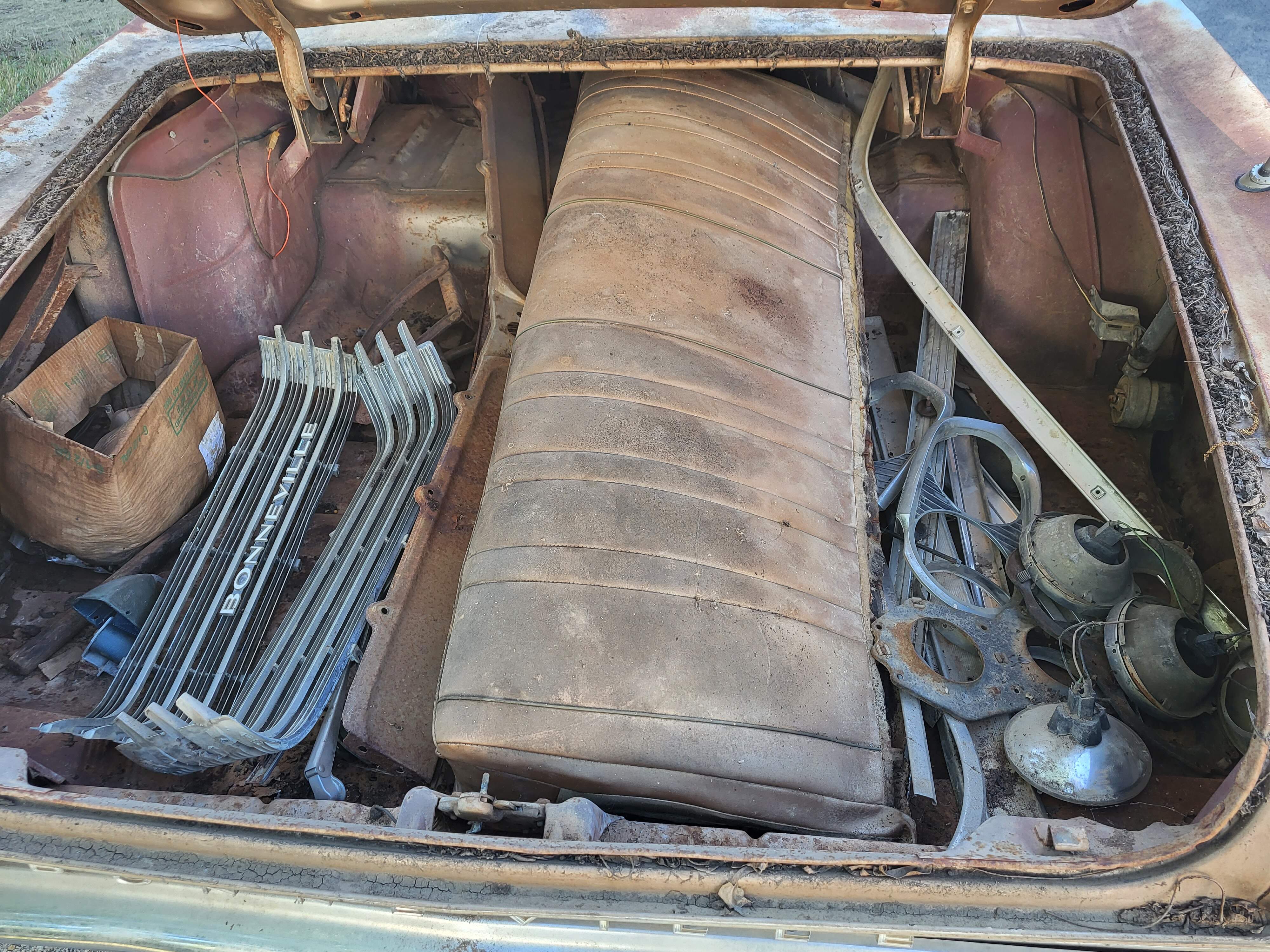

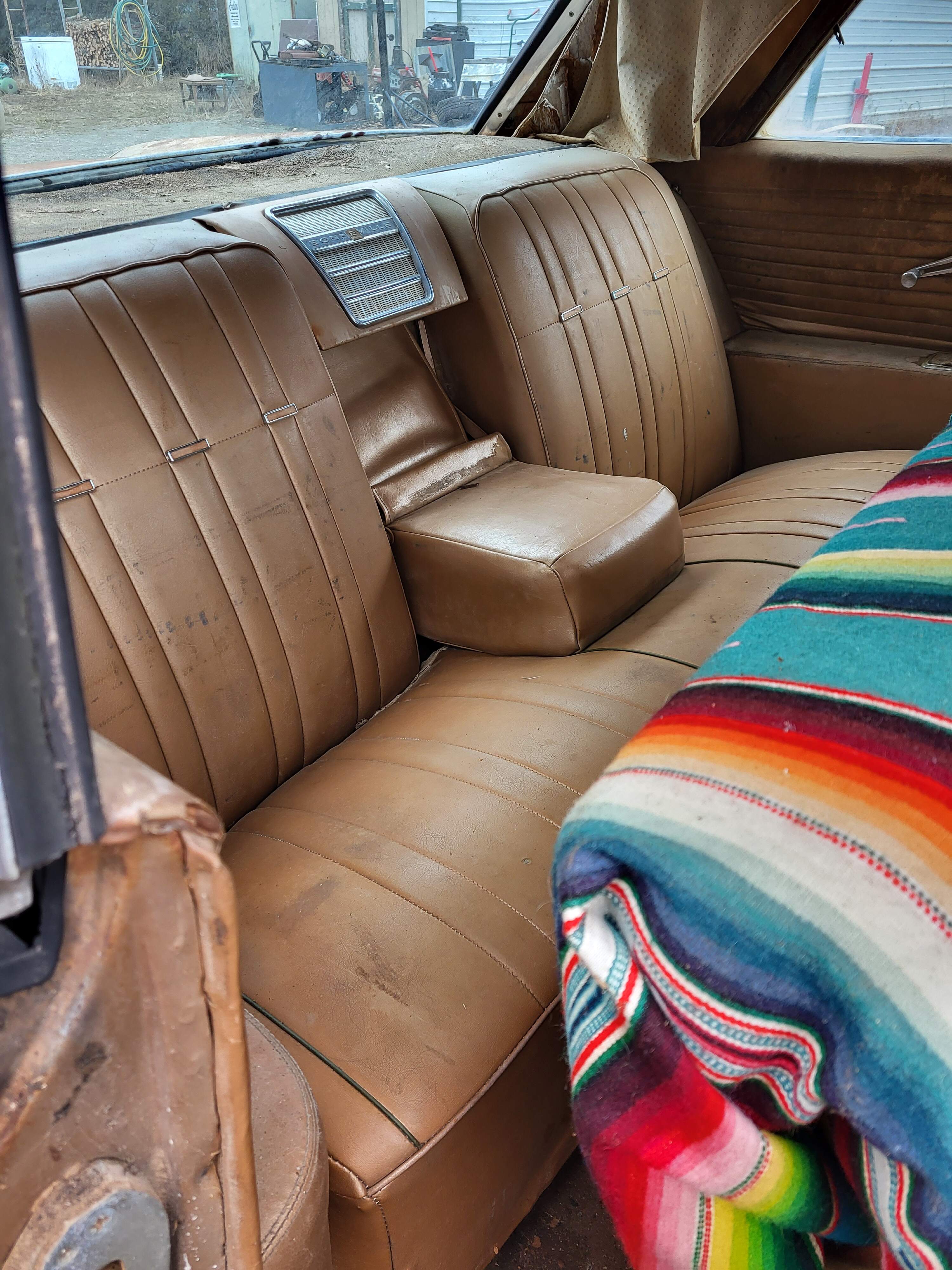

  • A few pics after cleaning up the rear seat. the front seat had been left outside for many years so it got ghetto restored. I'm still trying to get four tires that will hold air.

welcome Jason ! what a score!! well done !:dancingpontiac:
did it still have its 389 and super hydromatic trans ?
how is it for rust ? especally the boot floor ?
let us know if you need any info, we have a great team of pontiac lovers here who are more than happy to help out !
Welcome Jason! Great ride man, so much potential! So, what's your plans man? How's the inside? Any pics of the inside or the engine? We do love pics around here :dancingpontiac:
Great find! Look forward to hearing about plans and restoration.
jason, something that i spotted thats odd ! it looks that your 64 has a fuel tank up the driverside inner rear quarter !
my 64 has the tank centre under the floor between the chassis rails !
It does have the 389. It's dated 1965, which might be common. I'm not sure. When looking at the heads they appear to be later model 455 heads. bore and stroke checked out to be 389 specs.
The gas tank is under the floor. I think that picture makes the inner wheel well stand out for some reason.

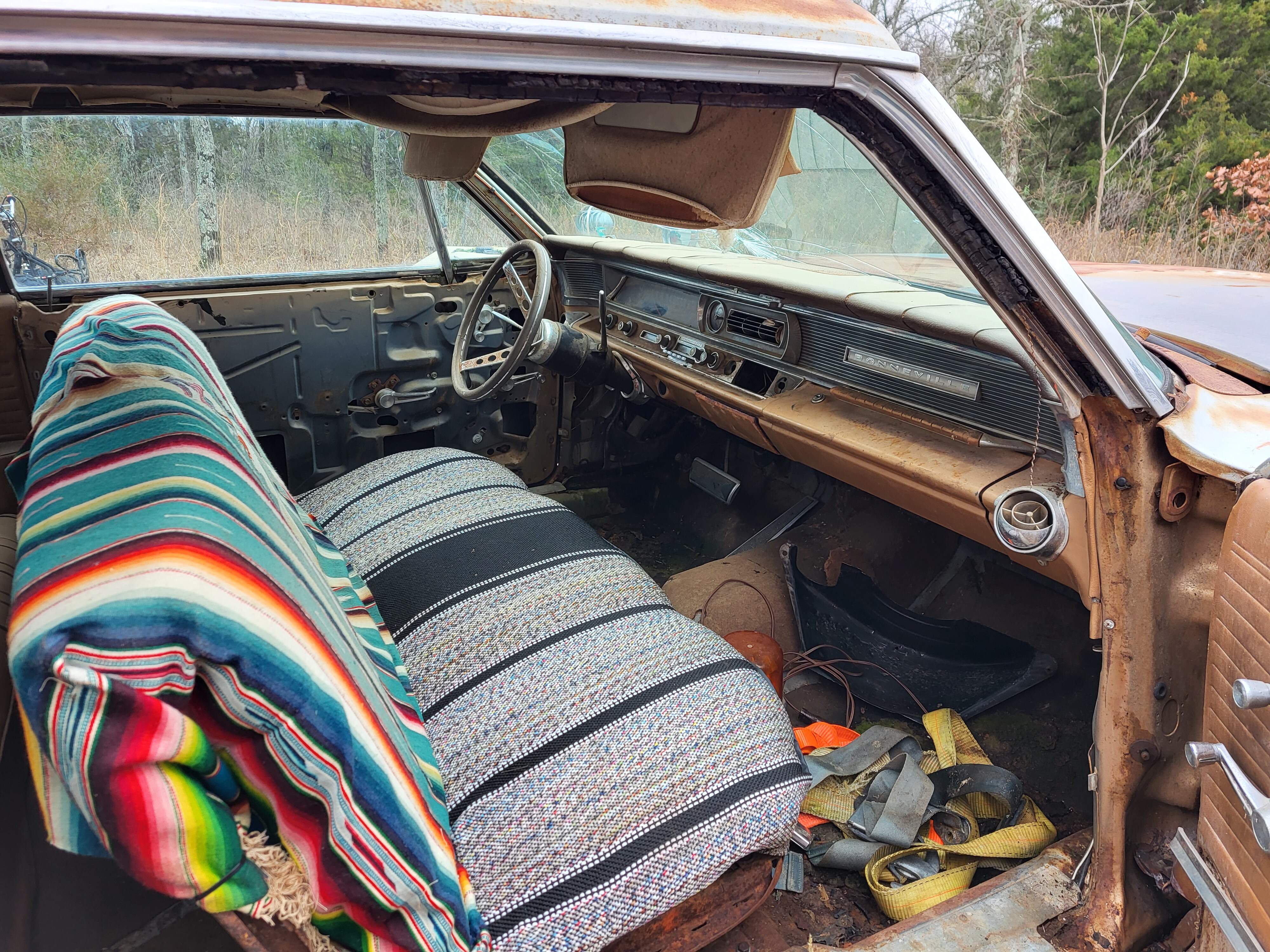

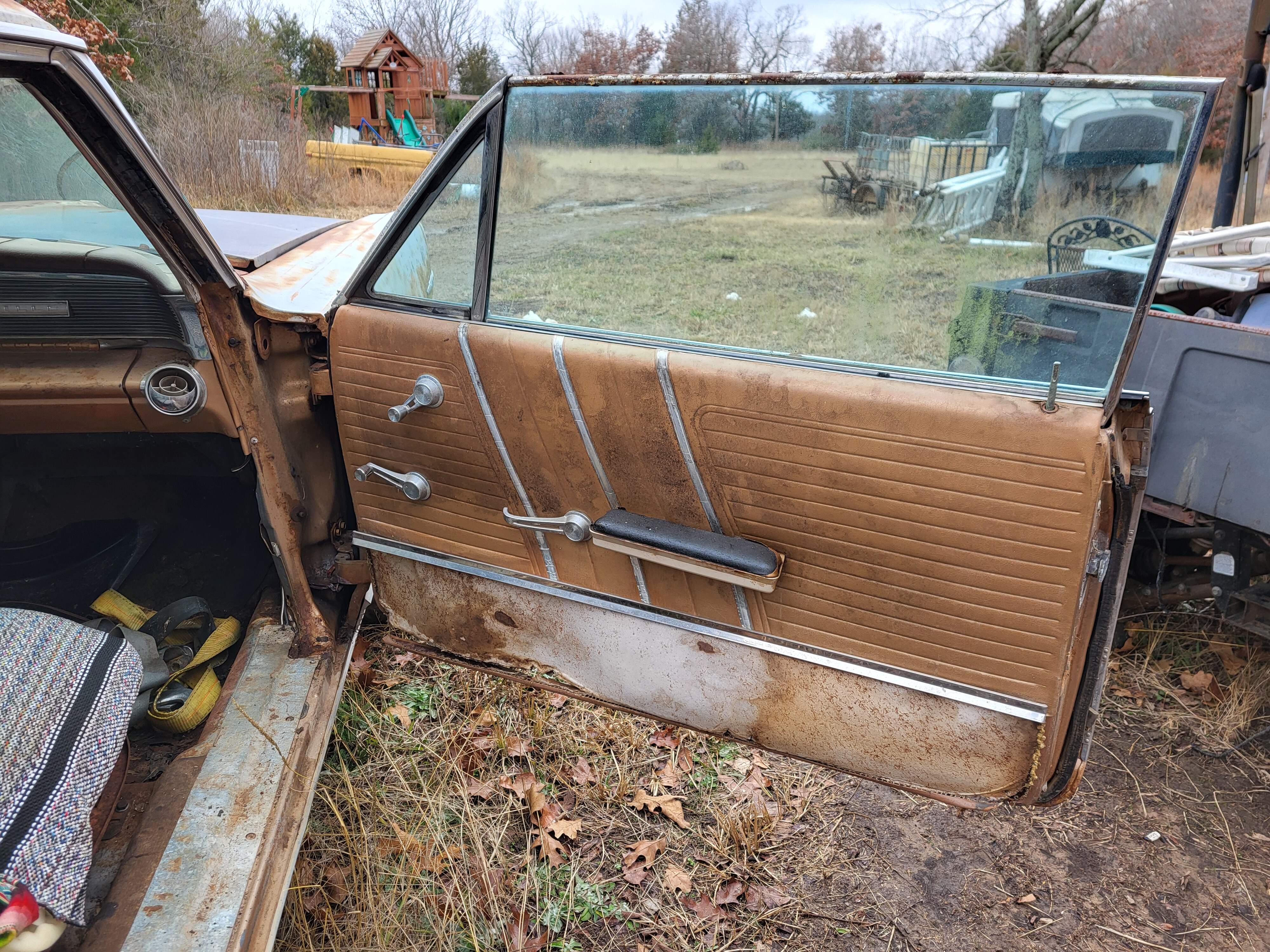

You have some work ahead of you Jason, but man shell be awesome when your done!!! Thanks for the pictures. Keep us updated on your progress.
 Very cool !!!! Thanks for share the pictures … I see you have air con 👍

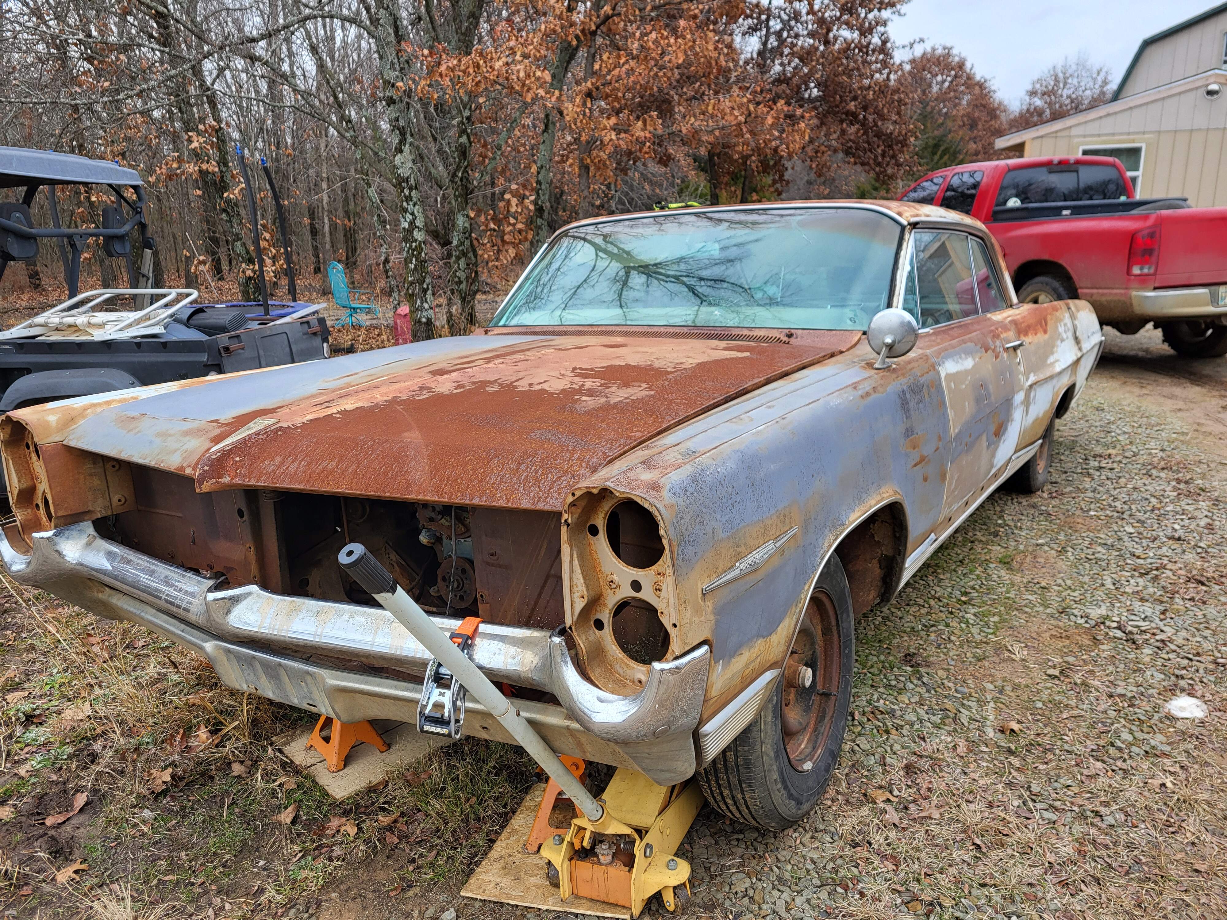

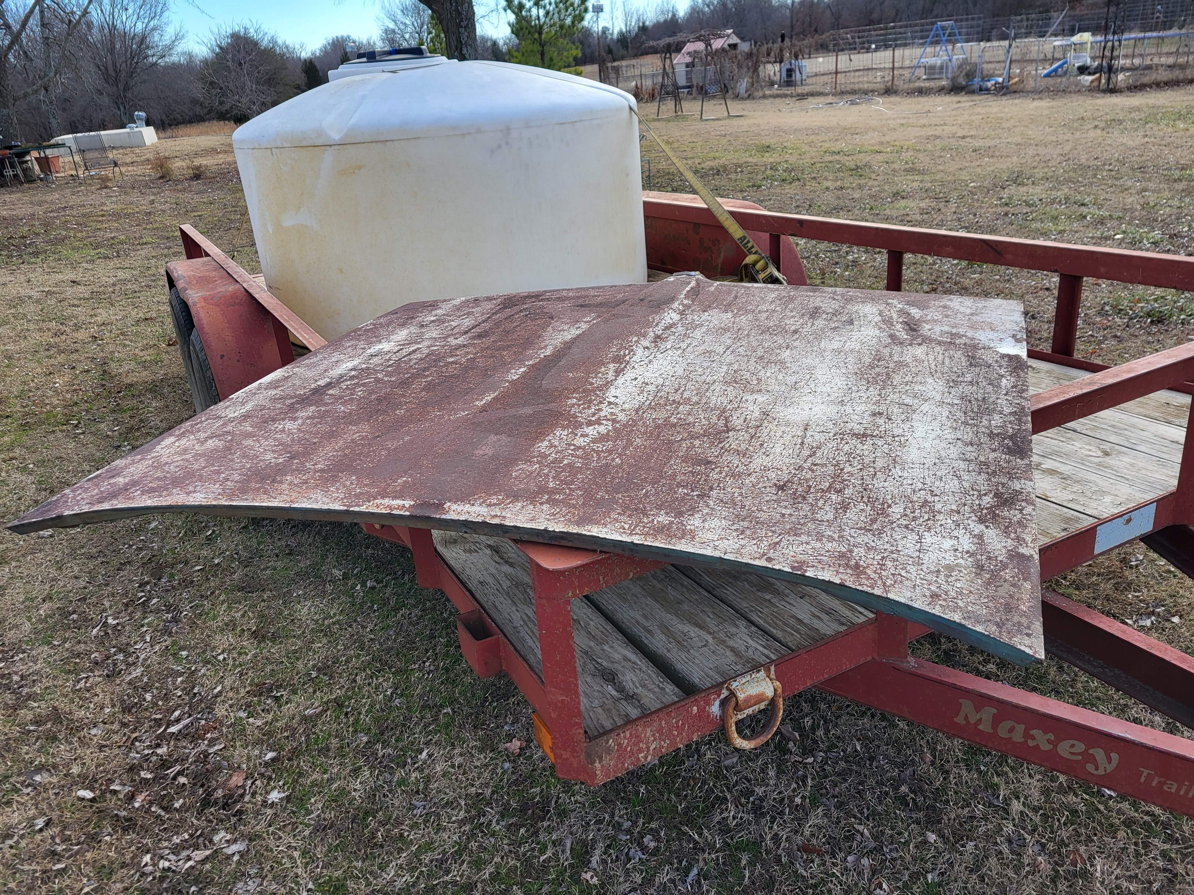

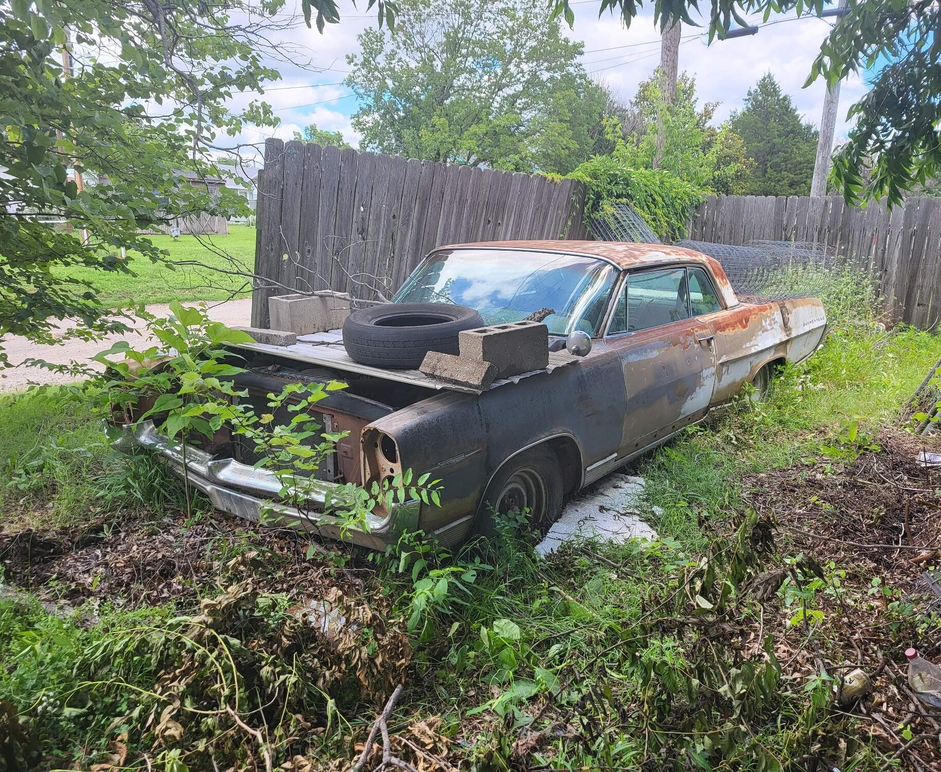

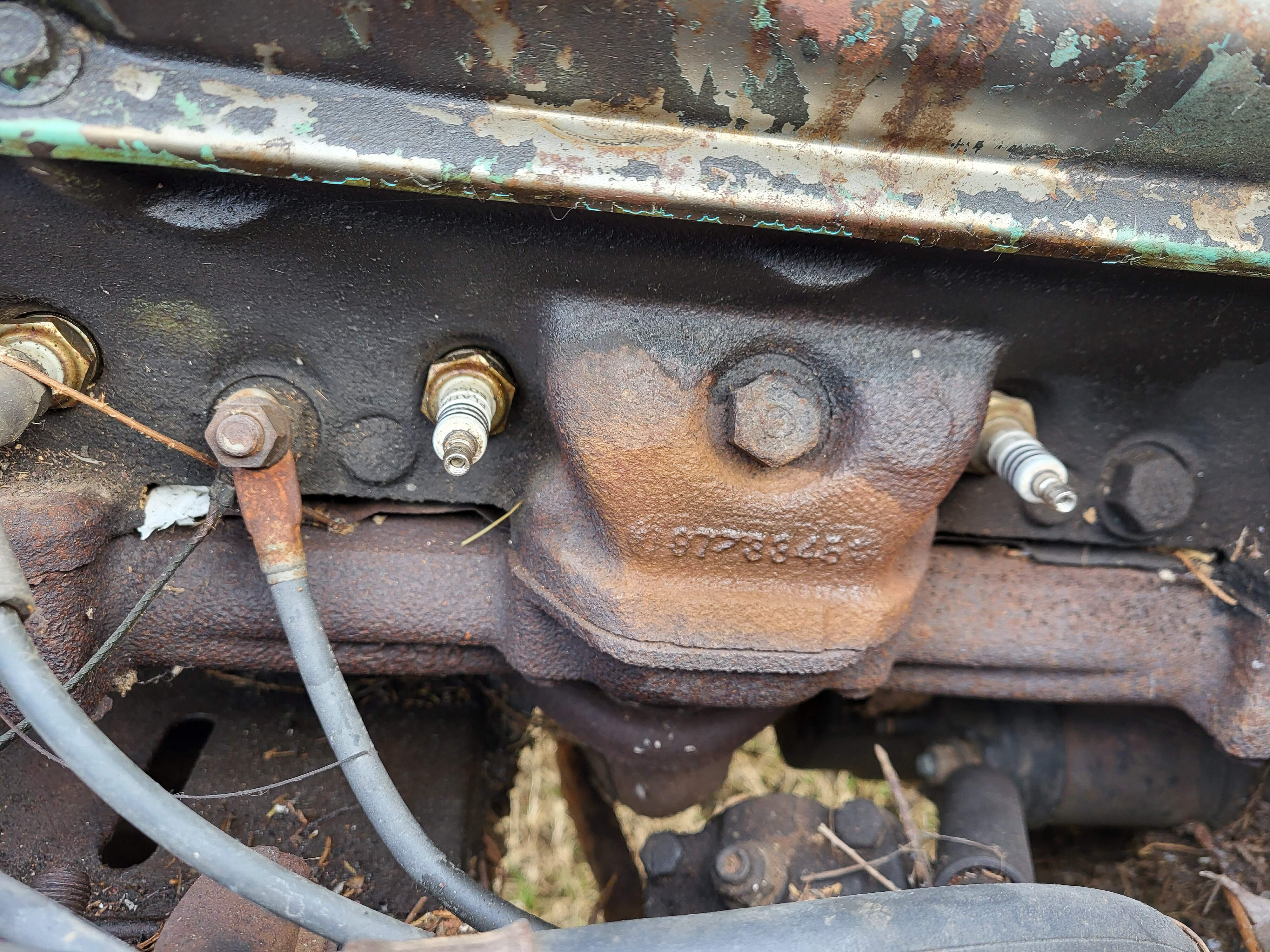

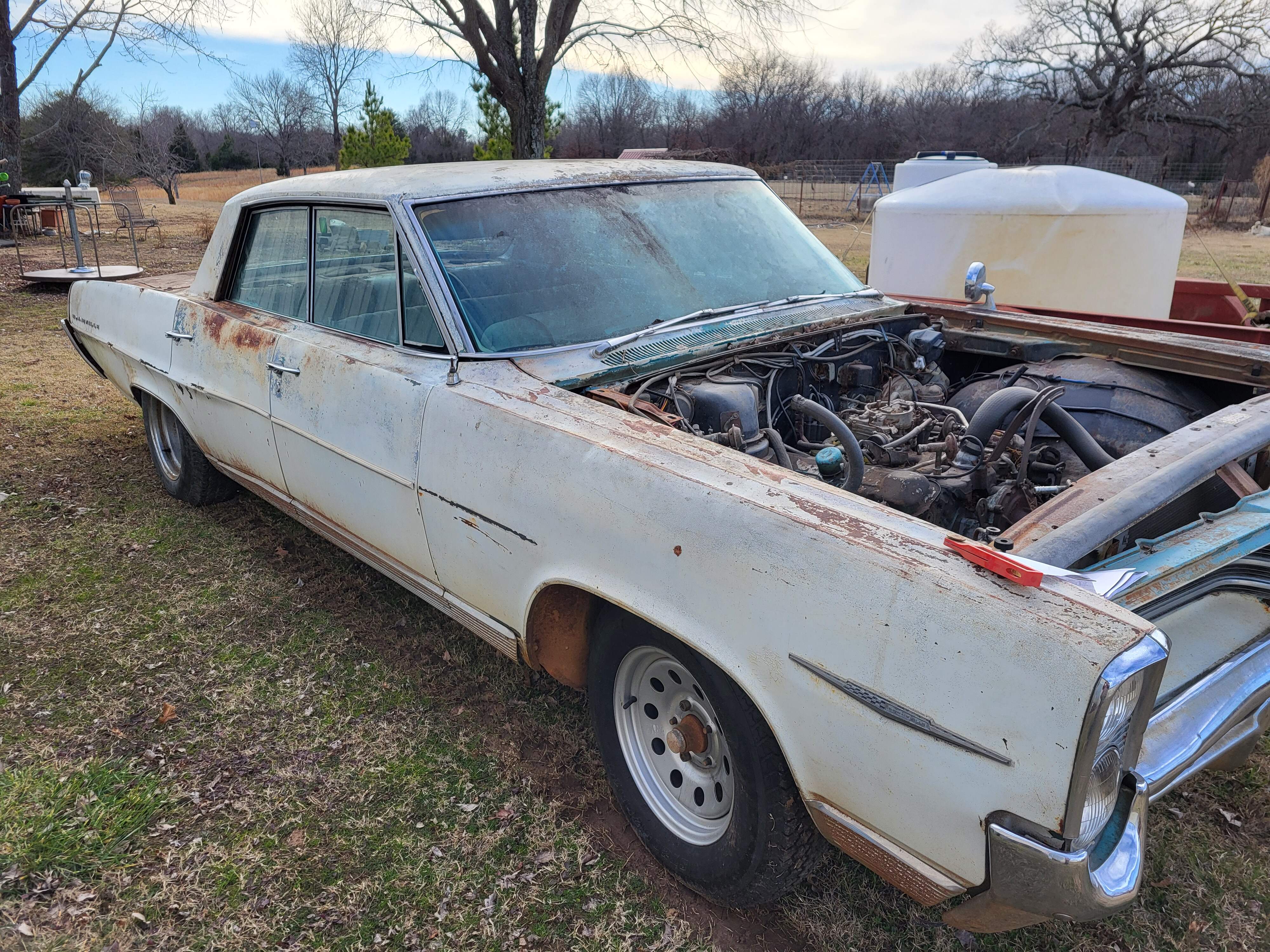

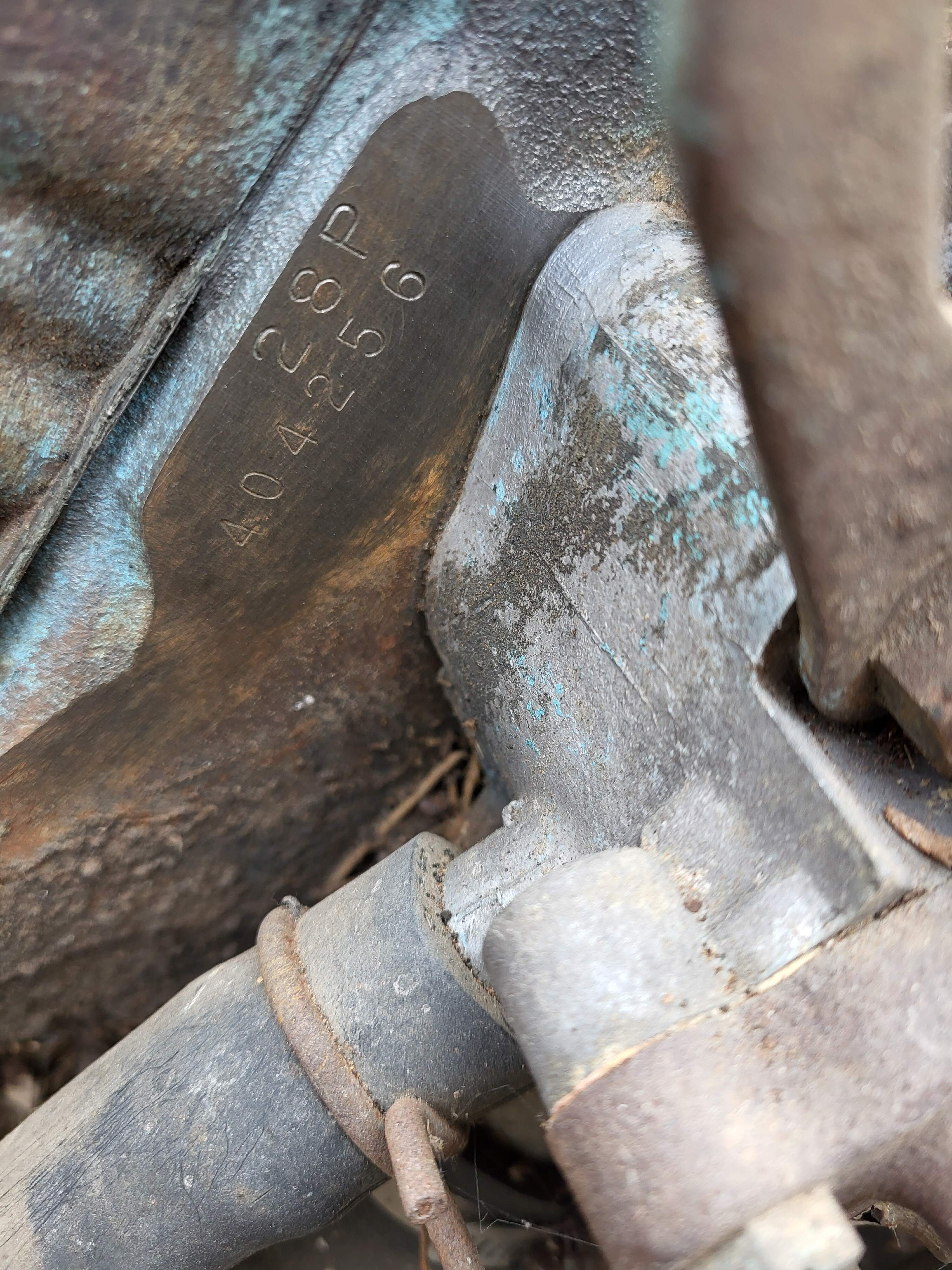

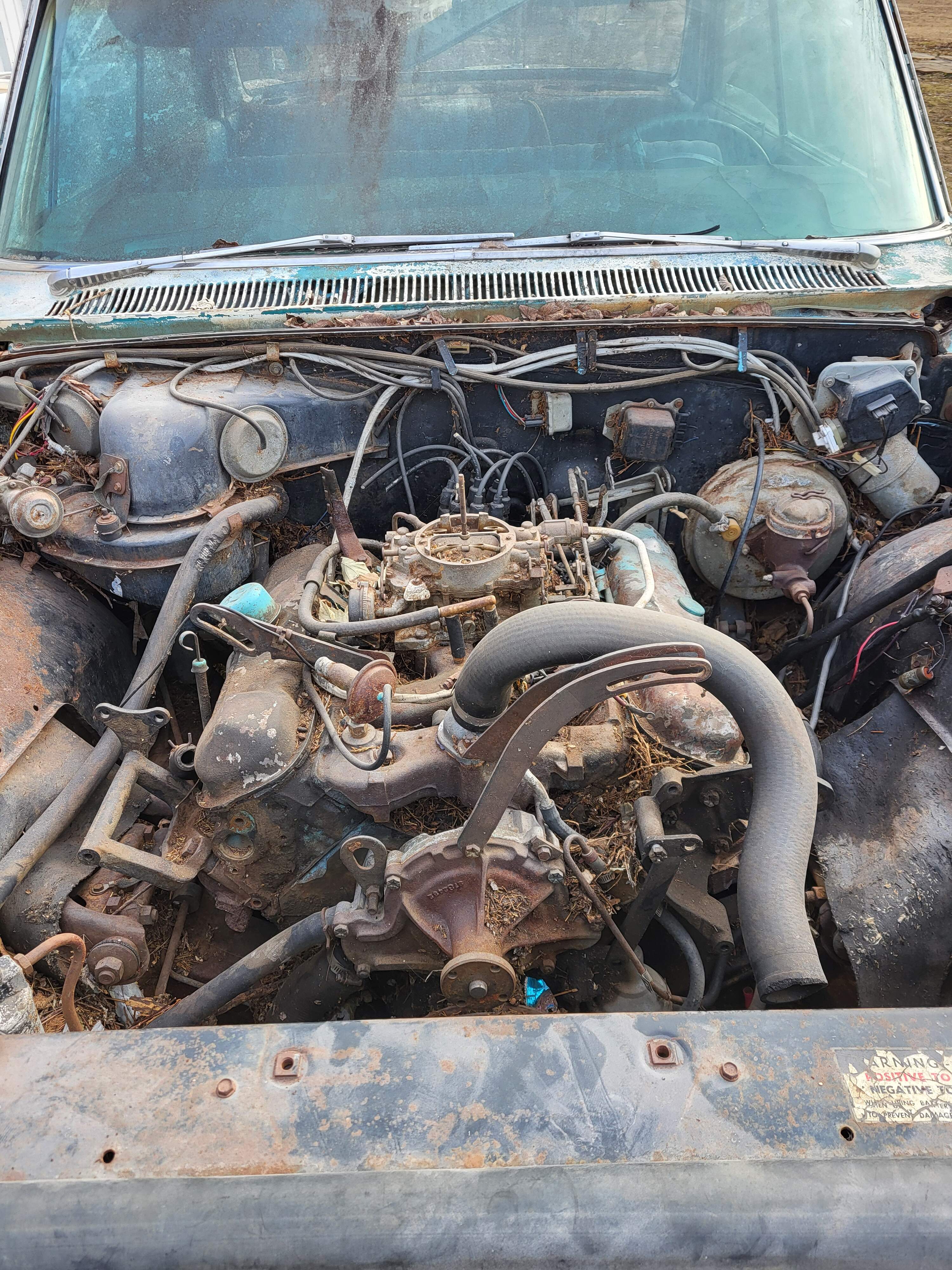

I got a wild hare and drug this rat infested pile home. It's a lot rougher than I had hoped, but I should be able to rob a few things. I mainly wanted the drivetrain. The engine does rotate. the engine in the 2 door took a lot of effort to get unstuck so I have concerns. Can anyone help with what the stamping on the front passenger side of the engine means? BTW, I would never take this many pictures of anything. I'm doing it for you...
The engine code is easy.
28P is a 303 HP 389 engine tied to an automatic transmission with air conditioning. Heads should be 9773345. Compression ratio is 10.5:1. Anything from a one to four barrel carb on it. It has a Pontiac 472 spec camshaft.
404256 should match the last six digits of your car’s VIN. If it matches, you have a numbers matching car. That means this engine is the original engine this car was born with.

Jason ! great score mate! to have a parts car is the way to go !!!:dancingpontiac:
i did the same and you will aprecate all the little clips and bolts and parts you can rob to make the coupe complete:cheers:
