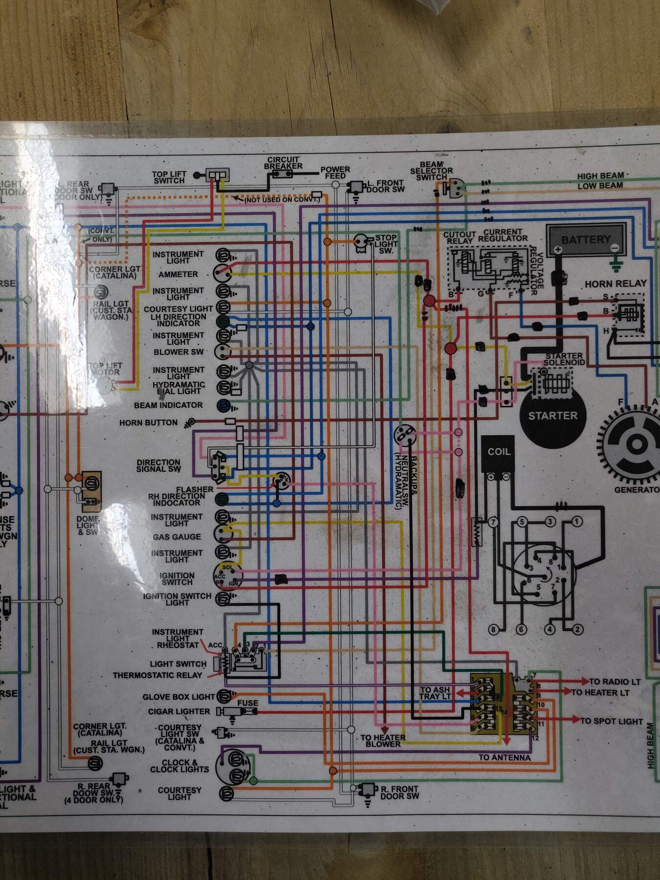

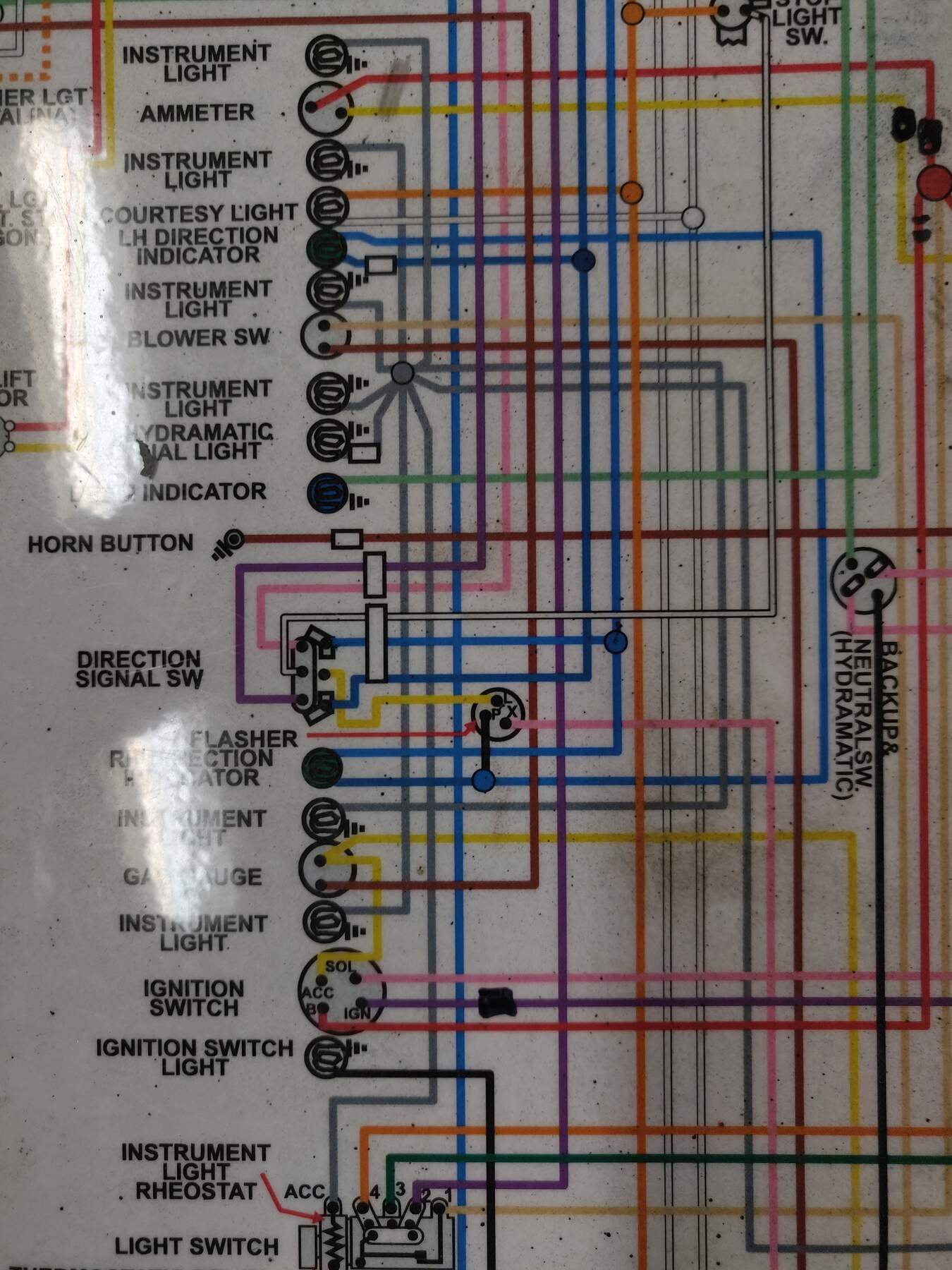

Both turn indicator lights have single wire sockets in them.  I have a new 3 prong flasher and can't figure out how the "P" terminal wired as in the diagram will light the appropriate bulb and not both at the same time.  Why have 2 bulbs if the both light at once?  I'm guessing that I also have the wrong sockets in there.  Should they be a two wire?
