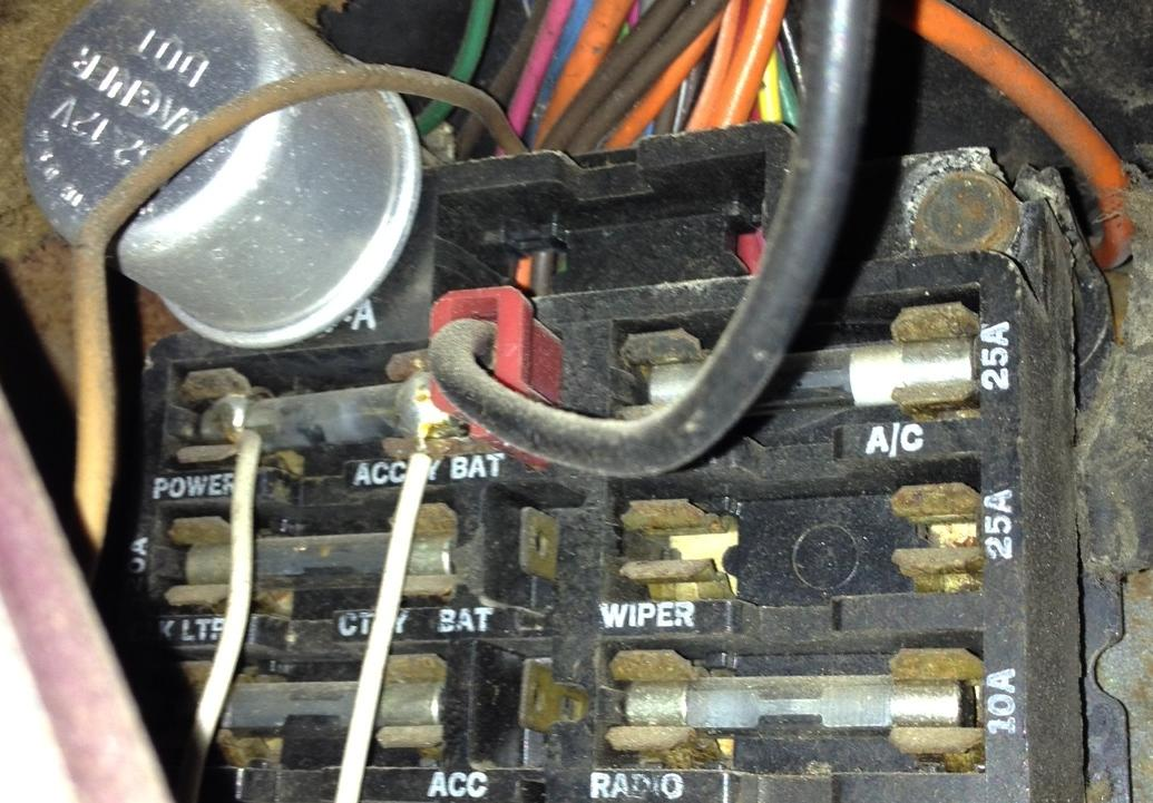

Also have you checked the Accessory fuse to make sure it is not blown and that the power lead to the switch/power top is plugged into the fuse block at the accessory outlet? Otherwise, the top certainly won't work.
Here is an example of the power lead going from the fuse block to the power convertible top switch (the red connector). You should also have a diagram in your owners manual.
I don't condone the white leads.
