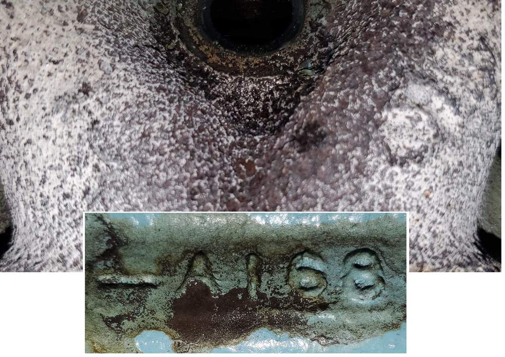

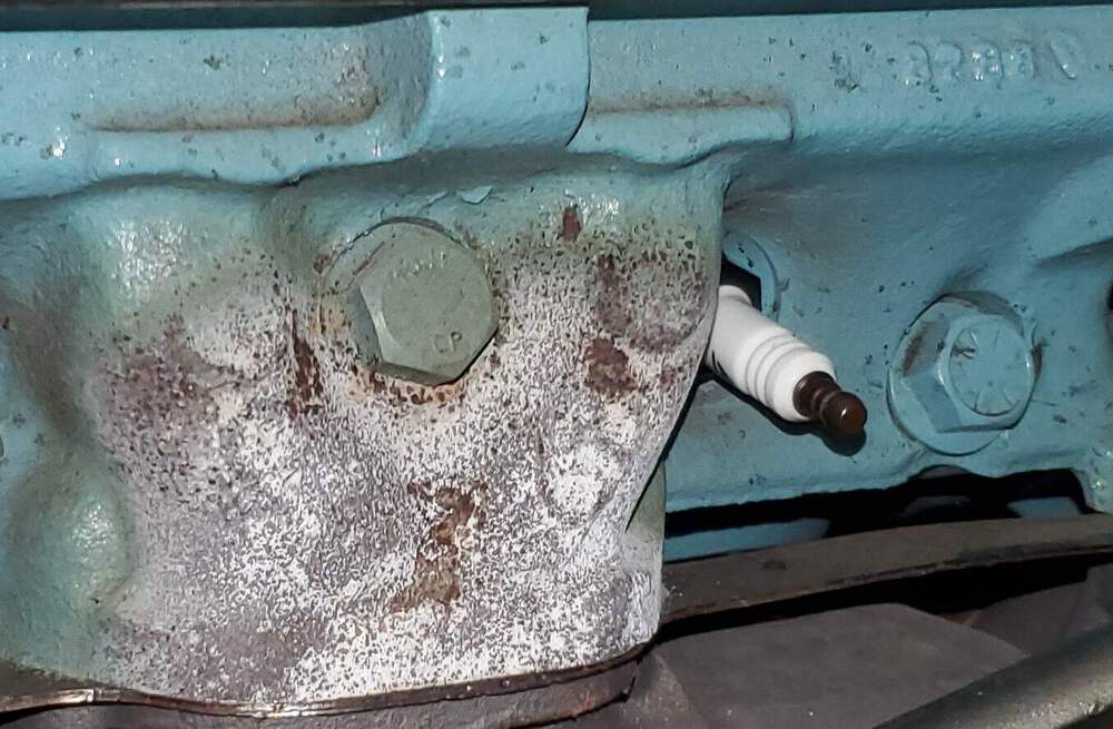

Ok I need some help with some heads I just pulled from my custom S. I thought they were the same but after looking at them and seeing the date codes and stamps... i am thinking they are very different.
Drivers side: Stamp - 16, Date - 8288
Passenger side: Stamp - 15, Date - A168
I looked up the codes and came up with this:
                      Year - Application - Casting - Valves - CC/CR - Notes
Drivers side: 68/69 - 400std/HO - 16 - 2.11/1.77 - 72 - Screw in studs, Dual valve springs, D port
Passenger side: 68 - 400 2bbl/4bbl - 15 - 1.96/1.66 - 75 - Pressed in studs, D port, B & G body
So either I am looking up these heads incorrectly... or I have very different valve  sizes .... would really love it if someone could help me clear this up. Cause Im thinking I need to get a matching head so that I have the same on both sides.

I agree with your analysis. The Stamp 8288 on the #16 head is probably B288 - which translates into Feb 28, 1968 cast date. The A168 is January 16, 1968. I think it highly unlike that your car was built this way. I suspect one of the heads was replaced at some point in time after it was built. Clearly the driver's side is the more desirable head. You can talk to a machine job about opening the passenger side up to the match the driver's side.
