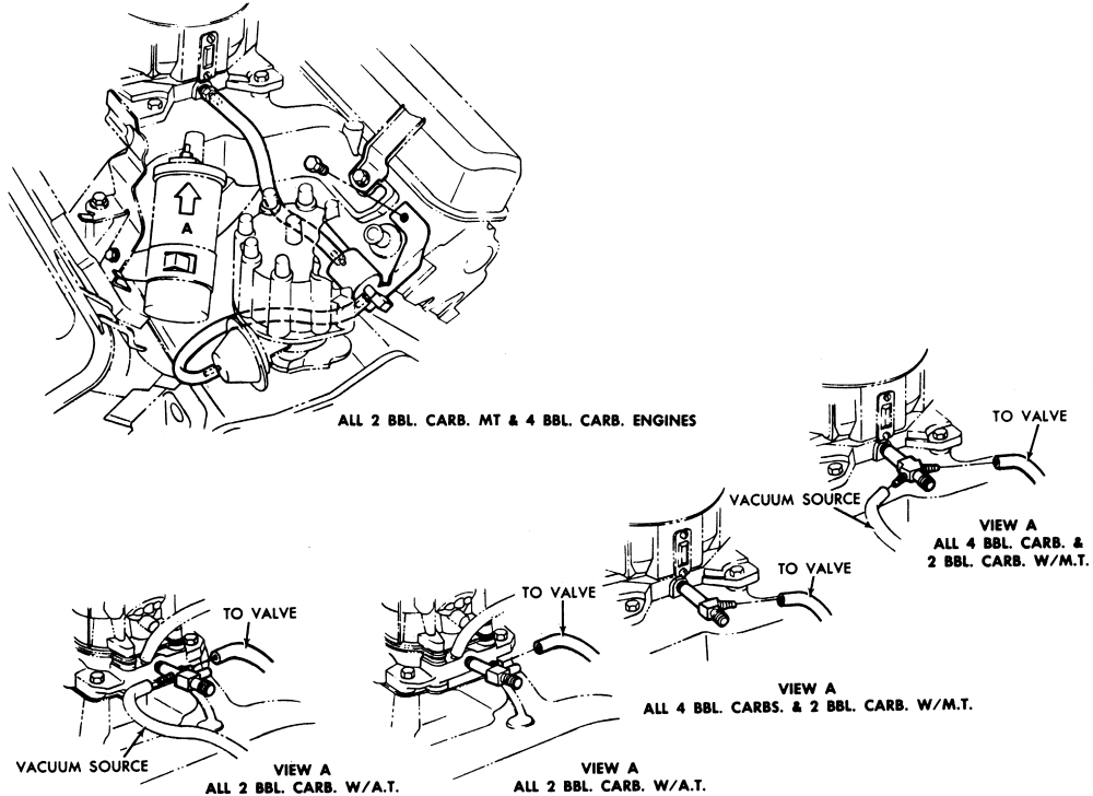

I think this is the diagram you're looking for Bob.
Thanks,
Its what I thought, vac source from carb to solenoid then from solenoid to advance on dizzy.

It means the advance won't get full vacuum to the advance until you are out of 1st and 2nd gear, or if the engine is below 63F or above 263F. The TCS was an early emissions device. You can completely remove it from the system if you want, assuming you are not going for judged points (100 point restoration) or your state does not require emissions testing/original emissions equipment to remain in place and functioning.
