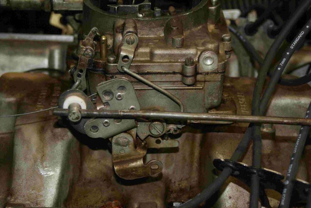

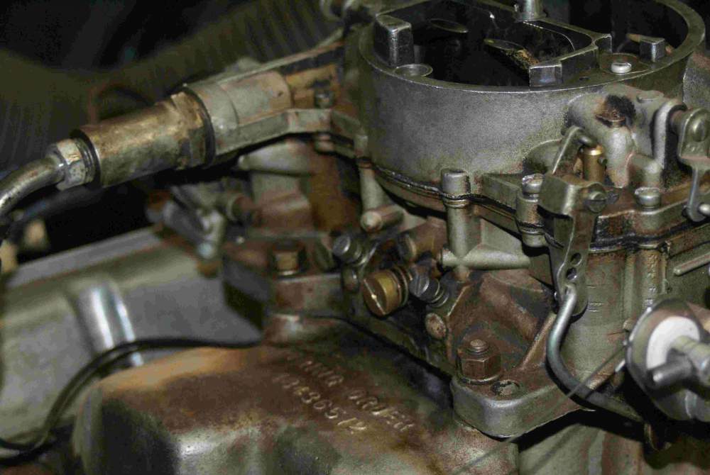

I have a Carter AFB carburetor with no identifying number.  The top casting is #6-1855 and the bottom casting is #0-1565.  The throttle shaft connection is obviously Pontiac but the top section has a fuel inlet on the right front.  I would like to get a Carter identifying number or a Pontiac application so I could rebuild it.  Can anybody help?

Hi Bernie - Welcome to FP. Carter and Pontiac had a 10-year run with Carter AFB carbs and lots of applications. Here is the list, as I know.  I hope this helps.
S/T = standard (manual) transmission
A/T = automatic transmission
S/D or SD = Super Duty
1957 8 347 57-27, 57-28 Carter AFB 2506
1958 8 370 V-8 Carter AFB 2768 572
1958 8 370 V-8 Carter AFB 2751 572
1958 8 370 Carter AFB 2767 563
1958 8 370 V-8 Carter AFB 2740
1959 8 389 S/T Carter AFB 2820 563
1959 8 389 S/T Carter AFB 3123 586
1959 8 389 A/T Carter AFB 2819
1960 8 389 A/T Carter AFB 2976 563
1960 8 389 S/T Carter AFB 2975 563
1960 8 389 S/T Carter AFB 3123 586
1960 8 389 S/T Carter AFB 3010
1961 4 195 S/T Tempest Carter AFB 3266 .
1961 8 389 S/T Carter AFB 3123 586
1961 8 389 A/T 23, 25 Carter AFB 3125 586
1961 8 389 A/T 26, 27, 28 Carter AFB 3124
1962 8 389 A/T (4 speed) Carter AFB 3300 586
1962 8 389 A/T (3 speed) Carter AFB 3326 586
1962 8 389 S/T Carter AFB 3123
1962 8 421 SD (Rear of 2) Carter AFB 3435 558
1962 8 421 SD (Front of 2) Carter AFB 3433 558
1962 8 421 S/D Carter AFB 3444 550
1962 8 421 S/D Carter AFB 3443 578
1962 8 421 S/D Carter AFB 3596 550
1962 8 421 SD Tempest Carter AFB 3266 828
1963 8 326 S/T Tempest Carter AFB 3477 586
1963 8 326 A/T Tempest Carter AFB 3502 586
1963 8 389 A/T (4 speed) Carter AFB 3300 586
1963 8 389 A/T (3 speed) Carter AFB 3326 586
1963 8 389 S/T 28 Carter AFB 3479 586
1963 8 421 A/T Carter AFB 3545 549
1963 8 421 SD (Front of 2) Carter AFB 3433 558
1963 8 421 SD (Rear of 2) Carter AFB 3435 558
1963 8 421 Carter AFB 3443 578
1963 8 421 S/T Carter AFB 3574 586
1963 8 421 Carter AFB 3444 550
1963 8 421 S/D Carter AFB 3596 550
1963 8 421 Super Duty (3 barrel) Carter AFB 3636 591
1964 8 326 A/T Tempest Carter AFB 3687 586
1964 8 326 S/T Tempest Carter AFB 3686 586
1964 8 389 S/T Carter AFB 3647 586
1964 8 389 A/T GTO Carter AFB 3649 586
1964 8 389 A/T Carter AFB 3648 586
1964 8 421 A/T Carter AFB 3651 549
1964 8 421 S/T Carter AFB 3650 586
1965 8 326 S/T Tempest Carter AFB 3899 586
1965 8 326 A/T Tempest Carter AFB 3900 586
1965 8 389 A/T Carter AFB 3896 548
1965 8 389 S/T Carter AFB 3895 549
1965 8 421 S/T Carter AFB 3895 549
1965 8 421 A/T Carter AFB 3898 548
1966 8 326 A/T Tempest Carter AFB 4036 583
1966 8 326 A/T CA Carter AFB 4031 583
1966 8 326 S/T Tempest Carter AFB 4035 586
1966 8 389 S/T Carter AFB 4033 586
1966 8 389 A/T Carter AFB 4034 584
1966 8 389 A/T CA Carter AFB 4030 584
1966 8 389 S/T CA Carter AFB 4041 586
1966 8 421 S/T CA Carter AFB 4041 586
1966 8 421 A/T Carter AFB 4037 584
1967 8 326 S/T (CA) Carter AFB 4245 890
1967 8 326 S/T Carter AFB 4243 2205
1967 8 326 A/T (Tempest) Carter AFB 4246 870
1967 8 326 A/T (Tempest)(CA) Carter AFB 4248 891
1967 8 400 S/T (CA) Carter AFB 4245 890
1967 8 400 A/T (CA) Carter AFB 4244 891
1967 8 400 S/T Carter AFB 4243 2205
1967 8 400 A/T Carter AFB 4242 867
1967 8 400 A/T Carter AFB 4413 870
