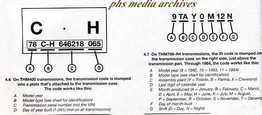

The model year of the transmission is stamped onto the transmission tail housing of most TH350/TH400s on the left or right side. The tag should look something like this:
