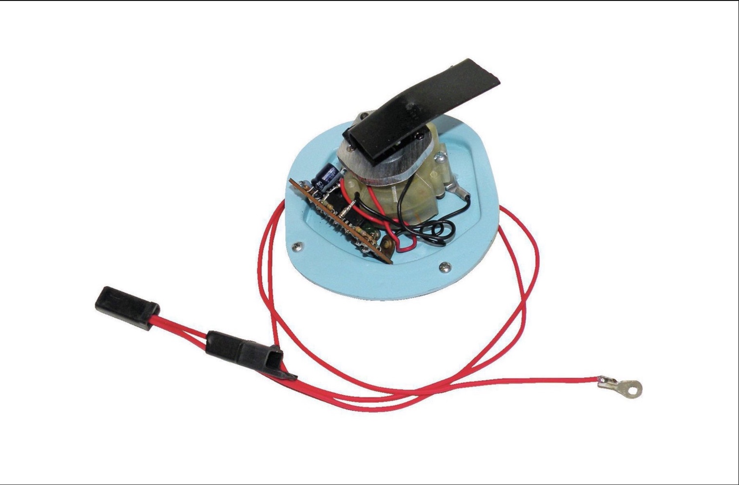

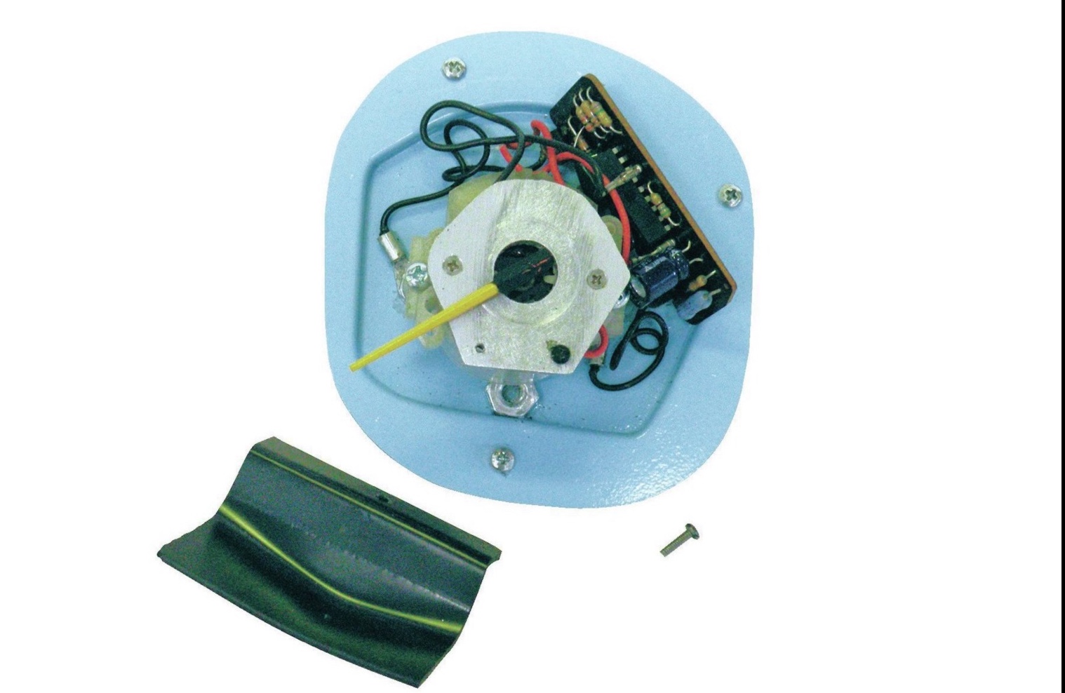

my tach is dead and I read in a very interesting article from "hot rod" site, that Jim McGowan repair his tach with a new movement, very convenient solution for me, since I don't have to worry about diameter! he says that it's very easy to find on online stores this product, but to be honnest, after several hours of research, I've not found nothing;
so can anyone tell me where I can buy this bit??
thanks for your help

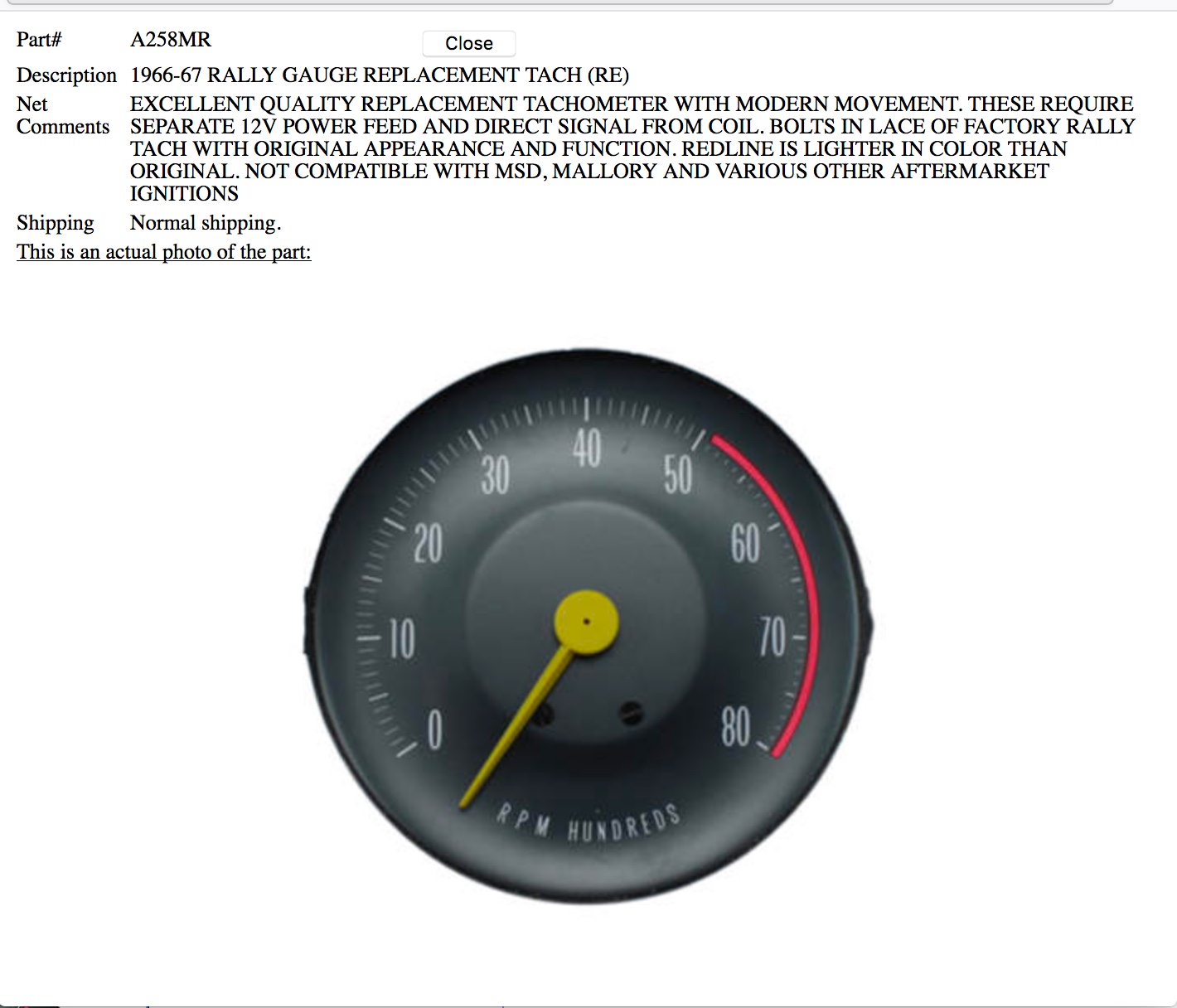

I found this at fair price, but apparently not compatible with my HEI distributor;
so what can I fit for replacement ?
if you have a link, I'll be happy!...
