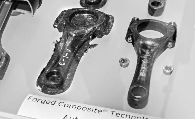

Lamborghini ACSL Detail - forged-composite connecting rods before and after trimming
Lamborghini is attempting to replace forged-steel parts with significantly lighter forged-composite ones, such as the connecting rods shown here before and after trimming and machining.

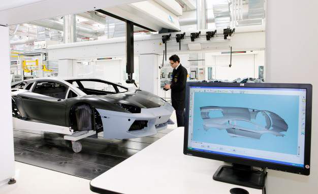

Feraboli left UW in 2013 to establish Lamborghini’s Advanced Composites Structural Laboratory (ACSL) in Seattle’s Interbay district. This 8000-square-foot facility, currently staffed with five employees, liaises with a 60-person Advanced Composites Research Center at Lamborghini’s Sant’Agata Bolognese, Italy, home base. ACSL also advances the carbon-fiber cause by performing tests for various aircraft and sports-equipment manufacturers, by conducting one-to-five-day training sessions, and by housing a scale-model Lamborghini museum.

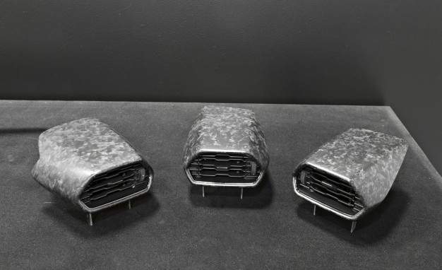

Lamborghini ACSL Detail - interior air vents for Lamborghini Huracan
Lamborghini currently offers a forged-composite interior-trim package for the HuracĂĄn, including air vents like these.
Maurizio Reggiani, Lamborghini board member responsible for R&D, calls FC tech the company’s “workhorse” that eventually will serve many structural, body-panel, and cosmetic-trim needs. One issue he faces is marketing a different aesthetic—what looks more like marble or burl wood versus the traditional black woven fabric—to his supercar constituents. To encourage acceptance, FC parts already are infiltrating production models. The first semi-structural component is a painted, removable roof panel for the Aventador convertible. FC engine bay trim is available as a $7000 option on the Huracán. An interior package consisting of four air vents, sill plates, door pulls, and center-console trim with the FC look under a gloss clear coat soon will be offered.
The forged part of the FC name comes from the goal of replacing metal forgings in cars. While FC suspension control arms and wheels are risky because it’s difficult to tell when they need to be replaced due to pothole or curb-strike injury, the ACSL has FC engine connecting rods in its showcase that may be closer to fruition. The most promising candidate delivers a 39-percent weight savings over a forged-steel design for that part.
