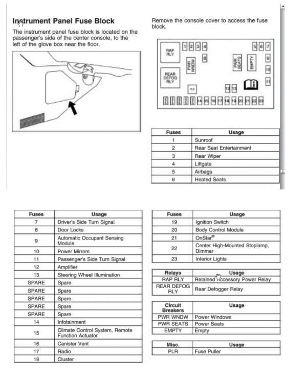

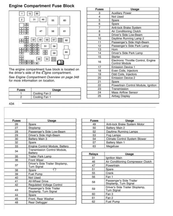

Can anyone tell me which fuse controls the license plate lights on an 07 Torrent. The rest of the lights seem to work fine. The bulbs were burnt out. I replaced them with new LED bulbs. No dice.
Thanks.
J
Here is the diagrams to both of your fuse boxes. :dancingpontiac:
