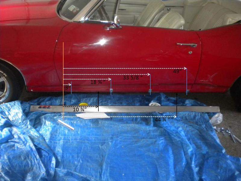

So I did some research on the subject and think I know exactly what has to be done; I just need some confirmation about that. I found diagrams on other forums that showed placement and had explanation; the first one here appears to show the placement of all four clips, at each blue line point.

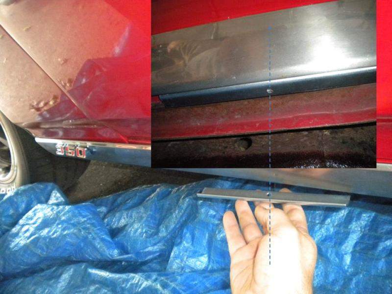

Then there were these long clips, this image shows placement on the trim but I can't tell where exactly on the car they go. There are only four; two for each side, and so I would assume one clip goes on the rocker under the front fender, where the 350 badge is, and the other, on the rocker under the rear quarter;

Hoping that what I have said and shown makes sense; I would imagine the four small clips go on first, and then the two long ones.
