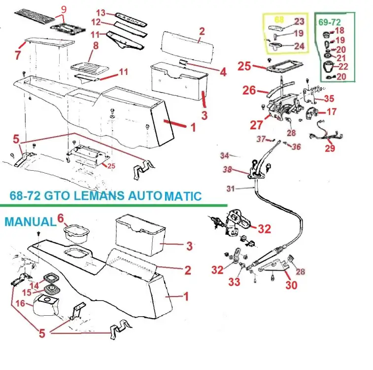

have a 70 lemans sport with a amp under the seat that's now hooked up right and need to remove the console to get to wires, how does it come up? was looking at the wood trim on top thinking to pry it off maybe the bolts are under it but don't want to break anything trying
I am assuming you have an automatic transmission, If so you have to remove the armrest door (2) , remove the storage Bin (3) to get at the rear screws. You also have to remove the Shifter knob (not pictured) pop off both the cover plates ( 7 & 8 ) to get at the front and center mounting hardware.

thanks guys that was a great help!
