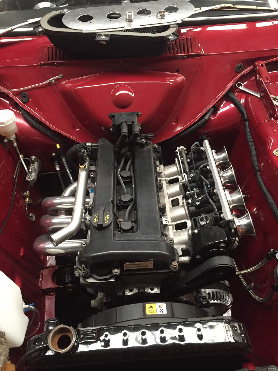

This is my mk1 that i have just finished.
basically i have copied what the rally boys in the uk are doing these days
i have used a 2 litre duratec east west engine with custom sump, bell housing to a type 9 5 speed box, back to a borg warner lsd 4.11 diff
induction is jenvey itb with a megasquirt ecu that i built.
all the front suspension is mk2 escort rack and pinion custom struts with capri vented discs and wilwood calipers
interior is custom  with stock gauge housing using all Dakota digital gauges and control system.
paint needs a touch up, and its ready to be dyno tuned, am expecting to be between 150 and 170 bhp @ the rear wheels 😊👍
