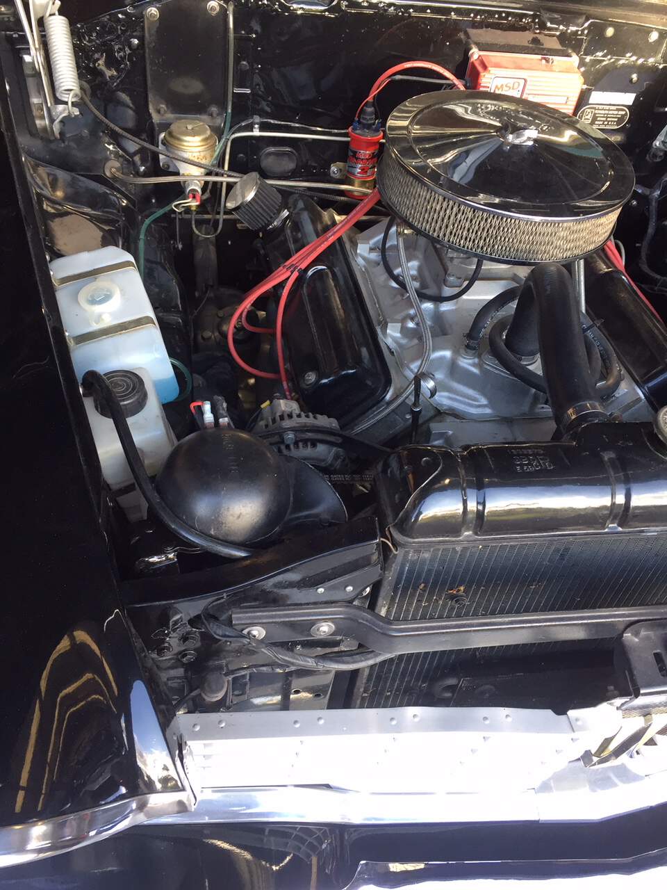

While waiting for epoxy to set on the bonnies steering wheel,  i had a fix to do on the 59, she had a fatigue crack where the horns mount on the radiator support panel ! the bloody thing has a lumpy cam and at idle the whole front end shakes like shit and the twin horns must weigh 10kgs :o and the mount is poorly designed.
 So i added a new bracket to spread the load and mig the crack in the rad panel, black paint and job done.:cheers:
