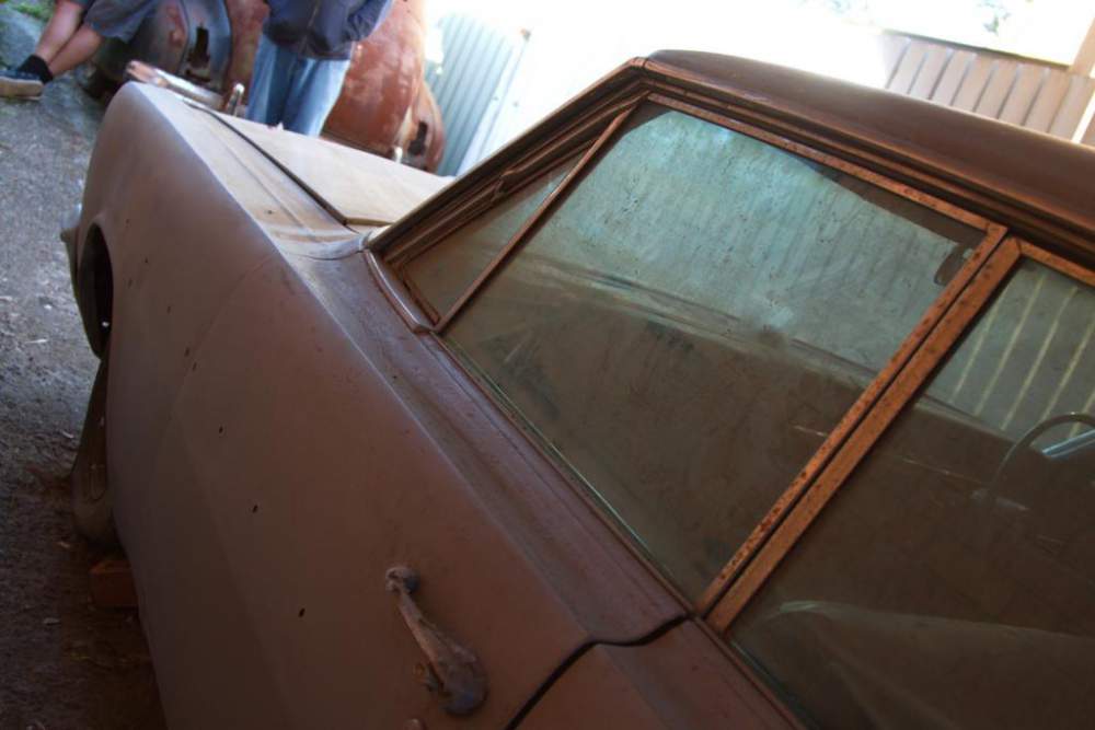

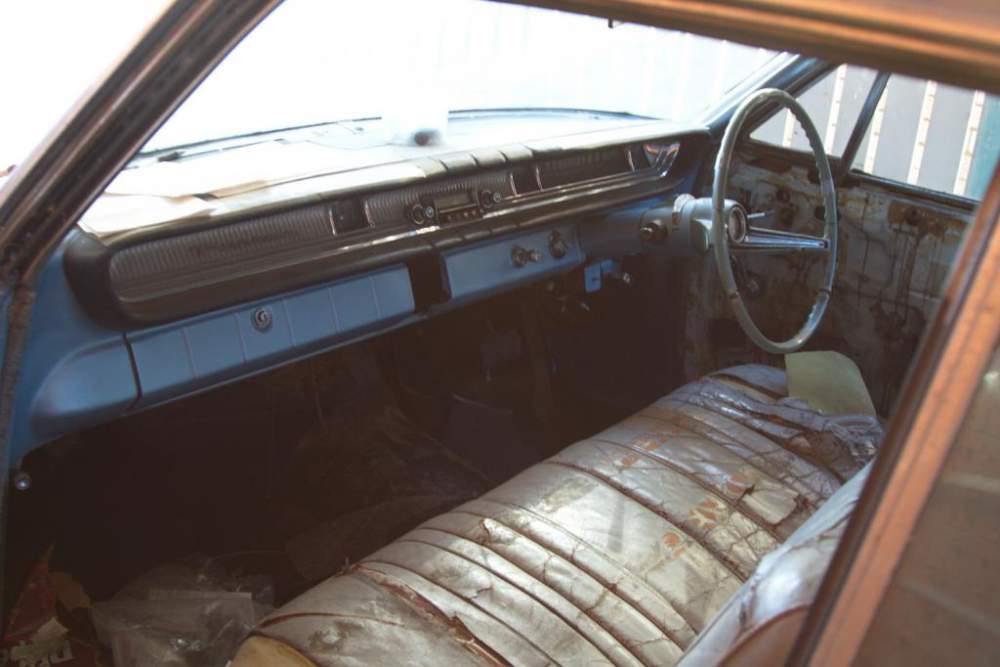

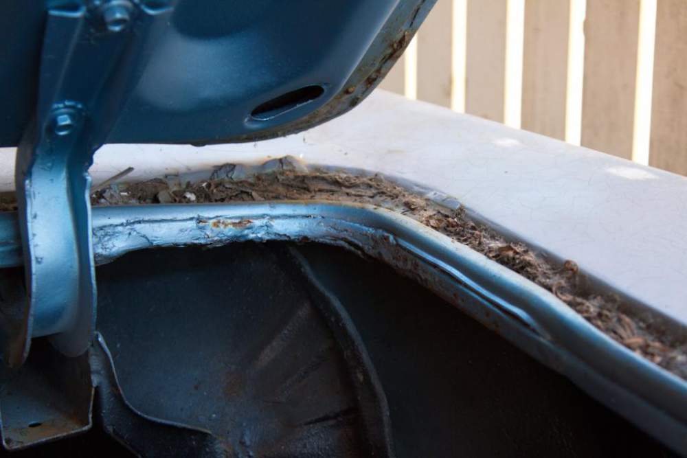

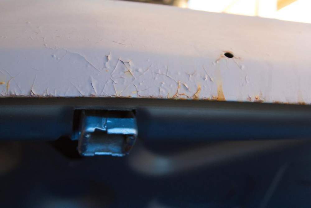

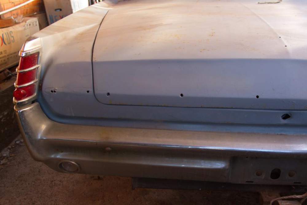

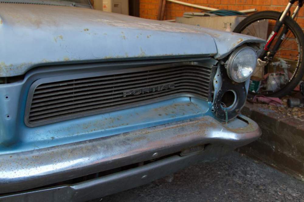

Hi all, here's some photos of my car in its current condition

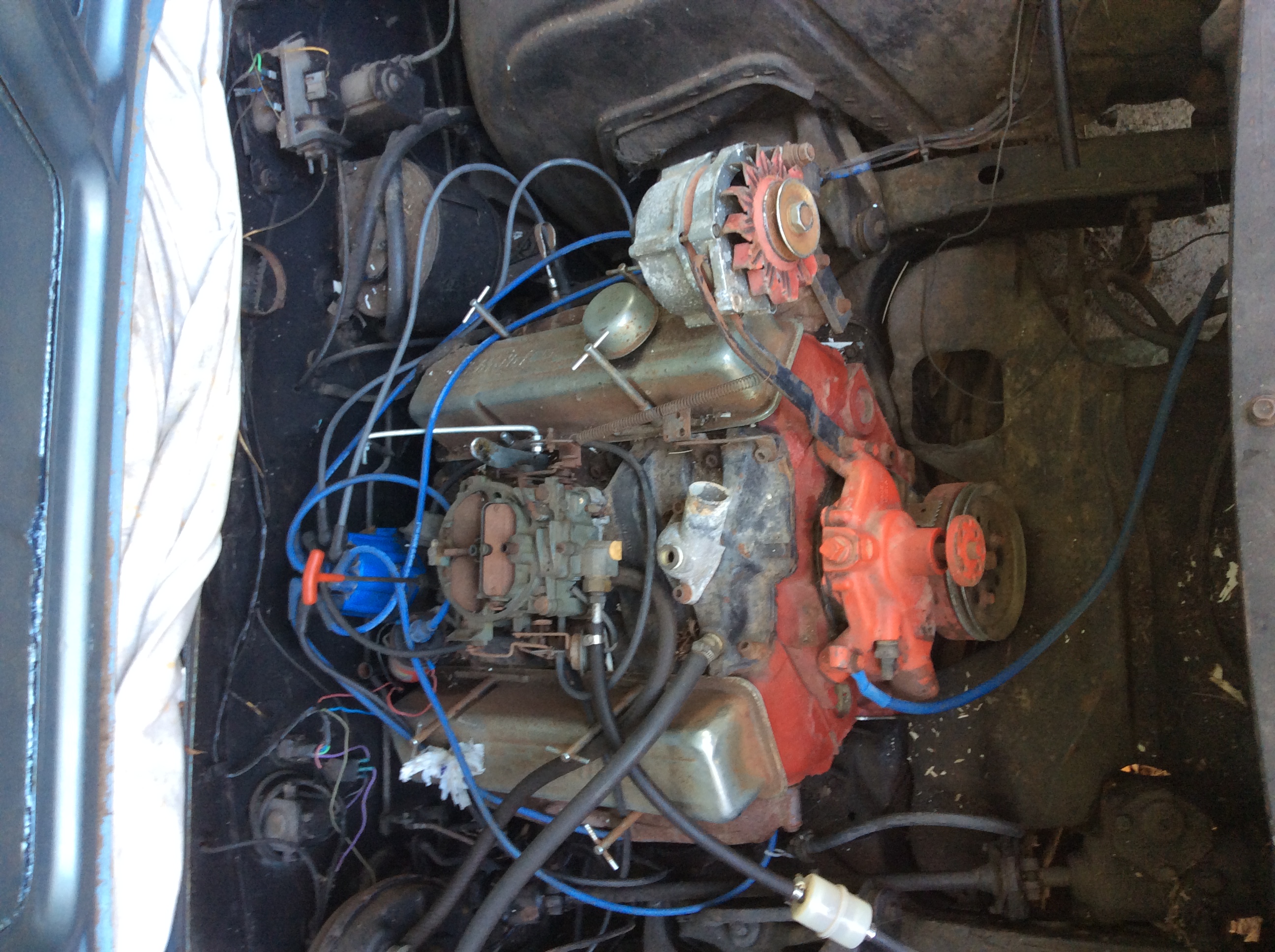

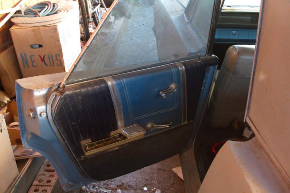

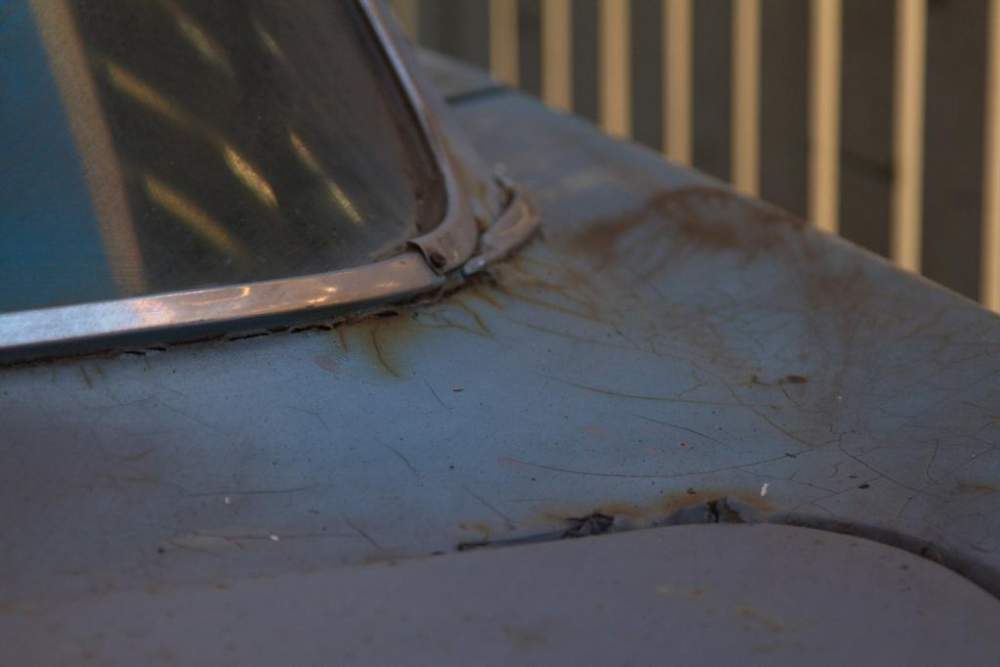

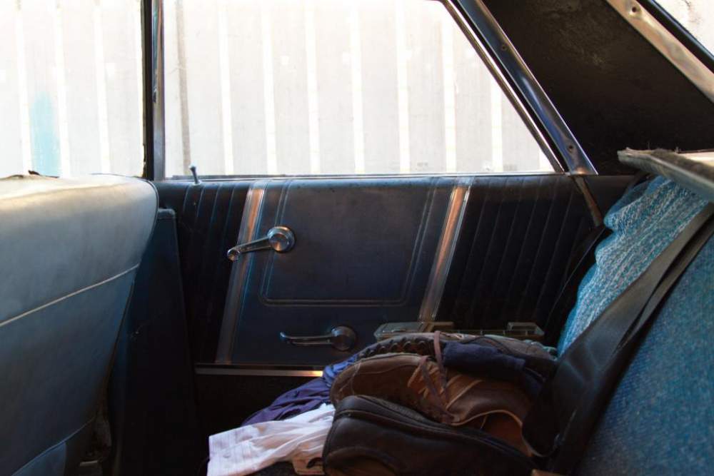

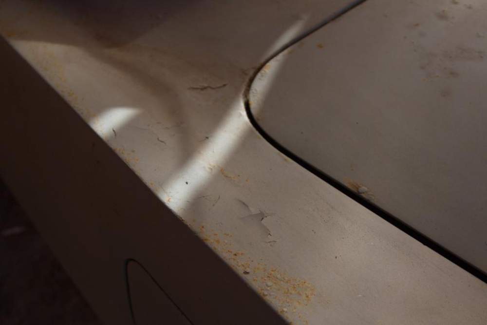

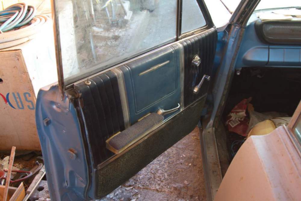

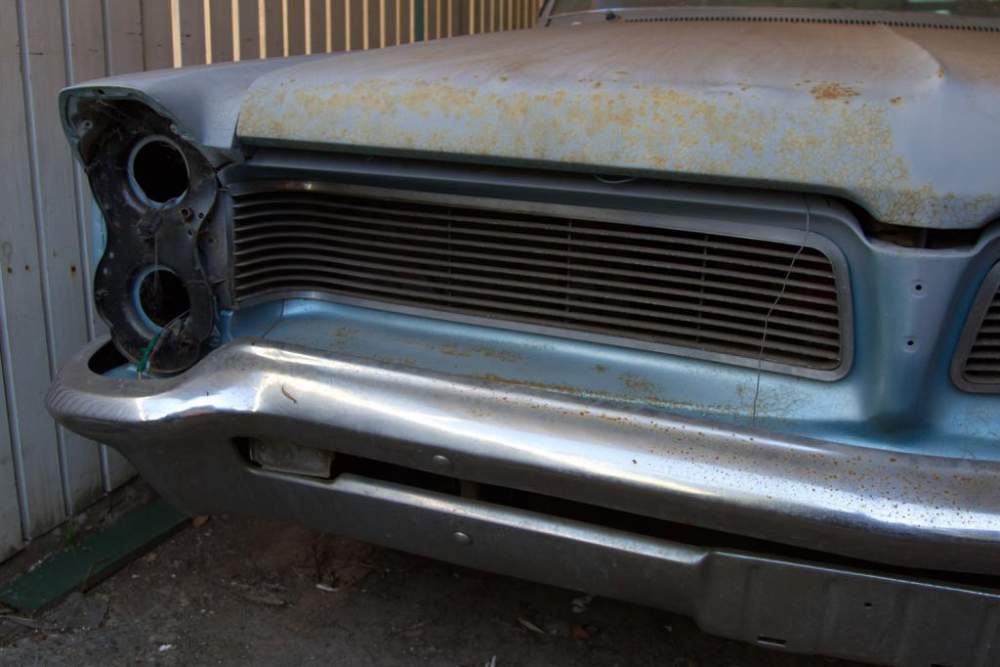

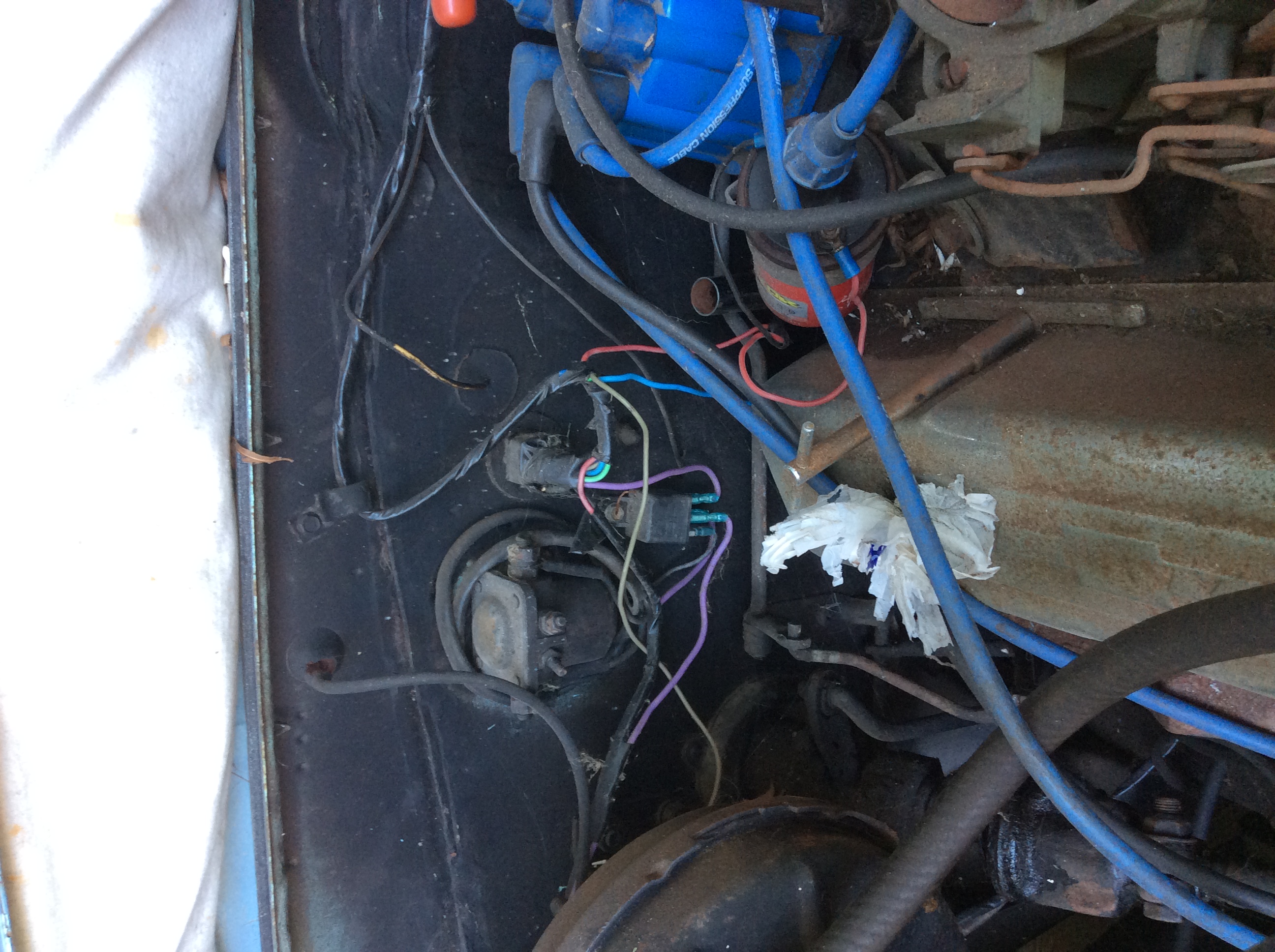

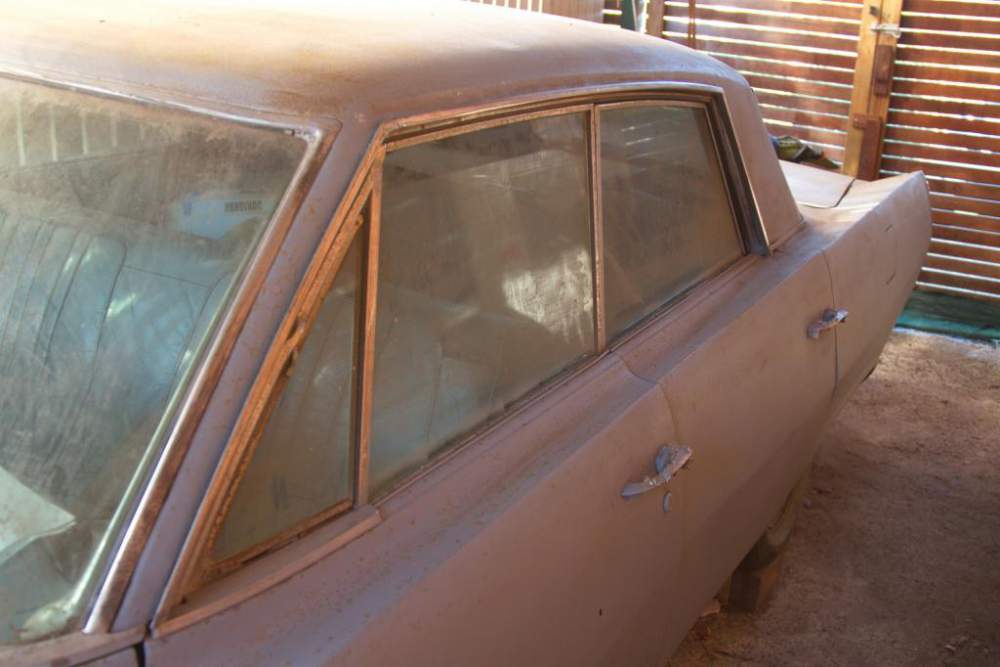

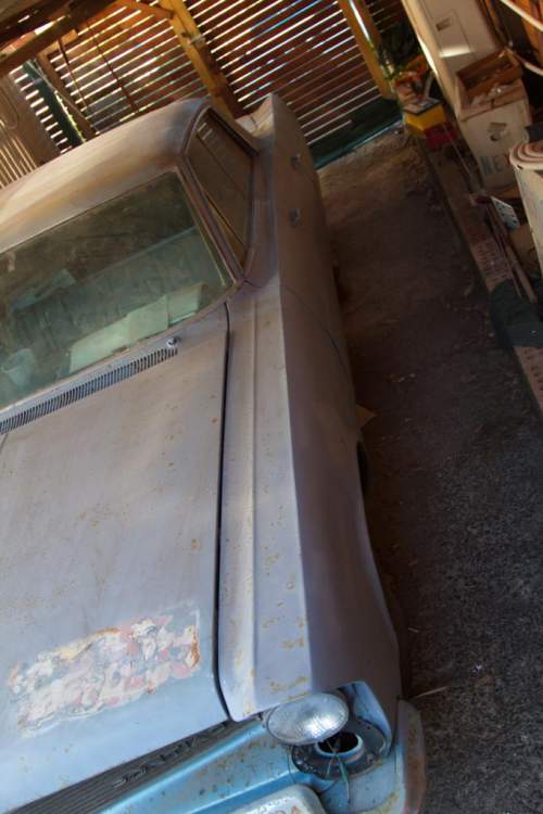

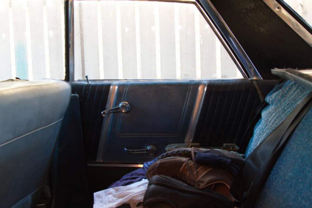

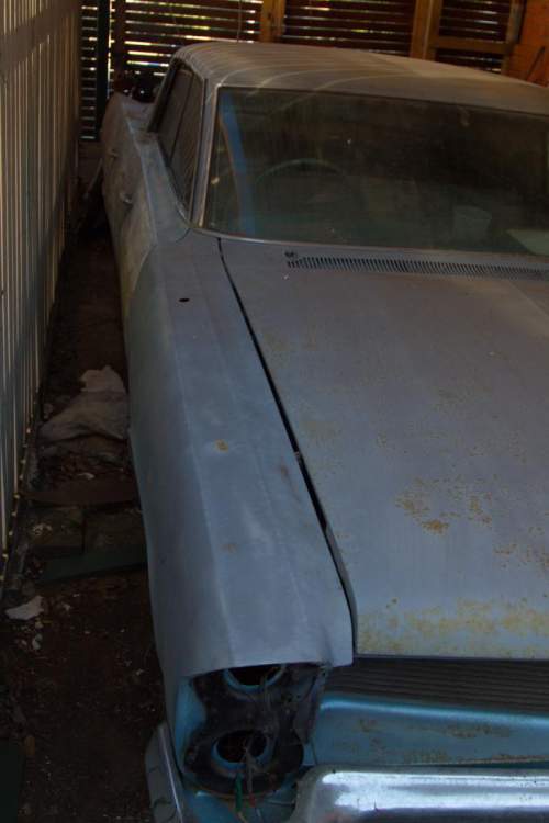

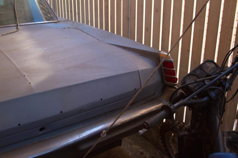

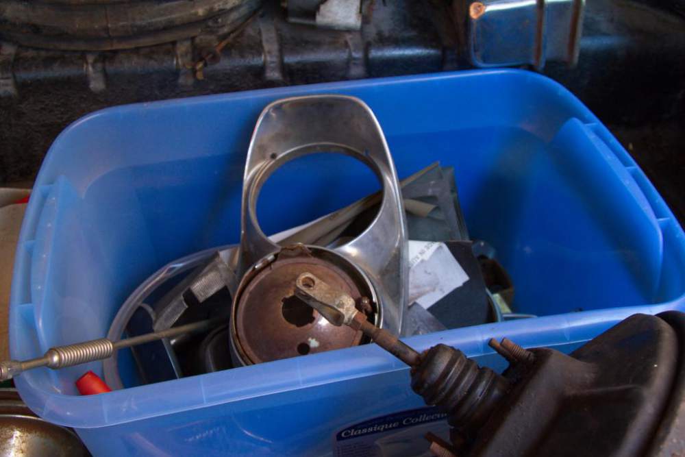

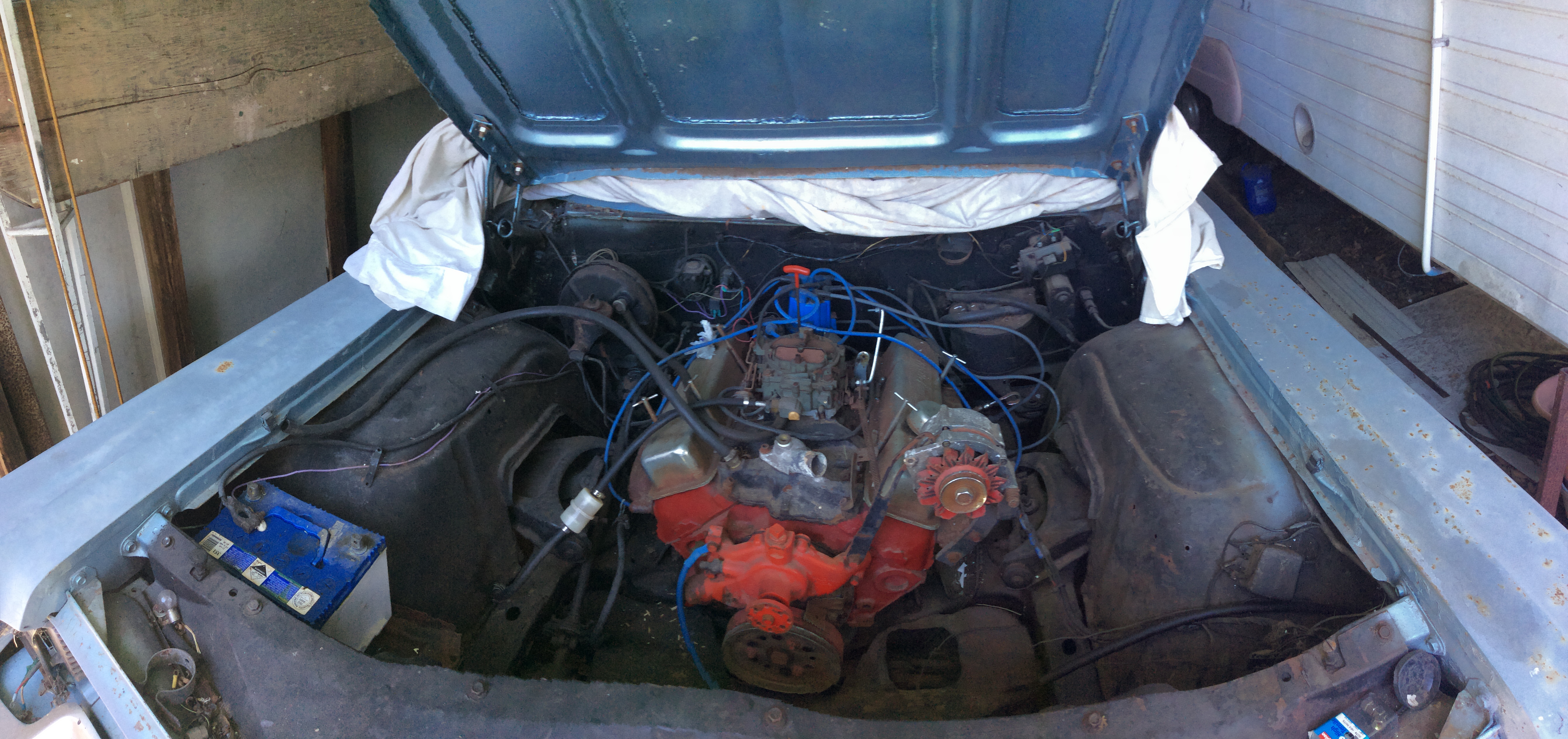

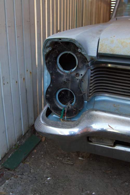

Hi guys, see some more pics
IMG_5634.thumb.JPG.affdc4e2eed2e69607140
Sorry for the orientation of some of the pictures.

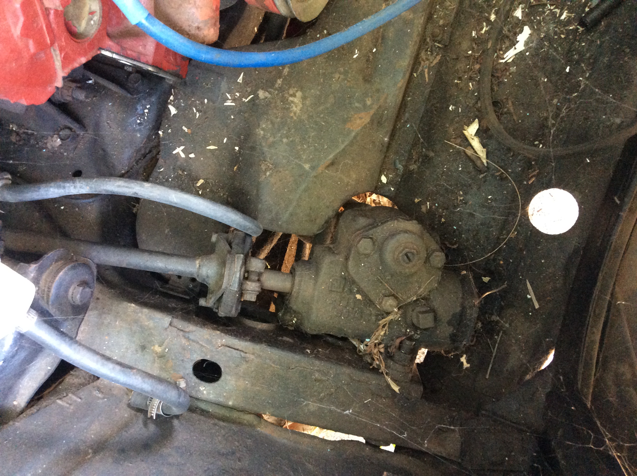

Also I have been told the engine is a 307cu. It's not the original engine
Thanks for sharing.
You definitely have a small block Chevy V8 engine. So parts should be rather plentiful. You have power brakes but a single master cylinder. I can tell from you brake booster. I am not certain that you car was equipped with power steering. If not, then you will have to replace the the steering rack with a power unit one, order hoses, a pump, and a bracket for the engine since I don't see any power steering pump bracket on you motor unless it's in the trunk.

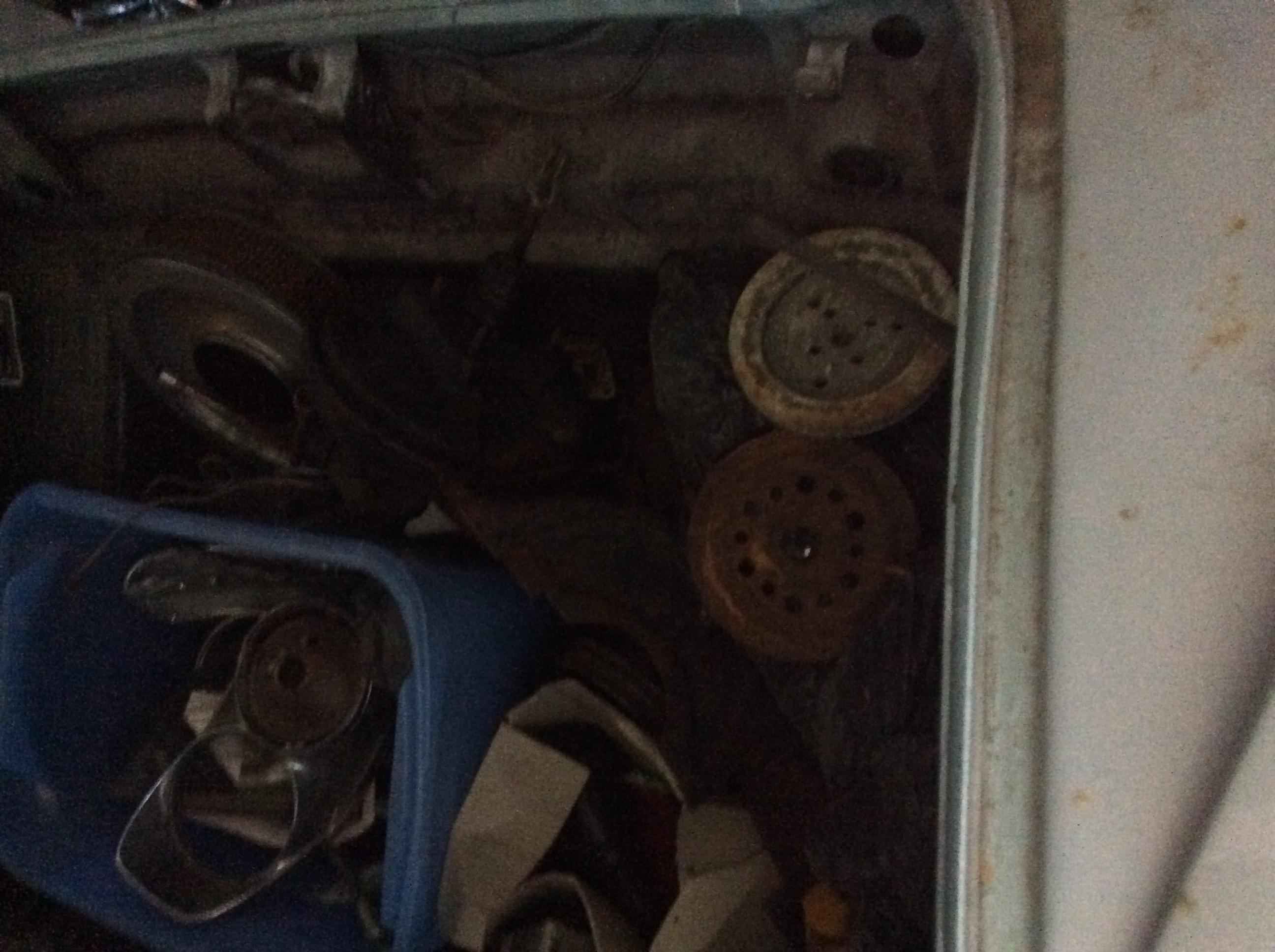

I think I have a power steering pump... There is a lot of stuff in the trunk (boot for us Aussies)
I will try to get a photo of it in the next couple of days.... thanks!
I'm going to try to wheel it out into the sunlight and get some decent photos of it next week... then we will really know what we're dealing with!
