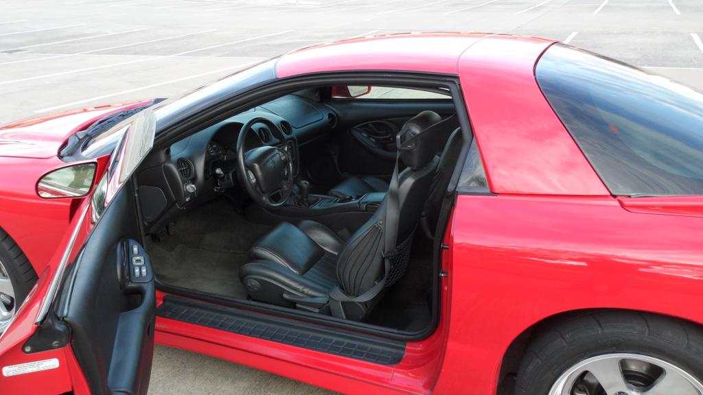

Originally a tan interior auto car but did a six speed swap along with a full ebony interior conversion. I never liked the tan interior it had from the factory. The auto was fun when it had a big converter but I wanted to try a six speed in it when it decided it didn't enjoy being behind a heads and cam set up.
The ebony interior conversion was a giant pain, it took two ebony dash swap attempts to get it right. The first ebony dash broke trying to get it in, the second time I had help and managed not to break the dash shell. If you ever decide you want to swap interior colors, I suggest you don't. But while the dash was out I got to replace all the a/c stuff and remove a junky old alarm. So it wasn't all for not I guess.

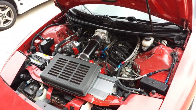

Current junky ol 23* LT1 set up

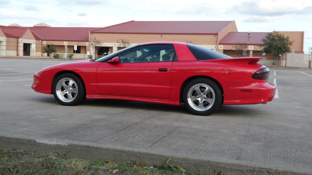

Thanks, the wheels are Fikse Mags 17x9 in the front 17x11 in the rear. The car runs off an efi connection 24x set up, so it has a 24 count reluctor wheel on the crank and the opti was replaced by a ls1 cam position sensor in a custom housing from efi connection. That allows me to run ls2 coil packs and a ls1 based PCM.
Thanks. The wheels make the top ten list for me for future endevours. Buddies of mine are working with the LT1 and are looking for solutions for the opti spark and that may fit the bill.
Nice 4th gen 'Bird. Welcome to FP.
Welcome, nice TA and nice color! :)
