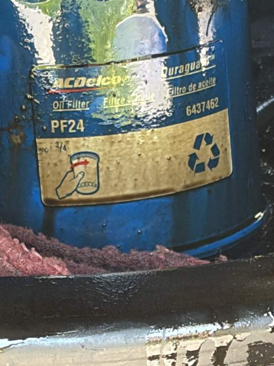

What I took off.
Nothing wrong with a PF24, so long as you can find another one. A PF30 will work in a pinch. Stick with the PF24 if you can get them.
